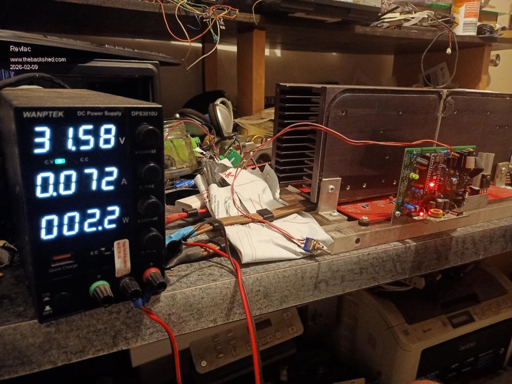

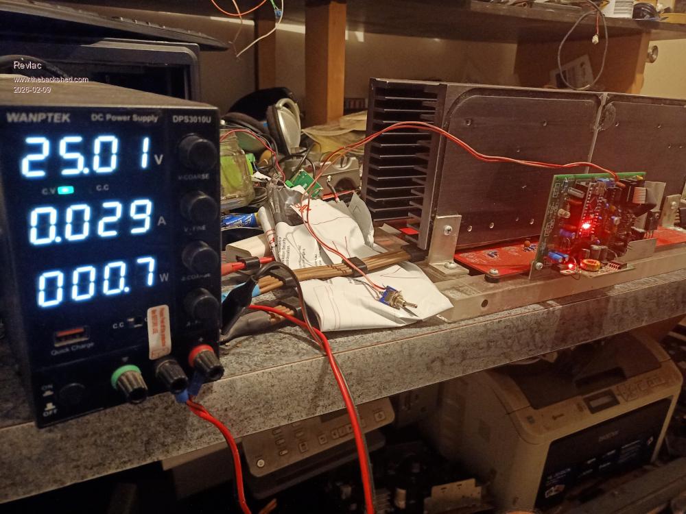

Just thought I could power up this control board with the Mad power board as a comparison...not the same as yours but might be a little help.
this is without the LCD or Toroid and no capacitors connected, 1 Fet per Leg (for testing) and was originally set for 48v, powered to 25v ans used 0.029, on or off was the same as under voltage was enabled.
Tried powering up quickly to 31.5v and the green power light come on, obviously used a little more power (0.072a) before under voltage lockout and then the green power light went out.
Your power consumption may be similar or higher.
I will try to dig a little deeper to see were the problem short might be.

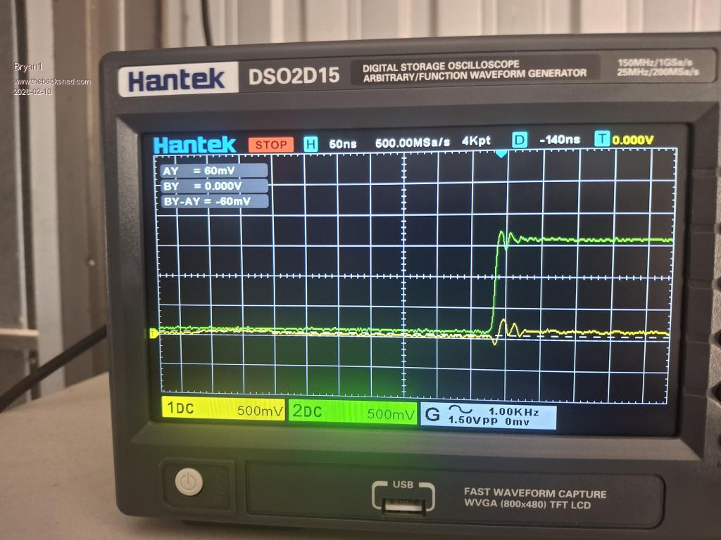

Ok setup my scope and I traced the pin position on blank pcbs.
So channel 1 is VS2 high side
Channel 2 is VS2 low side
Now don't call me a scope expert but can take some time to get the screen set.
Now I thought I was heavy handed in making the 10 pin cable as my ribbon thread is close to 20 years old and my method of using my jewelers vise to close the connection so I made another one and closed it gently and tried that but still no go.
Now as I do have the scope setup any suggestions for other pins to trace would be welcome
Edited 2026-02-10 12:24 by Bryan1

I am just going by files in my archive and the testing direction from the EGs002 document. Experts here, please review my instructions.
For stand alone testing, I think you temporarily connect VS1 and VS2 to GND. Scope Channel 1 and Channel 2 to DC, not AC.
First scope capture: probe 1 to LO1, probe 2 to LO2. Set scope H to capture 1 to 3 cycles of 50Hz.
Second scope capture: probe 1 to HO1, probe 2 to HO2. Set scope H to capture 1 to 3 cycles of 20KHz.
Edited 2026-02-10 12:49 by tinyt

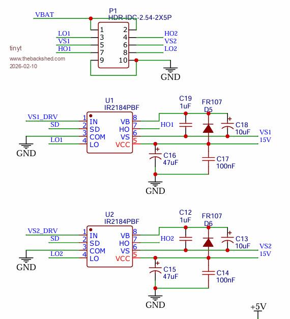

Looking again at the partial schematic, check that the orientation of the two diodes are correct on the PCB, also the electrolytic capacitors. Also U1 and U2 if they are socketed. Maybe there is no need for the scope captures.

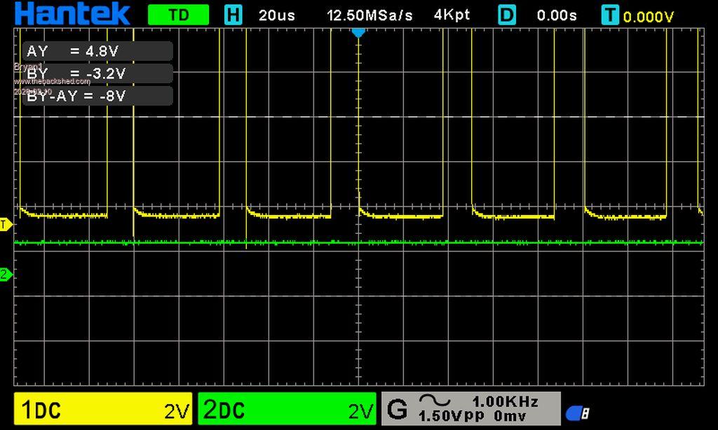

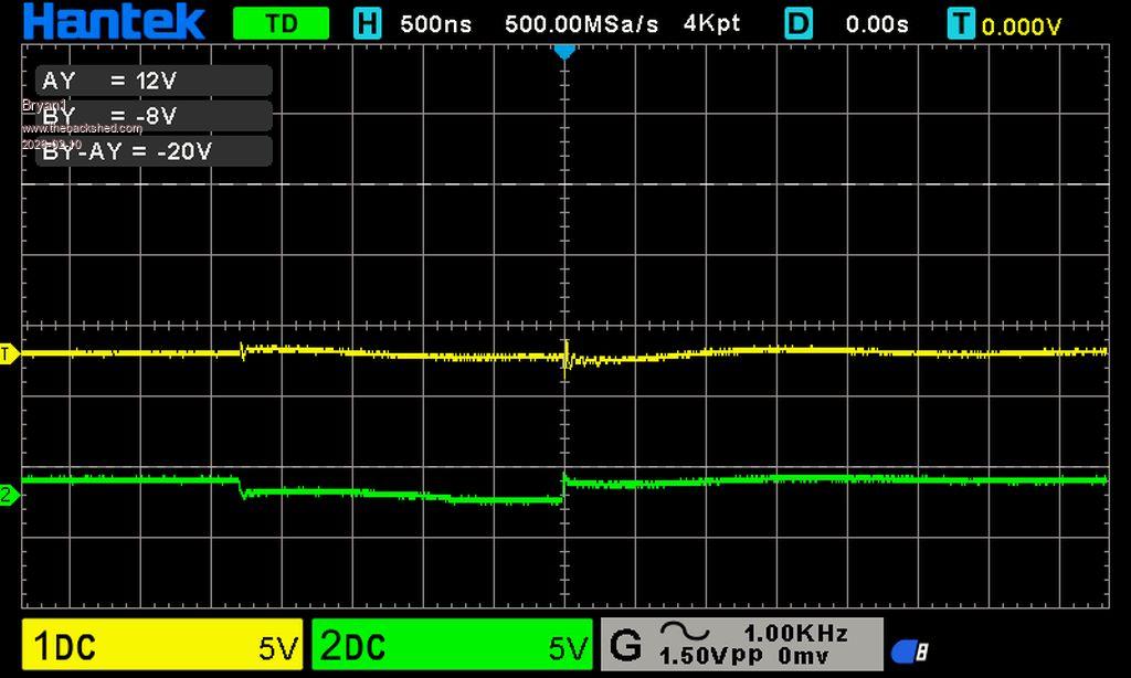

Ok got the first test done and found probe 1 L01 had a good wave form where probe 2 L02 was only in the millivolt range.
So changed over to the 2nd test and after connection the probes to the wires saw the VBat drop to 10 volts so I think we found the problem as both probe waveforms were flat. Now taking the ground off restored VBat.
So I'm goingto take out the brain board and have a good look as I do think that is where the problem is.

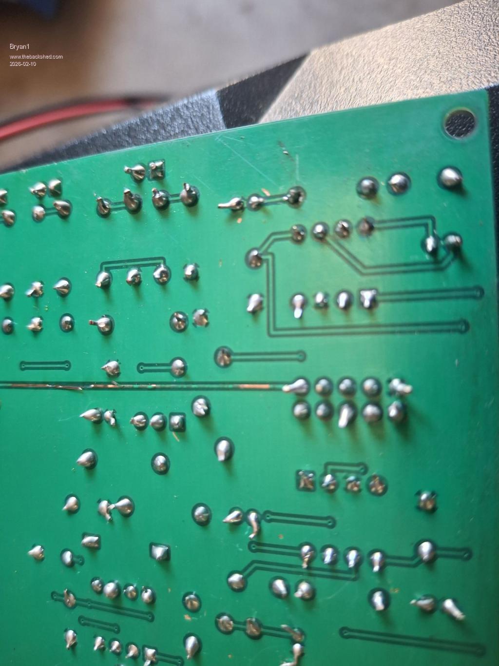

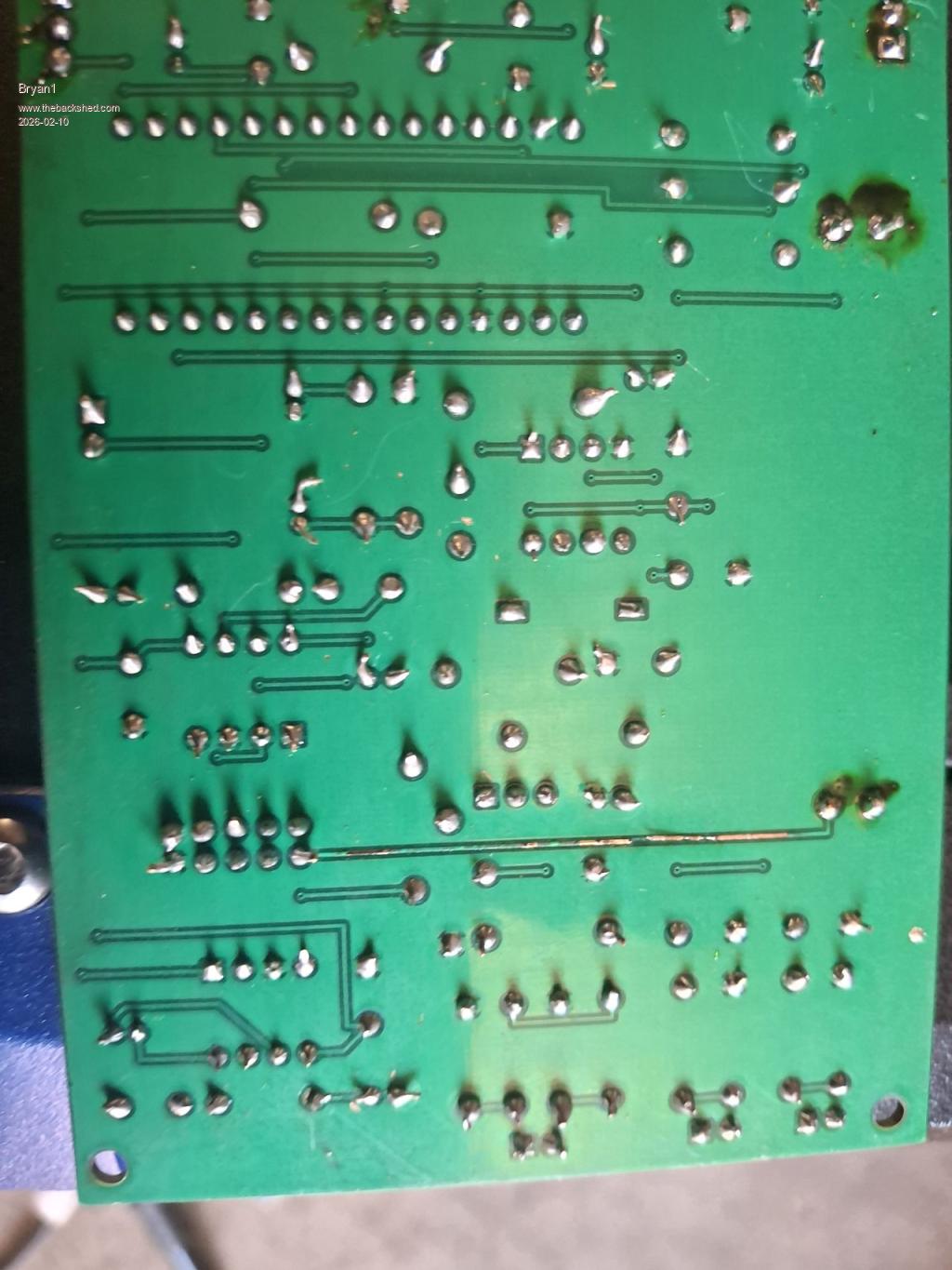

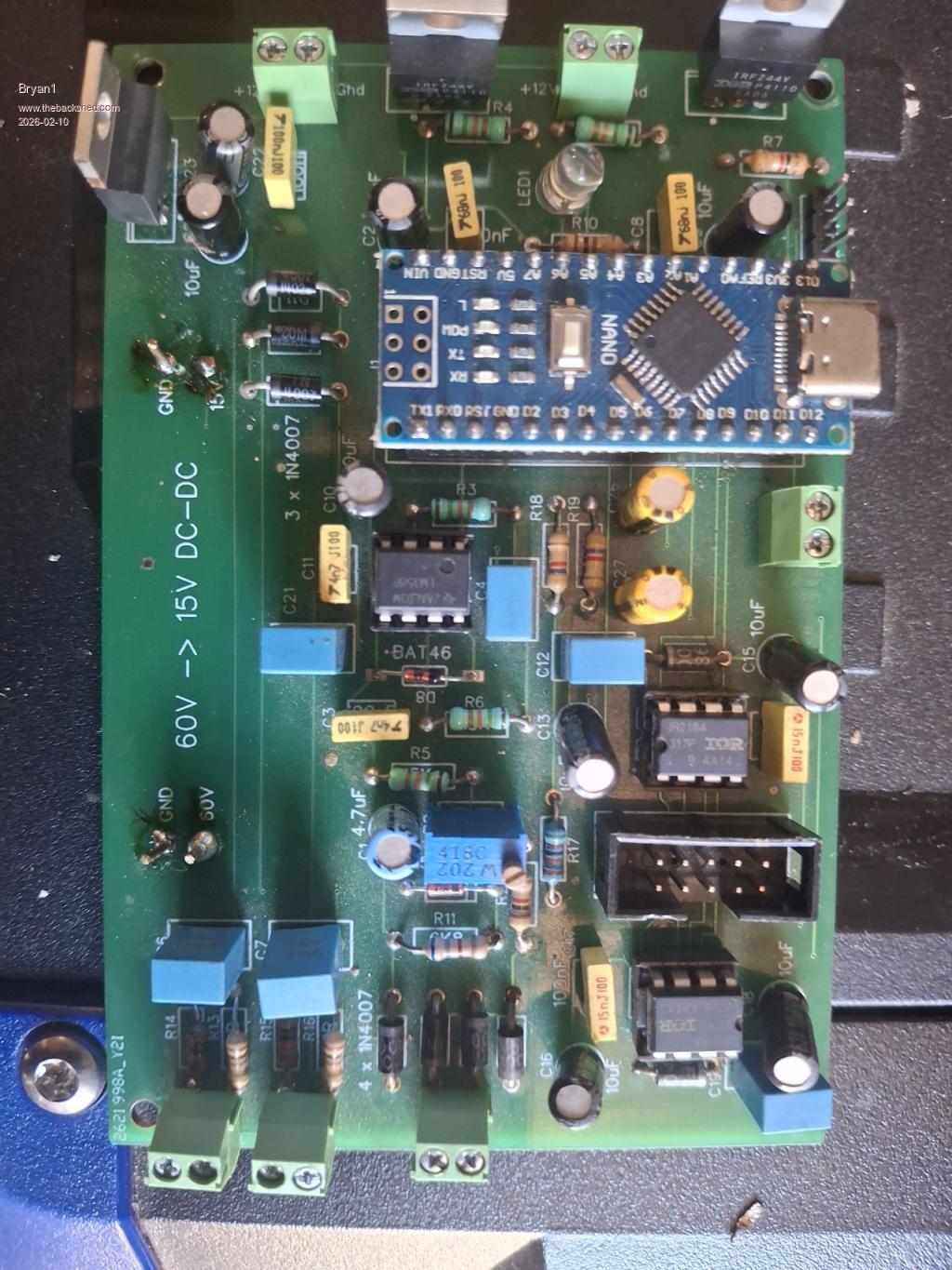

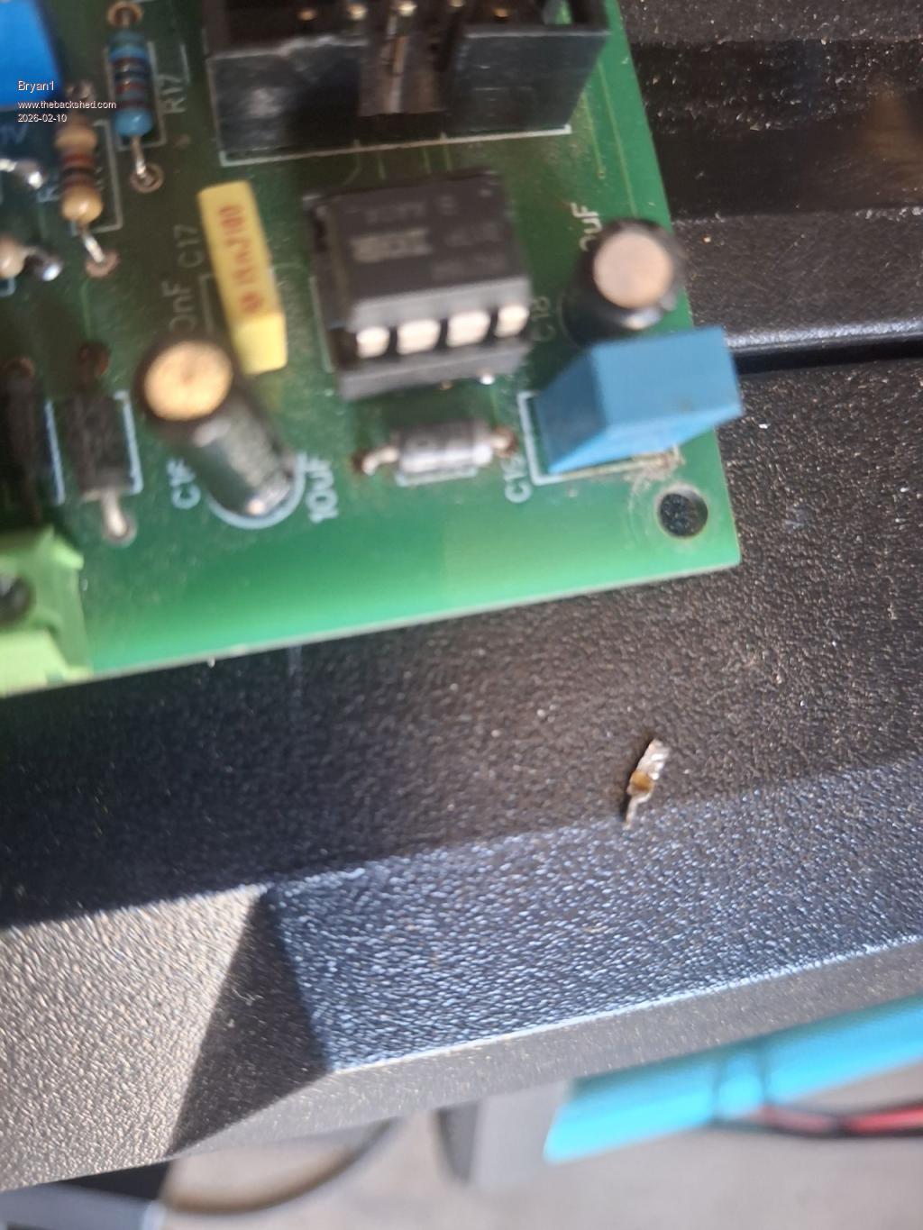

Ok got the brain board out and had a look
Now the fast diode on the end of the board fourth solder joint in the top right
Now doing a diode test does show it isn't blown but that solder joint does need some attention.
Just had a look under the board and this was staring at me
So the 50 volt track has lifted and this is the real culprit that I was looking for all along so the raised track could of been touching another component which caused the short.
Edited 2026-02-10 15:40 by Bryan1
Posts: 3416
Posted: 05:34am 10 Feb 2026
The blown track in the middle of that pic. may need looking into as well!
You need to find what caused that.
Edit.
Looks like it goes from the cable socket toward the 50V pin.
Edited 2026-02-10 15:43 by phil99
Posts: 3416
Posted: 05:46am 10 Feb 2026
  Quote  the raised track could of been touching another component which caused the short.
More likely a short caused the track to lift as it overheated.
