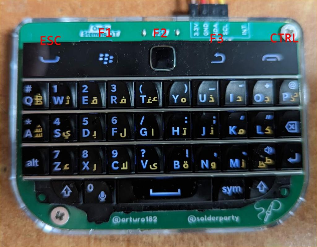

Posted: 10:21am 31 Mar 2023
V5.07.07b31 / WEB V5.07.07b1
Support for micro I2C keyboard
Set OPTION SYSTEM I2C if not already set
Connect the keyboard to the system I2C pins
Then set OPTION KEYBOARD I2C
Keys along the top are programmed as ESC, F1, F2, F3, CTRL
To use the editor see the manual for the control keys that are used for forward, backwards, up, down, F4, F5, etc.
The keyboard is fully functional if a little small. Key repeat is not implemented and won't be. KeyDown, KeyUp codes could be made available if a real program was written to require them.
The keyboard can be used on any of the PicoMite variants
