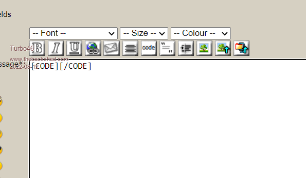

Try this:
Click on the 7th button along, the one with "code" on it.
You'll get
[C0DE][/C0DE]
(the 0 will be a O in both cases. I did this to fool the software)
Put the cursor between them and press Enter. Then put your code between those lines. e.g.
[C0DE]
'This is my code
[/C0DE]
Once again, I've fooled the forum software to show you this. It will actually come out like this when your post is displayed:
'This is my code

stanleyella, Please. If you click on the code button above the box where you enter your post it will put the code begin and end markers in your post for you as shown. Just paste your code between the two markers. Thank you.
You can even get MMEdit to format the code for you but leave that for another day

I used code button and pasted between [code][/code]... er what's different to pasting?

  Quote  er what's different to pasting?
Well it puts the code in a separate box as you can see. There is no confusion on what is code and what is the rest of your post.
If you put:
I tried
OPTION BASE 0        ' 0 based arrays
OPTION EXPLICIT
dim dx%(7),dy%(7),spx%(7),spy%(7)....
and then some other comment, it is harder to separate the wheat from the chaff.
You do want others to read your code so it helps to make it as easy to read as possible.
You can use the Preview Post button below the box where you are entering you code to check if it is formatted as you want.
