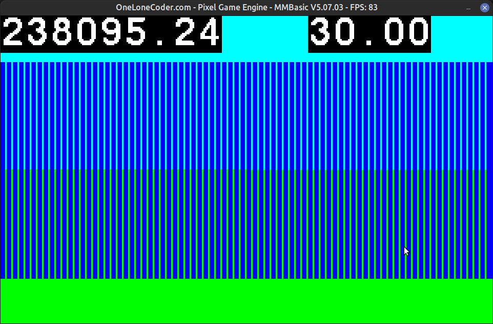

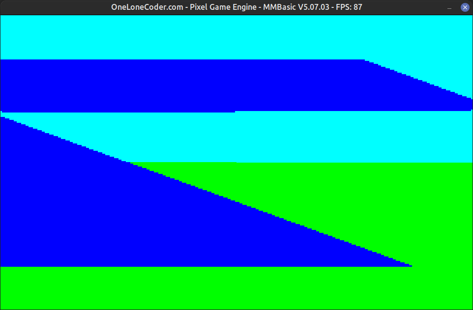

Hey Peter
I discover two issues running the MMBasic on wine (I don't know if they happen on Windows)
1) The page copy seems to do not respect the B argument. It is generating rendering artifacts.
option explicit
dim c,k1%,k2%
mode 3,1 ' 320x200
page write 1
do while 1
 timer=0
 ' Keyboard
 k1%=keydown(1):k2%=keydown(2)
 if k1%=120 then exit do
 ' Draw scene
 box 0,0,mm.hres,mm.vres/2,,rgb(cyan),rgb(cyan)
 box 0,mm.vres/2,mm.hres,mm.vres/2,,rgb(green),rgb(green)
 for c = 0 to MM.HRES
   line c,30,c,170,1,rgb(blue)
 next c
 ? @(0,0) str$(1000/timer,0,2) ' FPS
 ' Copy memory page to screen
 page copy 1 to 0,b
loop
page write 0
cls
mode 1

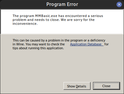

2) Sometimes the interpreter closes with the following page fault:
This is the backtrace:
Unhandled exception: page fault on read access to 0x00000014 in 32-bit code (0x00443f74).
Register dump:
CS:0023 SS:002b DS:002b ES:002b FS:006b GS:0063
EIP:00443f74 ESP:7d4afea8 EBP:7d4aff08 EFLAGS:00010246(  R- --  I  Z- -P- )
EAX:00000000 EBX:00000000 ECX:00000000 EDX:7f7d0d97
ESI:283c1a68 EDI:20020200
Stack dump:
0x7d4afea8:  56711a0f 00000000 283c1a68 00000000
0x7d4afeb8:  7d4afef8 00441add 283c30c0 283c30c4
0x7d4afec8:  283c30c4 283c2c00 7d4aff00 004419f0
0x7d4afed8:  283c1a68 283c1adc 283c1ae4 00440d70
0x7d4afee8:  00000004 00000001 7d4afec0 00090048
0x7d4afef8:  7d4aff20 7d4aff30 00498f7d ffffffff
Backtrace:
=>0 0x00443f74 EntryPoint+0xffffffff() in mmbasic (0x7d4aff08)

0x00443f74 EntryPoint+0xffffffff in mmbasic: movl 0x14(%eax),%eax

Page copy does not implement the "B" or "D" as there is no way of knowing the raster timing. Without the copy in a tight loop as you have it the copy is so fast that you shouldn't normally see any issues. I'm seeing 1700FPS on your test vs a screen refresh rate of 60Hz hence the artefacts (the framebuffer is getting written 28 times for each screen refresh)
Can't help with the wine issue. Looks like it might be running out of memory and unable to page - can you set the pagefile size in wine?

  matherp said  Page copy does not implement the "B" or "D" as there is no way of knowing the raster timing. Without the copy in a tight loop as you have it the copy is so fast that you shouldn't normally see any issues. I'm seeing 1700FPS on your test vs a screen refresh rate of 60Hz hence the artefacts (the framebuffer is getting written 28 times for each screen refresh)
Thank you Peter
I updated the code to control the scene repaiting. The left counter is from the main loop and the right one is from the screen rendering.
I think it is using the pagefile size from Linux. I'm not sure. I will take a look.
