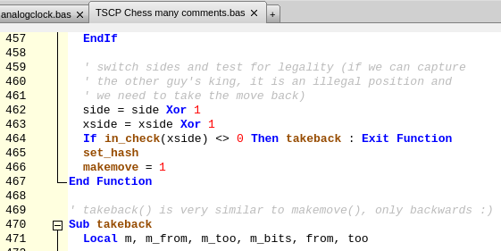

Posted: 01:45am 05 Oct 2022
I have updated all MMEdit5 downloads on my website.
The only obvious change is user subs and functions etc are colour coded for easier recognition.
There has been a small change to hopefully eradicate the problems in Linux reported by Volhout
  Quote  Changes:
05 Oct 2022
User subs and functions now colour-coded.
Cosmetic improvements.
01 Oct 2022
Syntax help now shows the hint in the status bar in Windows. This was the default for Linux.
The help hint stays visible until the cursor is moved to a different line.
Go to line_sub_function now brings cursor line into view when code folding is in use.
Option to start file selector with *.* instead of *.bas ( Misc preferences, File selector = 1)
Posts: 6204
Posted: 02:56pm 05 Oct 2022
Hi Jim,
Have not seen any abnormalities. Works nice, the coloring of functions is really useful. Thank you for that.
I noticed it also colors labels (xxx:) was not expecting that but that is actually also nice...
I will put it through it's paces the coming weeks and see if I can find problems, but for now: TOP.

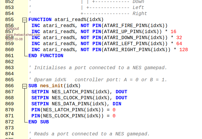

Posts: 6204
Posted: 02:56pm 07 Oct 2022
Hi Jim,
Minor remark:
Functions that end with a % do not color.
Posted: 07:40pm 07 Oct 2022
  Quote  Functions that end with a % do not color.
Nor do ones that end in ! or $.
I will see what I can do...
Posts: 6204
Posted: 08:49pm 07 Oct 2022
The ones with $ are colored. I checked.
Posted: 11:52pm 07 Oct 2022
  Volhout said  The ones with $ are colored. I checked.
Not always. Now they will. The changes I made might have changed a few other things with keyword recognition because there is a lot of interaction between the various lists.
Thank you for being an unofficial tester, especially for the Linux version.
I have updated the archives for all platforms on my website with a fix as well as a couple of other small changes.
  Quote  Changes:
08 Oct 2022
Find now has find previous option.
MMCC file transfer progress now in popup messagebox.
!%$ added to valid word characters.
05 Oct 2022
