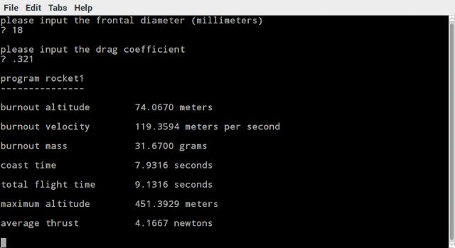

This post talks about capturing screens using Peter's implementation of the SYSTEM command on the Raspberry Pi.
First install scrot using the following
sudo apt-get install scrot
Scot is a utility for capturing screenshots.
Its use via the SYSTEM command is illustrated in this Raspberry Pi version of the rocket1 MMBASIC program posted earlier. The following line of source code captures the "active" screen and saves it to a file named rocket1.png.
system "scrot -u rocket1.png"
Here's the screen capture image.
Here's the slightly updated source code listing.

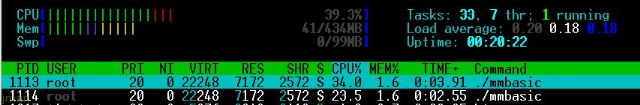

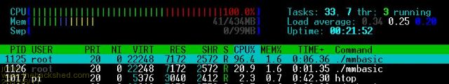

Hi Peter
I did few tests with different versions of PI Mmbasic using a PI Zero w
It seems any verison after 2017-05-04_191630_mmbasic maxes out the CPU
See the screen shots below
And 2017-05-05_082859_mmbasic
This also happens on PI3 but it only maxes one core
Jman

  Quote  It seems any version after 2017-05-04_191630_mmbasic maxes out the CPU
Like all versions of MMBasic the code sits in a tight loop while waiting for console input and loops continuously when running a program. In addition the code switches to linux "real-time" execution mode when executing time critical commands (e.g.ds18b20). Normally it exits this mode at the end of the relevant command except in the case of PWM where it stays in real-time mode until all PWM outputs are closed. When in "normal" mode MMBasic executes at priority 0 so Linux can schedule any competing tasks against it using normal timeslicingEdited by matherp 2017-06-12
