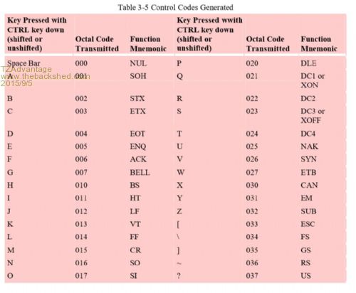

What should we do with keys that are combined with Control.
Ctrl+C is obvious but which other ones would be valid and/or useful.
The program also allows for a RAW mode that sends every key to the output so i don't need to do all combinations.
I am particularly interested what it should do in VT100 mode and especially for when it is used as a keyboard for a Mite.
edit: found something with google. And yes it was on Geoff's site. of course!
Edited by TZAdvantage 2015-09-06
Posted: 04:53pm 05 Sep 2015
As far at the CTRL key combinations are concerned, I can't actually think of any other then CTRL-C, really.....
The others, like ESC/F1-F12/PageUP/PageDOWN etc, are not CTRL keys(in that you need to hold CTRL as well as pressing these keys), so I can't actually think of any others then CTRL-C. I welcome anyone mentioning any others I am not thinking of.

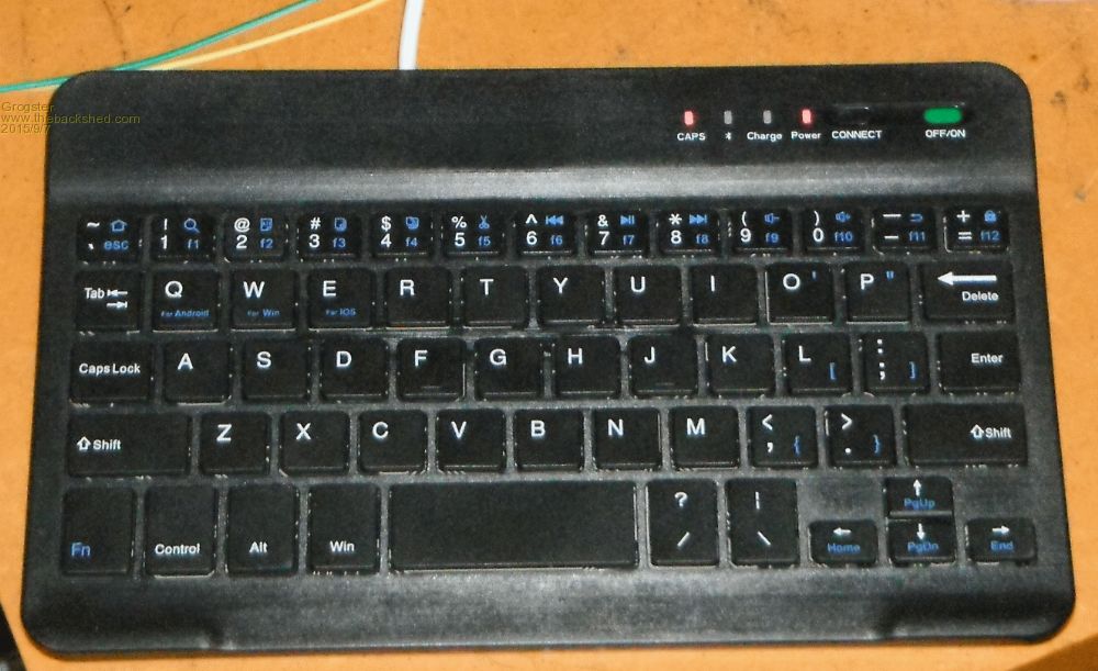

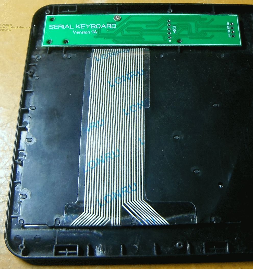

I have not allowed for the "CONNECT" tact, but what about putting that tact back on the PCB, and connecting that to the MM's MCLR pin? That way, you can press this button to restart the code should you need to. This would have to be on a 1B version of the PCB. Connecting to MCLR with the tact would mean you would not need to code a CTRL-ALT-DEL sequence, nor lose a pin in the process.

Yes, the connect button would be better. I forgot about that button.
Software is coming along slowly. There are a lot of combination keys on that keyboard. Especially with the Fn key.
Did you ever get this thing to work on a PC. Mine pairs and connects but can not get a single key out of it.
I wonder what the delete key should be.
A backspace when pressed by itself?, and a delete when you combine it with a shift?
I am almost inclined to see the word delete in blue so that a Fn+Delete gives a delete instead of with shift. Seems to make more sense when typing and is more in line with the arrow keys becoming home, end, pageup and pagedn when combined with the Fn key.
It does not make any difference in difficulty it is just that i think an Fn key will be easier to use to choose Backspace or Delete.

I see merit in using this keyboard for use with a micromite. It is compact, has a good matrix as we found out and it will serve its purpose very well.
As a keyboard for a laptop, TV box etc it is not that good. Bluetooth is shaky at best. I can get it to work on a Android phone, nothing else.
I have lots of stuff i use for testing my websites on and it does not work on most of them. So no this keyboard is not very well for use as it is advertised.
What i would like to accomplish is that this keyboard can replace a real keyboard for the micromite. Being able to edit, save and run programs should be just as easy as when you do it with teraterm. To get that to work it should emit VT100 codes. Also the function keys should work as those are used in the editor.
ctrl+c for stopping a program also. Navigsation with the arrow keys, pageup/Pagedn, home, end, backspace, delete, etc are all needed to make editing possible. It is not that difficult to do, but doing it in a structured way so that when someone wants to use another keyboard is more difficult. I would like to get it to work by just replacing some lookup strings.

PCB's arrived tonight, so I will send you a panel tomorrow using the address you sent to me for the MM+ boards. They are a perfect fit for the original board, using the existing PCB standoffs. As with the original board, these ones are 0.8mm thick, so be careful not to snap 'em!
I hope to build one up tonight, and post some photos - it will be nice to get rid of all those jumper wires!!!!

Posted: 12:56am 07 Sep 2015
Replacement PCB in place:
Programmed and working with the current code.

Posted: 01:21am 07 Sep 2015
Well done Grogs

Posted: 02:38am 07 Sep 2015
Well that looks easy.
Great fit! I look forward to make my own. (Of course no SSOP's) only dips en soics.
