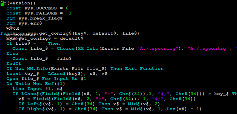

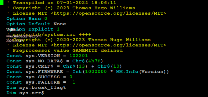

I think you have already a clue on the file copy issue, so I maybe too late, but here is some background screenshots.
The original file is on B, open in build in editor
After copying to A, in editor... Looks like the first 512 or so characters are missing.
EDIT: Framebuffer merge problem: also present on 2040.

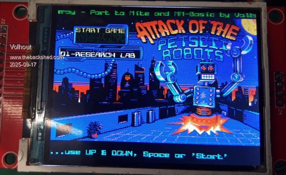

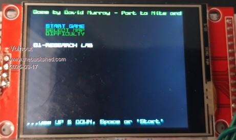

This is the phenonem.
b11
b12
Seen this on 3 different pico-lcd combinations. The photo is from a non-Game*Mite LCD connected (SYSTEM SPI) 2040. But it is the same on the Game*Mites.
Edited 2025-09-17 19:49 by Volhout

Confirmed
This last version works okay for 2350 in Game*Mite with Petscii robots.
I still have to check the file transfer issue, but the framebuffer merge issue is gone.
Edited 2025-09-17 20:04 by Volhout
