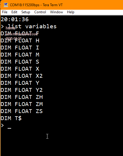

homa
Joined: 05/11/2021
Posts: 725
Posted: 07:06pm 24 Mar 2025
> option list
PicoMiteHDMI MMBasic USB RP2350A Edition V6.00.02RC7
OPTION SYSTEM I2C GP20,GP21
OPTION FLASH SIZE 4194304
OPTION COLOURCODE ON
OPTION KEYBOARD GR
OPTION CPUSPEED (KHz) 315000
OPTION RESOLUTION 640x480
OPTION SDCARD GP22, GP26, GP27, GP28
OPTION AUDIO GP10,GP11', ON PWM CHANNEL 5
OPTION RTC AUTO ENABLE
OPTION MODBUFF ENABLE  192
OPTION PLATFORM HDMIUSB
  ville56 said
  matherp said
There is a newline when I use it with teraterm or on the VGA or HDMI output
Sorry Peter, there are no newline ... please see attached screenshot with control chars visible.
List-vars.zip
That is astonishing ...
Matthias
Edited 2025-03-25 05:08 by homa
