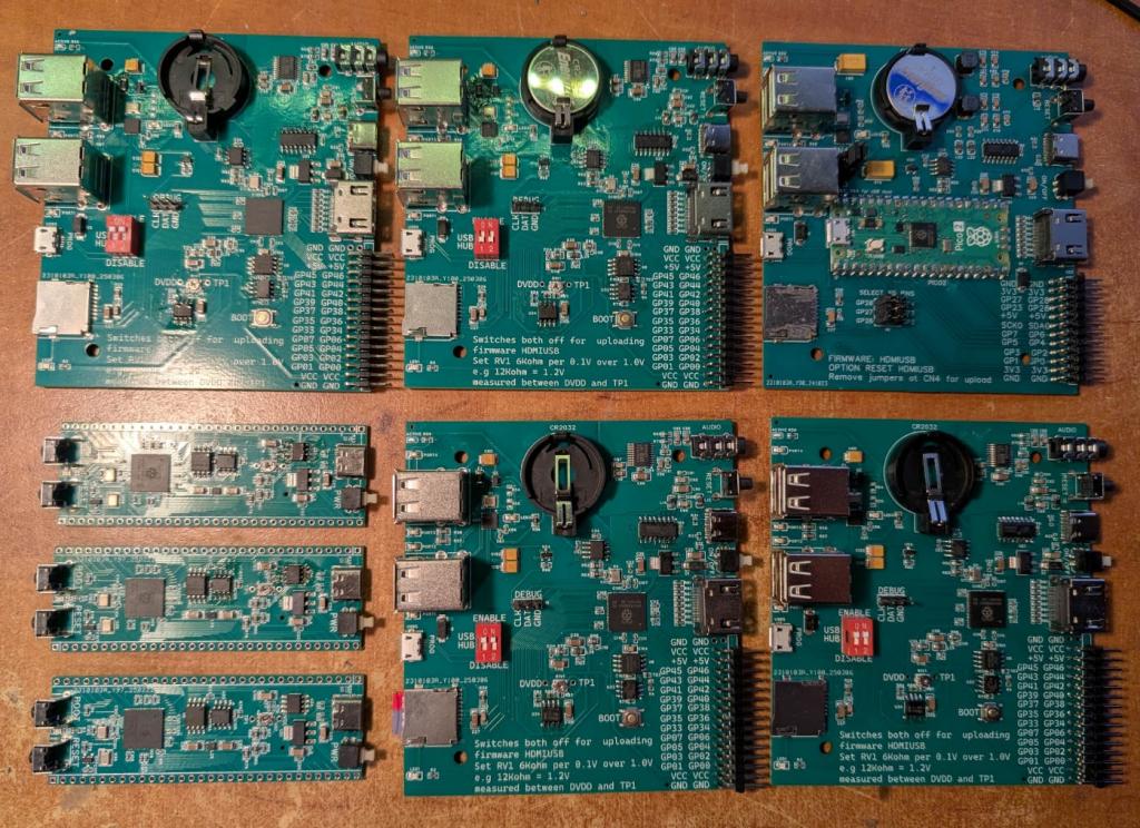

I'm now happy to release the design files for the 2B version of the reference design.
This has I2S audio and the rp2350B giving 22 I/O pins on the external header including all 8 ADC pins. The board is fully tested up to and including 1280x720 resolution with DVDD set to 1.3V
The overcurrent protection for the USB hub is disabled so it will work with all batches of the CH334F. There is a re-setable fuse on the USB 5V line so this isn't an issue.
Schematic
32c6a41b-0058-4b43-a15f-3550061d4cda.pdf
Gerbers
Gerber_PCB1_2025-03-20.zip
BOM and P&P
BOM_P&P_2025-03-20.zip
EasyEDA design file
PicoUSBMotherboardV3.0.zip
DXF files for end-plates for the box
HDMIUSBV2.0B.zip
There are two small changes from my prototypes. First, I'd lost one of the four  mounting holes which has now returned. Second, the external I/O header was too close to the HDMI connector so I have removed 2 VCC pins and reduced the header to 30-pins from 32.
Note that JLC/LCSC is still out of stock of the APS6404L-3SQR-SN PSRAM chip so you will need to source this separately and install it yourself if required.
Also, you can save some cost by buying the various through-hole components yourself and soldering them on the boards supplied by JLC.
I do have a surplus of fully loaded and tested RP2350 boards which I would like to sell to anyone in the UK
3 * RP2350B DIL boards @ £20 each
1 * Pico2 reference design @ £25
4 * RP2350B reference design @ 30 - note these are missing one mounting hole and 2 GND pins on the external header are not accessible
Drop me a PM if interested.

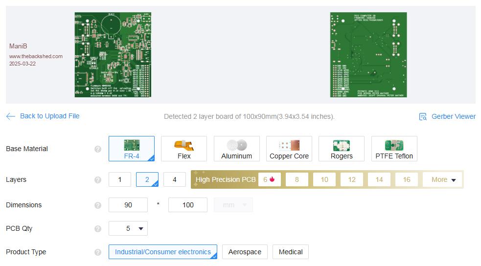

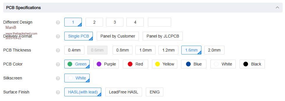

Hello Peter, many thanks for your great work.
As already announced, I would now place my first order at https://jlcpcb.com/. I have uploaded the zip file of the Gerber files and adopted these settings.
Is that OK so far?
Posts: 12056
Posted: 07:56pm 21 Mar 2025
I just accept all the defaults so if you have done the same you will be fine. Of course you can change colour if you want - just slows delivery by a couple of days

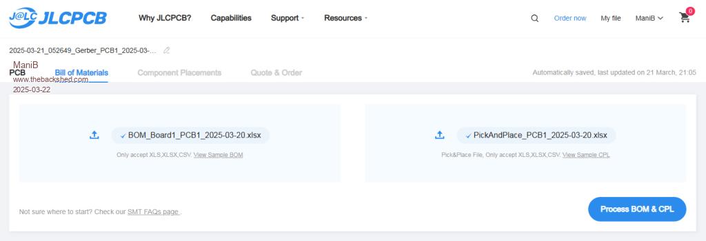

OK, then it's actually very simple. Do I also have to upload the BOM and P&P files?
And what about the DXF files for end-plates for the box? Should I order them at the same time? Or is that not important at first?
Amnesie
Joined: 30/06/2020
Posts: 763
Posted: 08:24pm 21 Mar 2025
  ManiB said
  matherp said  I just accept all the defaults so if you have done the same you will be fine. Of course you can change colour if you want - just slows delivery by a couple of days
In the order process you will be asked for those files. The frontpanels are another order you have to place.

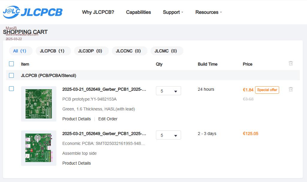

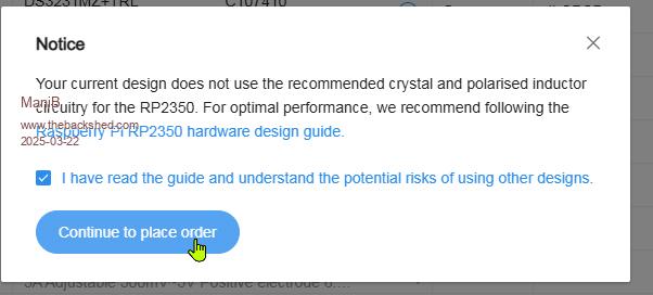

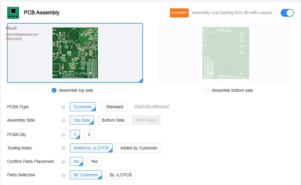

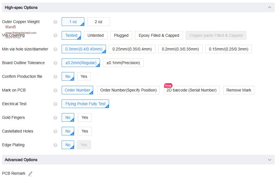

Posted: 08:28pm 21 Mar 2025
Ok, the question about the BOM and P&P has been answered.
This warning came up, which I ignored:
I now have that in my shopping basket. Do I have everything I need to order?

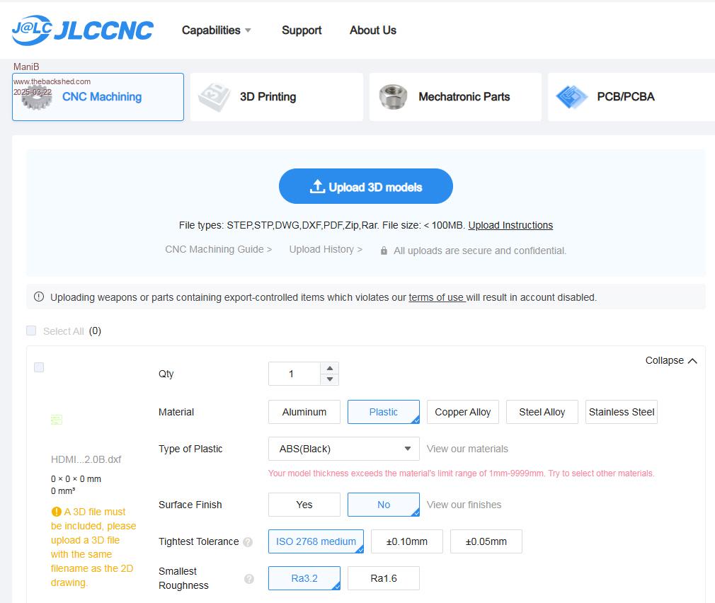

How do I order the DXF files for end panels for the box?
Is this done via ‘CNC Machining’ or ‘3D Printing’?

Posted: 09:21pm 21 Mar 2025
I have tried this with CNC Machining, but after uploading the .dxf file I get this message:

Posted: 10:40pm 21 Mar 2025
ManiB
The dxf files are only the bare outlines of the panels. CNC Machining is the wrong thing to do...
Personally I would import them into EasyEDA and add some markings like text and so on... After that you can save it as an PCB and order it like a normal PCB.

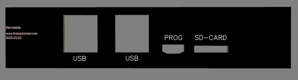

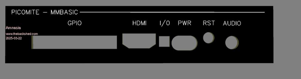

I created some panels as PCB from peters DXF...
Gerbers: (just order as normal PCB and IMPORTANT!! write in JLCPCB additional notes, that it is OK that there are no tracks, it is intended as panel only)... Without this additional note they often ask, if this is right... And you must select:
Mark on PCB Order Number(Specify Position) This way the JLC order number is on the backside silkscreen.
Gerbers:
Gerber_panels_frontpanel_2025-03-22.zip
Gerber_panels_backpanel_2025-03-22.zip

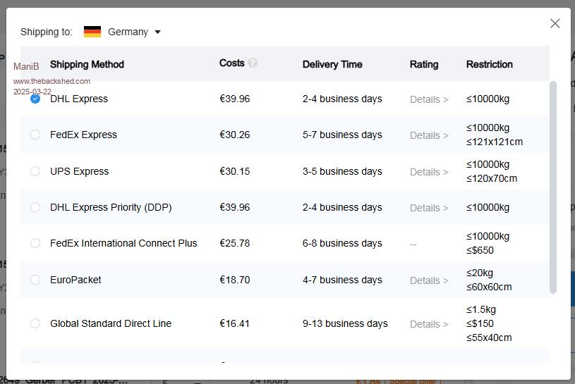

Posted: 11:58pm 21 Mar 2025
I have added front and back panels pcbs. Thanks Daniel.
Which shipping option should I choose?
