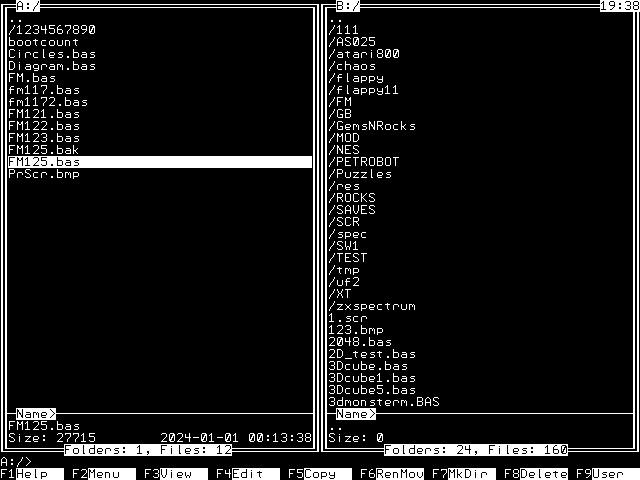

FM v1.3 for PicoMiteVGA/HDMI
The original code has been refactored. I brought some order to it.
- File sorting for panels has been added.
- The file renaming function has been moved to F6
- Now F2 calls up a menu of built-in subroutines that can be developed (I made a couple of examples).
- The F9 button now has a user menu of commands that the user can add to the program at the beginning.
(commands executed in the program and commands executed in the command line, including options).
- The user can also type any command while in the File Manager and it will be executed.
FM13.zip
I haven't gotten around to copying and moving entire directories, multiple file selections yet, I think I'll do that next.

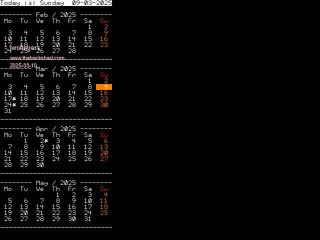

This is a screen shot of the calendar program (cldr.bas):
And this is a small update (v081):
cldr.zip

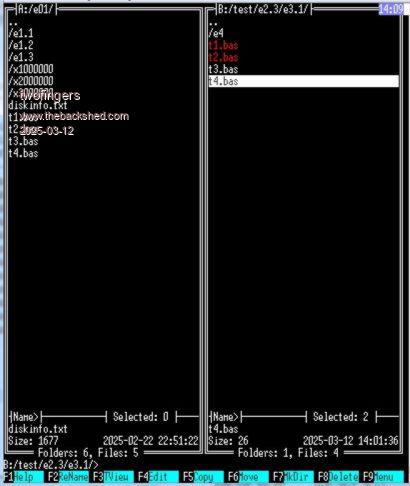

I've created a VT100 demo version of my trial version. The fundamental functions are working. But there is still a lot to do!
I wanted to check if there were any fundamental issues with the implementation.
That doesn't seem to be the case.
fm-VT100 (V0.2011).zip

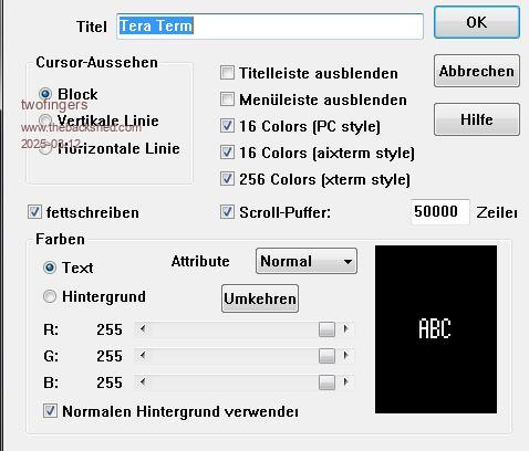

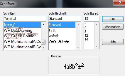

The important thing to remember is the settings in the Terminal program: the screen display must be white on a black background, and the font should be "Terminal."
Best wishes to Ukraine!
Michael

I'm surprised you're getting error messages; I don't (Pico 2 on Peter's reference design). You can certainly delete "Mode 1" yourself. I don't get the error message. But what you're saying is interesting.
I've also left all the HDMI/VGA-specific commands (Color, Tiles, etc.) in this test version because they might help with further processing. Of course, they make as little sense as "Load image" and "save image."
I can't say if and when I'll continue working on this version.
But I think it can be useful — as long as you don't get any error messages!
