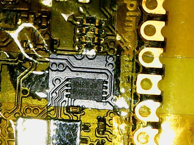

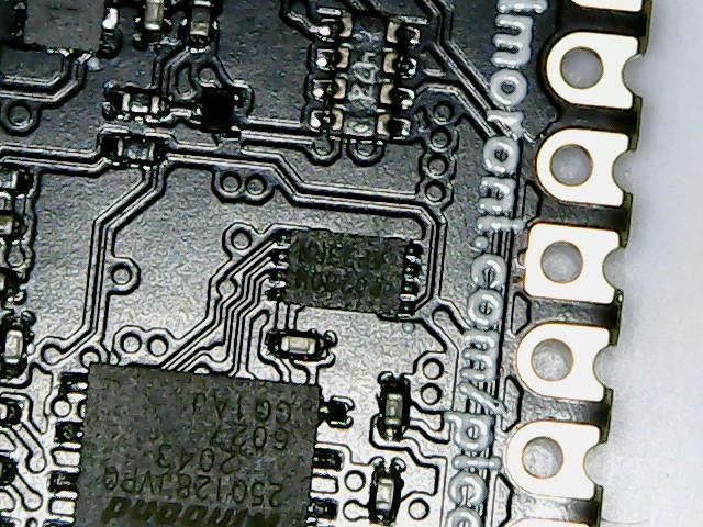

Before removal
Kapton tape is your friend!

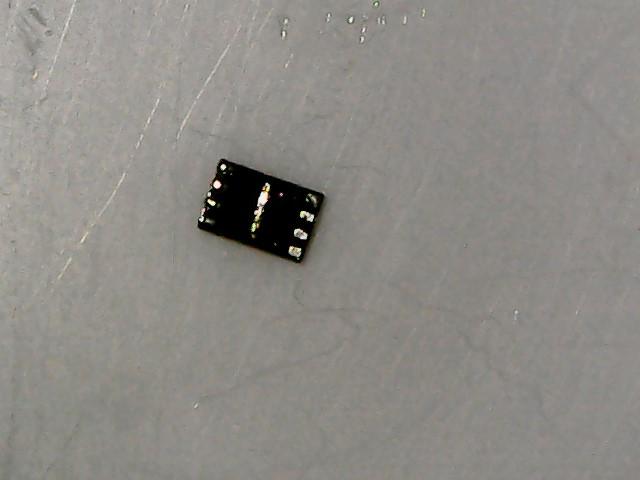

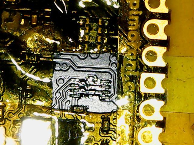

And....it's gone!
Note that the tiny PSRAM chip has a center pad with no corresponding pad on the PCB.  I hope they have bonded the center pad on the RP2350B to something useful, but I'm not willing to remove one to find out.
!!!Warning!!  Do not attempt this without the proper equipment and experience with SMD components.  There is a  real chance of damaging the board beyond repair!

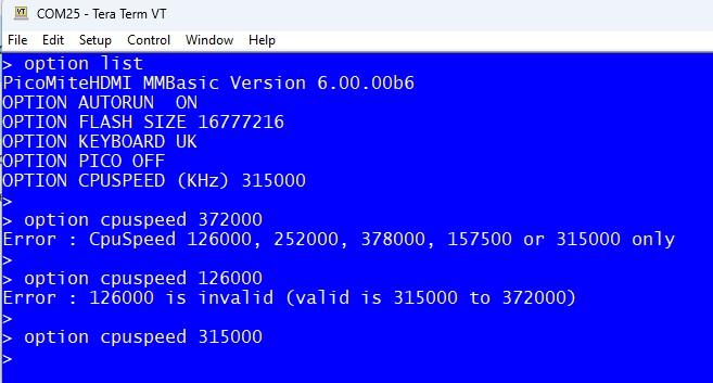

Currently using a Pimoroni Pico Plus 2 and have loaded the HDMI firmware (non USB) b6. All looks good but when I went to experiment with changing the CPU speed, I get the following conflicting messages......
I know a lot of the firmware is still work-in-progress, and I do remember seeing mention that the HDMI requires 372000 BUT the Pimoroni module may possibly only run at 315000.
The question here is: should I be able to change CPUSPEED to 372000 OR is the device being detected and hence preventing me from changing it?
Also - please can anyone enlighten me as to what 'OPTION PICO OFF' is all about (I have not refered to manual as not sure what one to look at
Really looking forward to all what the PICO2 offers (great work once again Peter   )

@WhiteWizzard
No. This and the PGA version are limited to 315000 max
Posted: 04:34pm 10 Sep 2024
  PhenixRising said  @WhiteWizzard
Thanks - so does this essentially mean the only current restriction is that they can’t do 720P ?
