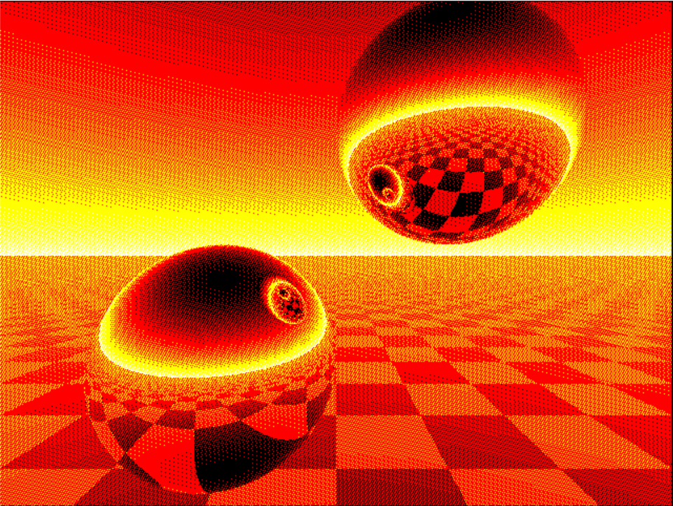

Hi javavi,
Wauw. This is beautifull. I did not have VGA system at hand, so I converted it to Game*Mite (any color LCD would do). But this is amazing. It feels like we could convert the whole of the universe into a few lines of MMBasic. Thank you. Between your demo's there are some real gems, pure diamond, and this is one of them.
dim cmap(15)'MODE 2
cMap(1)=RGB(Red)
cMap(2)=RGB(Yellow)
cMap(3)=RGB(White)
'Map set
For N=0 To 239
For M=0 To 319
X=0:Y=-.1:Z=3
U=(M-159.5)/160:V=(N-117.5)/160
W=1/Sqr(U*U+V*V+1):U=U*W:V=V*W
I=Sgn(U):G=1
E=X-I:F=Y-I:P=U*E+V*F-W*Z
D=P*P-E*E-F*F-Z*Z+1
If D>0 Then
 T=-P-Sqr(D)
 If T>0 Then
  X=X+T*U:Y=Y+T*V:Z=Z-T*W:E=X-I:F=Y-I:G=Z
  P=2*(U*E+V*F-W*G):U=U-P*E:V=V-P*F:W=W+P*G:I=-I
If V<0 Then
 P=(Y+2)/V:V=-V*((Int(X-U*P)+Int(Z-W*P)And 1)/2+.3)+.2
Color cMap(3-(48*Sqr(V)+(7*(M+4*N))Mod 16)\16)
Pixel M,240-N
Next
Next
Martin H.

Fascinating. I have no idea how the programme works, but Harms version also runs smoothly in mode 7 under mmbasic for Windows.
Here in 640x480 Picomite HDMI Mode 3 or CMM2/MMBASIC4Windows Mode 1
cls:Mode 1' Mode 3 PICO HDMI

And also on the RP2040-GEEK.
' - RP2040-GEEK -

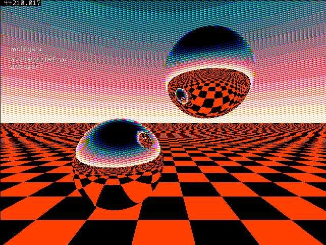

Hi Martin(/Harm/Vadim),
I hope you don't mind that I modified your code. I was playing around with it a bit (along with AI, since I don't really understand the code ;-)).
My goal was to explore the possibilities for speed optimization in pure BASIC.
For a faster speed (now 44 seconds on 640x480 display), I halved the resolution (using double pixels)!
MODE 3:CLS :Map RESET:Timer =0
Dim Float x,y,z,u,v,w,e,f,p,d,t,uo,vo,tp,v2,xi,zi,i3=1/320
Dim Integer m,n,k,o,c,uc=320,vc=240
Dim Integer G(15)=(0,1,2,3,4,5,6,7,8,9,10,11,12,13,14,15)
Colour Map G(),G()
For n=0 To 479:vo=(n-vc)*i3:v2=vo*vo+1:o=28*n
For m=1 To 640 Step 2
x=0:y=-.1:z=3.8:uo=(m-uc)*i3:w=1/Sqr(uo*uo+v2):u=uo*w:v=vo*w:i=Sgn(u)
 e=x-i:f=y-i:p=u*e+v*f-w*z:d=p*p-e*e-f*f-z*z+1:If d<=0 Then Exit Do
 t=-p-Sqr(d):If t<0 Then Exit Do
 Inc x,t*u:Inc y,t*v:Inc z,-t*w:e=x-i
 p=2*(u*e+v*(y-i)-w*z):Inc u,-p*e:Inc v,-p*(y-i):Inc w,p*z:i=-i
If v<0 Then
 tp=(y+2)/v:xi=x-u*tp:zi=z-w*tp
 k=((xi+4096)+Int(zi+4096))And 1
 c=10-k*10
Else
 c=Int(14-v*25+((7*m+o)Mod 16)\2)
c=c*(c>0 And c<15)+15*(c>=15)
Line m,480-n,m+1,480-n,,G(c):Next
Next
Print Timer
Variable ListVariable List
| Variable | Type    | Description                                         |
| x, y, z  | Float   | Current position of the ray in 3D world space.              |
| u, v, w  | Float   | Direction components (X, Y, Z) of the ray, normalized to 1. |
| e, f     | Float   | Distance vectors from current ray position to sphere center.|
| p        | Float   | Auxiliary variable for dot product and reflection math.     |
| d        | Float   | Discriminant to check for sphere hits (d > 0).              |
| t        | Float   | Calculated distance to the sphere surface hit point.        |
| uo, vo   | Float   | Screen coordinates mapped to the normalized viewport plane. |
| tp       | Float   | Distance from current ray position to the floor (y = -2).   |
| v2       | Float   | Pre-calculated vo^2 + 1 for faster ray normalization.       |
| xi, zi   | Float   | Exact X and Z coordinates of the hit point on the floor.    |
| i3       | Float   | Pre-calculated constant 1/320 to avoid divisions.           |
| m, n     | Integer | Loop counters for horizontal pixels and vertical lines.     |
| k        | Integer | Grid state (0 or 1) from the checkerboard formula.          |
| o        | Integer | Offset used for the pseudo-dithered sky pattern.            |
| c        | Integer | Final color index (0-15) after logic and clamping.          |
| uc, vc   | Integer | Screen center constants (320, 240).                         |
| G()      | Array   | Palette array for mapping to MMBasic color indices.         |
| i        | Float   | Sign factor to switch between sphere positions (1 or -1).   |
Functional Block Description
1. Initialization & Setup (Lines 1-8)
The code sets the display MODE 3 and resets the color Map. It initializes
all necessary variables and the G() array, which maps indices 0-15 to
the system's color palette.
2. Ray Normalization & Viewport Mapping (Lines 9-11)
Inside the nested loops, the code converts screen pixels (m, n) into
3D ray slopes (uo, vo). Line 11 is critical: it calculates the unit
vector components (u, v, w) using the Pythagorean normalization
formula to prepare for accurate physical reflections.
3. Reflection Loop (Lines 12-17)
The Do...Loop handles the ray-sphere intersections.
Lines 13-14: Calculate the discriminant 'd' and distance 't' to
check if a sphere is hit.
Lines 15-16: If hit, the position is updated (Inc x, y, z) and
the ray's direction (u, v, w) is mathematically reflected.
Line 17: Toggles 'i' to check the other sphere in the next iteration.
4. Floor and Horizon Logic (Lines 18-23)
Floor (Lines 19-21): If the ray points down (v < 0), the floor
intersection (tp) and checkerboard coordinates (xi, zi) are calculated.
Your optimized '10-k*10' logic assigns colors without 'If' branches.
Sky (Lines 22-23): If the ray points up, a dithered gradient color
is calculated based on the vertical slope.
5. Boolean Clamping & Output (Lines 25-26)
Line 25: The high-performance Boolean expression clamps 'c' between
0 and 15 without using the slower 'If' or 'Min/Max' commands.
Line 26: The 'Line' command outputs a 2-pixel segment to the screen.

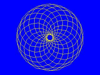

SinePoly
MODE 2
Dim integer xp(255),yp(255)
Dim integer s(255),c(255)
r0=63:a0=0:b0=0
di=217:db=1:da=1
For i=0 To 255
s(i)=Int(r0*Sin(i*Pi/128))
c(i)=Int(r0*Cos(i*Pi/128))
Next
si=220
Inc di:Inc si,-di
If di=220 Then di=0
If di=0 Then
 db=(db+1)And 255:si=(si+1)And 65535:Inc di,2
 Do : fc=Int(Rnd*16):bc=Int(Rnd*16): Loop While fc=bc
a0=(a0+2)And 255:b0=(b0+2)And 255
a=a0:b=b0
For i=0 To 255
 x=(si*c(a)+c(b)*di):y=(si*s(a)+S(b)*di)
 a=(a+da)And 255:b=(b+db)And 255
 xp(i)=160+x\128:yp(i)=120+y\128
Next
CLS Map(bc):Color Map(fc)
Polygon 256,xp(),yp()
Pause 20
Loop While Inkey$=""

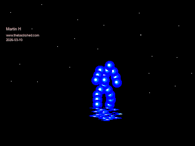

A small old demo that I wrote about 35 years ago in GFA Basic on the Atari ST, converted here for PICOMITE VGA/HDMI.
' Vectorball by Martin H. 1991-2026

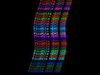

SinePrint
MODE 2
T$="PicoMite HDMI USB"
LT=Len(T$)*MM.FONTWIDTH
YB=MM.VRES-MM.FONTHEIGHT
XRL=MM.HRES-LT-MM.FONTWIDTH
XLL=MM.FONTWIDTH
XS=YLL
DIR=0
P=0
 X=XS+Sin(P)*MM.FONTWIDTH
 Color Map(1+Int(Rnd*15))
 Print @(X,YB)T$
 If XS<=XLL Then DIR=1
 If XS>=XRL Then DIR=-1
 Inc XS,DIR
 Inc P,.3
 Pause 60

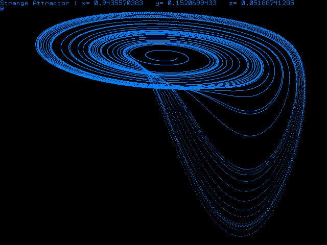

Rössler's Strange Attractor
A strange attractor is an attractive set in the phase space of a dissipative dynamical system, characterized by a complex fractal structure and chaotic trajectory behavior. Unlike conventional attractors (points or cycles), a strange attractor is not a simple curve or surface, and trajectories within it are unstable and exhibit high sensitivity to initial conditions.
MODE 1
Dim a=0.2, b=0.2, c=5.7
Dim x=0.1, y=0, z=0
Dim dt=0.005
Dim dx, dy, dz
Dim INTEGER i, x0=320, y0=110
Dim INTEGER CM(15)=(0,1,2,3,4,5,6,7,8,9,10,11,12,13,14,15)
Colour Map  CM(),CM()
Color CM(Int(Rnd*15)+1): CLS 0
x=Rnd
For i = 1 To 50000
 dx = (-y - z) * dt
 dy = (x + a * y) * dt
 dz = (b + z * (x - c)) * dt
 x = x + dx
 y = y + dy
 z = z + dz
 Pixel x0+x*26+y*8, y0+z*14+y*8
 If Inkey$ <> "" Then Exit Do
Next i
Pause 4000
