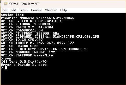

Hi Peter,
I have done some more testing:
The GEEK (PicoMite with SPI display) works correct.
The PicoMiteVGA works correct.
The Thermal Imager (ILI9341) does not show the problem, or it would have creashed during my development constantly.
The PicoMite with I2C display on system I2C bus shows the 'Display not configured".
It could be related to I2C displays? Or the SSD1306I2C32 (128x32).
At home I have a SSD1306I2C, that is the larger version 128x64. I can try tonight if that one also shows the problem.
Edited 2024-07-16 21:23 by Volhout

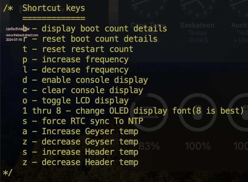

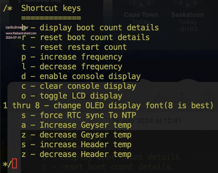

Another quirk I've noticed in the rem block is one comment which is tabbed keeps losing the leading tabs when saved.

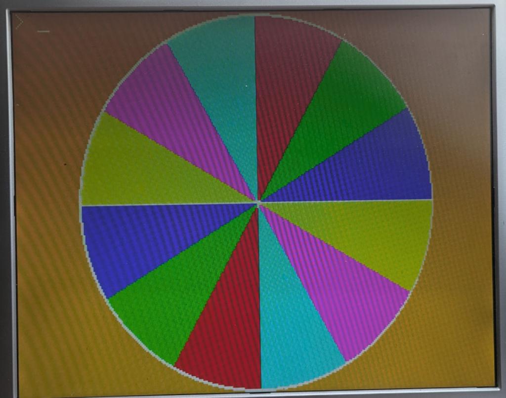

Prompted by a comment from Stanley, Ive added the map command and function to the PicoMiteVGA and PicoMiteVGAUSB based on the CMM2 functionality (see the CMM2 manual).
Load up the new firmware and run the following:
PicoMiteVGA.zip
' Set up an array to hold the colour mappings we are going to use
Dim integer cmap(6)
'Clear the screen
MODE 2
Map reset
CLS
'Set up 6 colours in the array
cmap(1)=RGB(red)
cmap(2)=RGB(green)
cmap(3)=RGB(blue)
cmap(4)=RGB(yellow)
cmap(5)=RGB(magenta)
cmap(6)=RGB(cyan)
' Do an initial update of the Colour map to set up our colours
domap
'Display an outer circle in white
Circle MM.HRes/2,MM.VRes/2,MM.VRes/2-1,0,,RGB(white),RGB(white)
' Now draw a simple colour pie chart using our new colours with the ARC command
Arc MM.HRes/2,MM.VRes/2,0,MM.VRes/2-3,0,30,Map(1)
Arc MM.HRes/2,MM.VRes/2,0,MM.VRes/2-3,30,60,Map(2)
