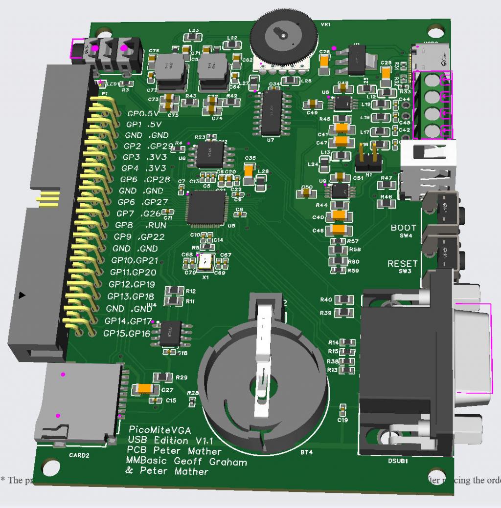

Posted: 08:06pm 27 Feb 2024
I flashed all 5 PCBs. All come up with the flashing red led, but one of them says "USB malfunctioned" (or words to that effect. The other 4 all worked through setting of options and CLS RGB(red).
I've reflashed the non-working one 5 times, including with the erase.uf2 file. No errors are reported, the red LED flashes as per normal, but no USB COMM port is available.
Anything else I should try on that one?
Posted: 11:03pm 27 Feb 2024
Hi Lizby,
I would guess that it would have to be something associated with the USB-C connector or the CH340C and components nearby.
Check for solder shorts or missed solder connections.

Posted: 08:39am 28 Feb 2024
  Quote  I would guess that it would have to be something associated with the USB-C connector or the CH340C and components nearby.
Agreed, it can only be 4 components or the wiring between them: USB-C connector, CH340, R31 or R32

Posted: 01:58pm 28 Feb 2024
I have looked fairly carefully over the entire board with a magnifying glass (with focus on the USB-C socket), and nothing is evident. I will look again at those particular components.
Posted: 03:47pm 28 Feb 2024
Reinspection with a magnifying glass did not reveal any obvious problems with this board.
Flashing again made no difference--USB device not recognized.
Are console pins somehow enabled with this firmware--or is it possible to get a test version with console pins set up?

Posted: 04:47pm 28 Feb 2024
  Quote  Are console pins somehow enabled with this firmware--or is it possible to get a test version with console pins set up?
They are but it is irrelevant. If I understand your issue correctly the board isn't registering the USB port with your computer? The CH340 should do this even with no firmware in the RP2040. Of course it wouldn't respond but you could short pins 2 and 3 on the ch340 with a screwdriver then should should get an echo on teraterm for anything you type.
Until this works the Pico is irrelevant.
If you have a USB-C to USB-A adapter then you can buzz out the middle two pins to pins 5 and 6 on the ch340. You should see 2 or 3 ohms on the correct pairs
Posted: 05:22pm 28 Feb 2024
  matherp said  If I understand your issue correctly the board isn't registering the USB port with your computer?
The board isn't registering the USB port with the USB_C port connected to the PC (as it successfully did with the other 4 boards). When connecting USB_A to USB_A, I could copy the uf2 firmware as with the others--apparently successfully, since the red LED is flashing once a second.
Posted: 05:42pm 28 Feb 2024
Ok, with the board powered through the USB_A to USB_A connector, with GP8 & GP9 and GND going to a USB-TTL module, I have console.
Posts: 12070
Posted: 06:14pm 28 Feb 2024
OK so you have narrowed it down completely to the CH340 circuit and you know that GP8 and GP9 aren't compromised. You should see the uart signals from your USB-TTL module on pins 2 and 3 of the CH340?
Check the power to the CH340  - Gnd on pin 1, 3.3 on pins 4 and 16.
If that is OK the personally what I would do is swap a ch340 from a known good board but only if you are confident in soldering the SOP chip
Posted: 08:24pm 28 Feb 2024
Hi Lizby,
It is possible that incorrect values have been soldered onto the board.
Check R36 & R37 are both 27R.
And check R31, R32 are 5k1 and R33 is 1M.
On the CH340 check you have 3v3 across Pins 1 and 16.
Looking into the USB-C connector do the pins look OK (compare to the others).
I am happy to look at the PCB for you but I am as far an away from you as it’s possible to be in the world and postage would be prohibitive and likely more than the cost of the board for 2 ways.
I personally don’t like the CHxxx family of Uarts and my first choice is always the FT231.
This prejudice probably extends from the early days when these type of chips were very hard to get Window 7 etc to talk to them, no doubt things are different now.

Posted: 11:18pm 29 Feb 2024
I knew it was wise to only get five myself in my prototype run!
Posted: 11:40pm 29 Feb 2024
  bigmik said  Hi Lizby,
Regards, Mick
Hmmm, R31, R32, and R33 have the values you say on a working PCB, but on the non-working one, R32 and F33 are correct, but R31 is 2k8. I'm not sure I have the skill to replace that.
  matherp said  Check the power to the CH340  - Gnd on pin 1, 3.3 on pins 4 and 16.
Power seems good from the USB_C socket--the board boots up and console is available on GP8 and GP9. I don't have the ability to swap the CH340--I'd probably end up with 2 bad boards.
Posted: 11:55pm 29 Feb 2024
Hi Lizby,
That ‘could’ be your problem as the different resistor value would report an incorrect device to the PC (or charge capability).
Removing  the resistor isn’t that difficult, add more solder to both sides and hit both ends with a HOT soldering iron and it will move easilly.
To solder a new SMD clean the pads with solder wick so they are as clean as possible,
put a small blob (not too much) of solder on ONE pad
Use tweezers and place the new resistor over the pads and hit the end with the blob, it should hold
Then properly solder the other end, then redo the first end.
If you are really unsure about soldering the SMD use a standard 5k1 resistor and identify the pad that is going to the connector (the non GND one) and solder one leg of the standard resistor to it and the other end to a suitable GND point. It may be best to solder the GND leg first to not put too much stress on the tiny SMD pad.

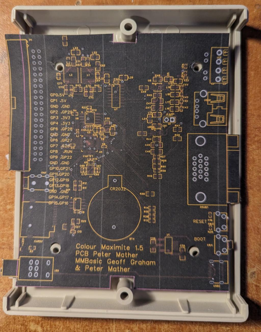

Posts: 12070
Posted: 06:19pm 07 Mar 2024
I've found a nice box for the Colour Maximite 1.5.
MULTICOMP MCRM2015S CASE, DESKTOP, ABS, 30X130X100MM
Just need to spread out the components on the PCB a bit to reach the edges. Unfortunately to get everything along the two edges the length is 110mm and the width to fit the box is 90mm
Posts: 9246
Posted: 06:23pm 07 Mar 2024
Yeah.... why can't they make enclosures in just the right size, eh?
Posts: 6199
Posted: 06:30pm 07 Mar 2024
Move the audio volume potmeter to the other side of the 40pin header.
