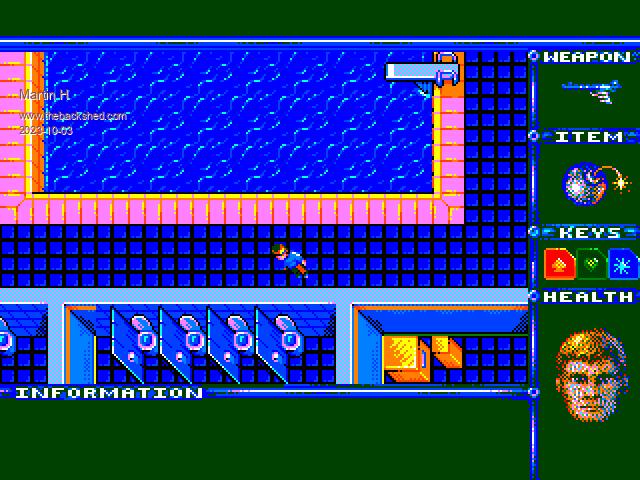

Good Morning Harm,
the Item and the Health Icons does not absolutely have to match into the 24x24 grid.
They have fixed Screenpositions at the Info Panel..
like this:
Tileset
Health ,Screenposition: 272,160
HL good to bad = 0 to 5
Tilesize: 48 x 52
Item/Weapon
ITM 0 & 1 Weapon, Screenposition: 272,36
ITM 2-5 Item, Screenposition: 272,80
Tilesize:48 x 24
Keys KEY:Tilesize: 16 x 16
Screenposition: 272,124 | 288,124 | 304,124

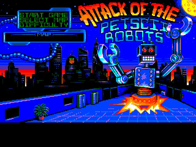

I've repainted the Items and Icons with DarkGreen BG Color and
refurbished the Intro Screen for better readability:
Here are the updated Files & the Font

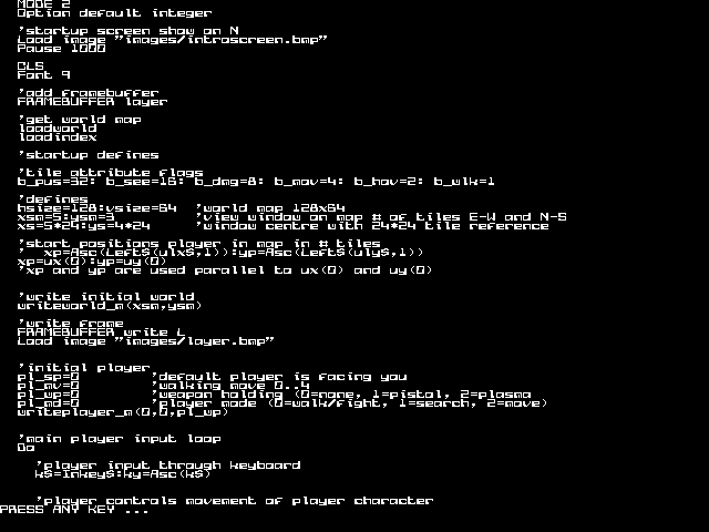

If you like, I can code the SUB renderLiveMap
PS: Your Listing looks nicer with the PETSCII Font:
Edited 2023-10-04 22:03 by Martin H.

The listing with the game Font was a Joke
I took a look at the PlatformSDL.cpp and am about to translate the renderLiveMa
to MM BASIC.
As we dont have the possibility to scale the Tiles
SDL_BlitScaled(tileSurface, &sourceRect, bufferSurface, &destinationRect)
I think I will create a String where each Tile is represented by one color.
So it will fit in a single String (as Tile 0 is black, we just need 1 to 255)
something like this:
' Level LiveMap Preview 256x128 On Layer
SUB renderLiveMap
local mapX,mapY,T$
'Tile colors
T$="123456789ABCDEF0123456789ABCDEF123456789ABCDEF0123456789ABCDEF"
T$=T$+"0123456789ABCDEF0123456789ABCDEF123456789ABCDEF0123456789ABCDEF"
Framebuffer write L
 for mapY = 0 to 64
  for mapX = 0 to 128
box 4+2*mapX,44+2*mapy,2,2,,Val("&H"+Mid$(T$,VAL("&H"+Mid$(LV$(mapY),mapX+1,1))-1,1))
  Next
 next
end sub
I would replace the values of T$ by the Color which comes out if i shrink each Tile to 1 Pixel
