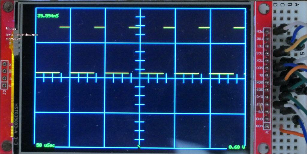

I've done a quick and very dirty conversion to a 480x320 LCD display, just to see how it looks and how fast the update was.
I've done away with the LAYERS and simply save the last times points in a lasttime array, which I use to remove the last trace, before drawing the new trace.
I also had to move some of your GP pin allocations, because my setup was already using some, so for the moment I've removed the hard buttons and moved the PWM output to GP22.
The number in the top left is the screen update rate in mS, so not at all bad.
Video of operation is here:- Scope video
Copy of your code modified here:-
Scope480x320.zip
Keep up the good work Steve. :-)

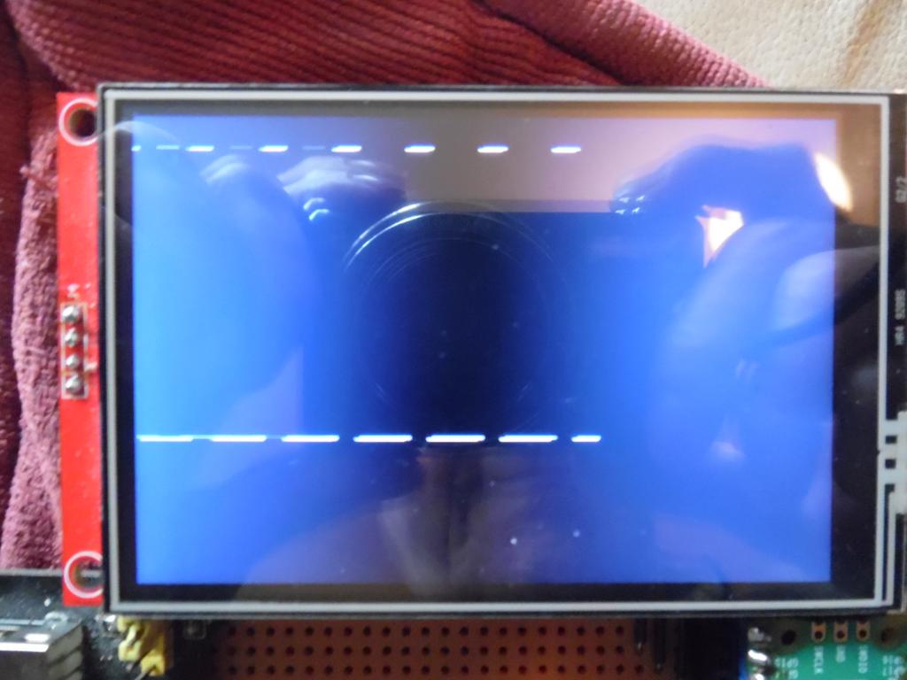

Posted: 02:08pm 31 Aug 2023
Hi @Bleep . You disturbed a bee's nest when you started this thread.
It's been a learning curve. I personally thought the layer was very neat but not that it only worked on the waveshare 160x80.
youtube is an easier way to display video imho
10KHz 70%pwm triggering...poor :(
https://www.youtube.com/watch?v=mheHDtksYJ0

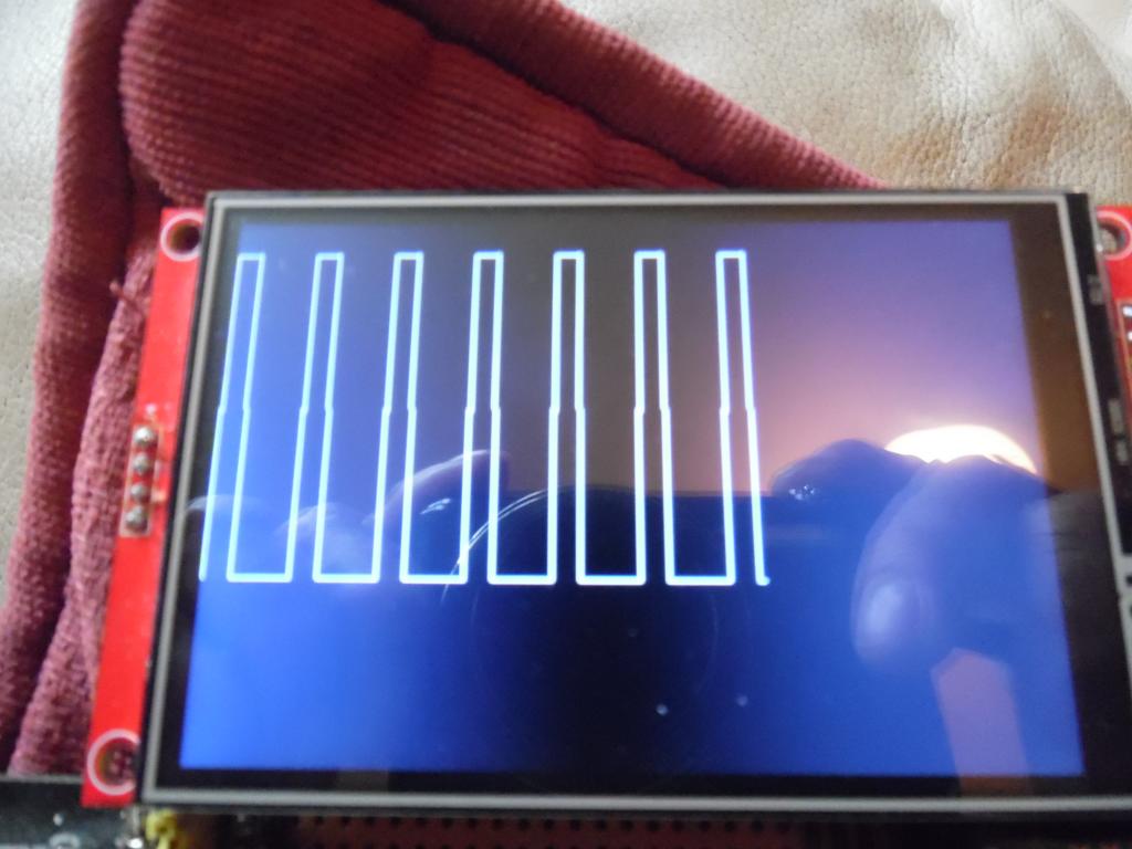

Posted: 06:19pm 31 Aug 2023
Thanks to phil99 I got pixel version working but prefer line as it trigger better

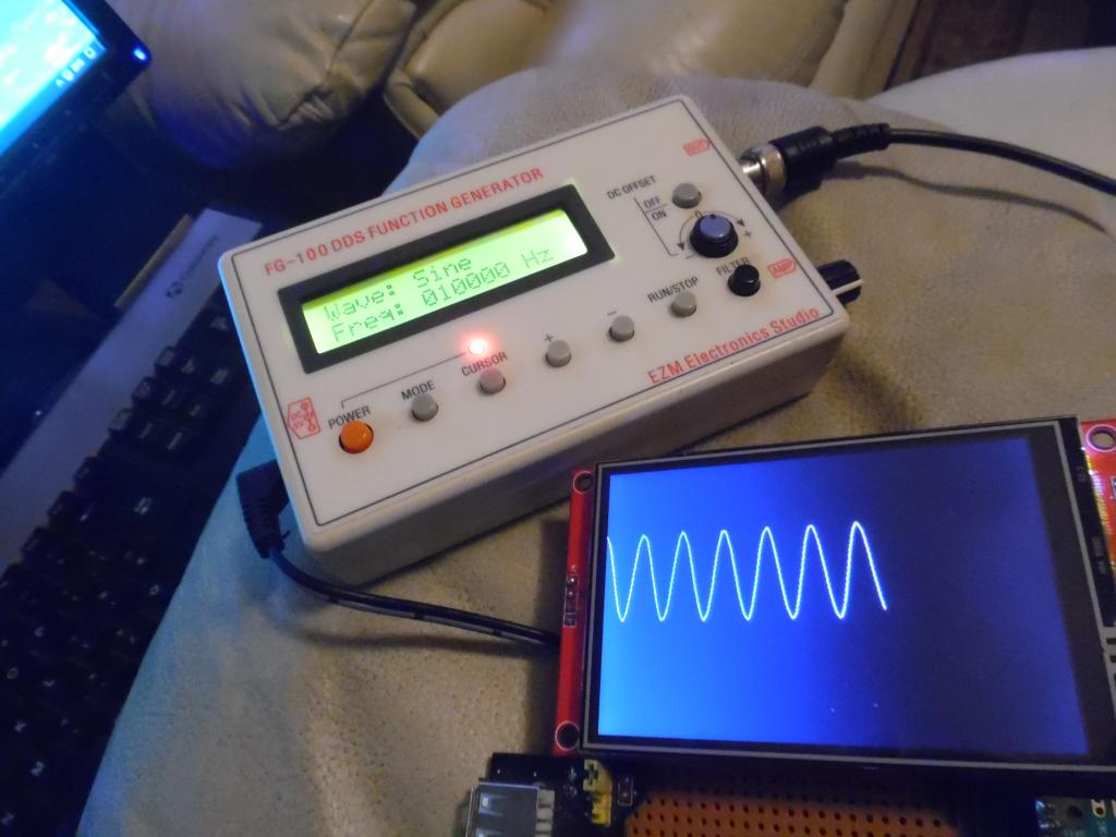

What about displaying sine, sawtooth and triangle waves?
Posted: 07:13pm 31 Aug 2023
  Mixtel90 said  What about displaying sine, sawtooth and triangle waves?
