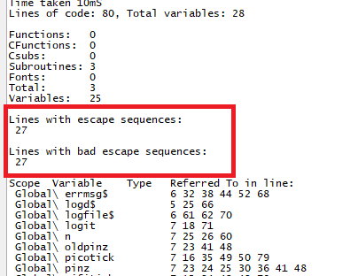

Posted: 08:17pm 18 Mar 2023
And the next MMEdit will include a list of escape sequences, both good and iffy in the variable report.
Just to make conversion easier.
