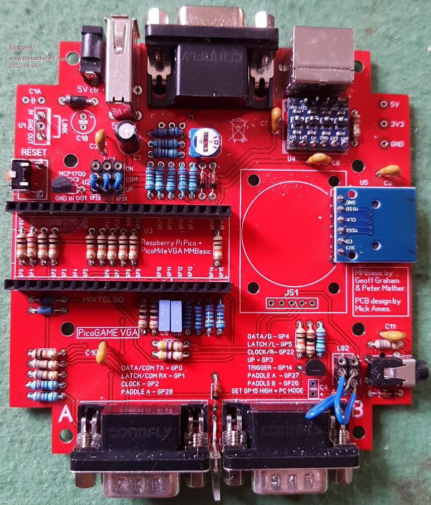

Yes, it's upside down. :) Looks a little odd, but in practice it doesn't matter.
Here's the "Normal" one:

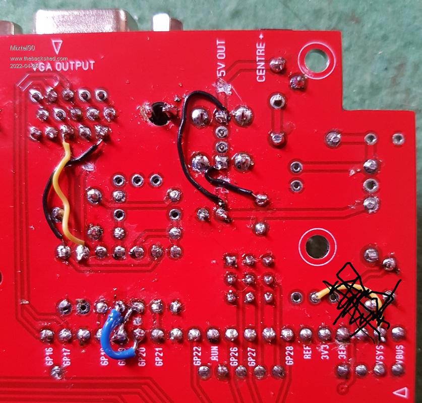

Here's the board mods, but only done on the "other" one. The crossed out mod is to do with re-enabling the SMPS so ignore it. The two crossed over black wires reverse the polarity of the USB-A socket, the rest fix the colours.

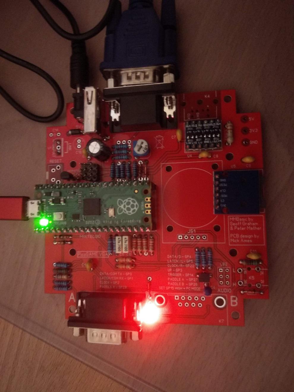

It lives:
It's missing a few bits - I have them but realised I could get it running without.

It is true that energy is expensive, but if you work through the night to get the board working, it is okay to turn on the light when you take a picture....;)
Posts: 9255
Posted: 06:45am 27 Apr 2022
Light? You were lucky! When I were a lad we didn't have light! There was 19 of us all had to get up as soon as it were light enough to see and go to bed when it got too dark to work in't mill any more.
I truly admire his dedication, Volhout. :)
