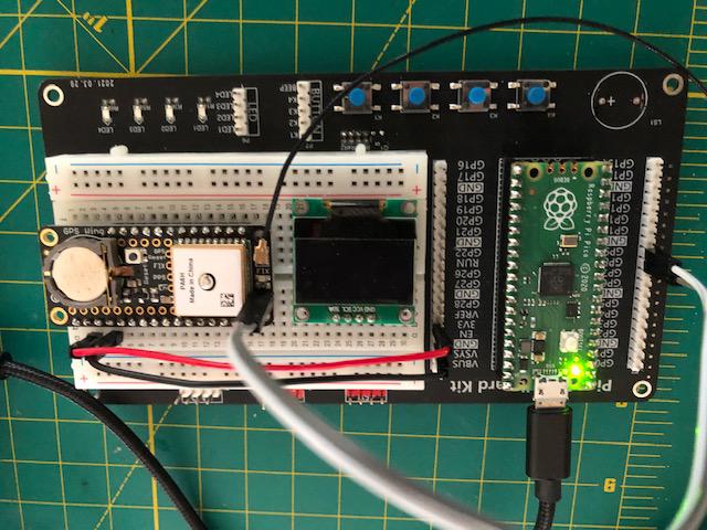

Here's a picture of the PicoMite interfaced with an Adafruit GPS Featherwing. Thanks Peter.

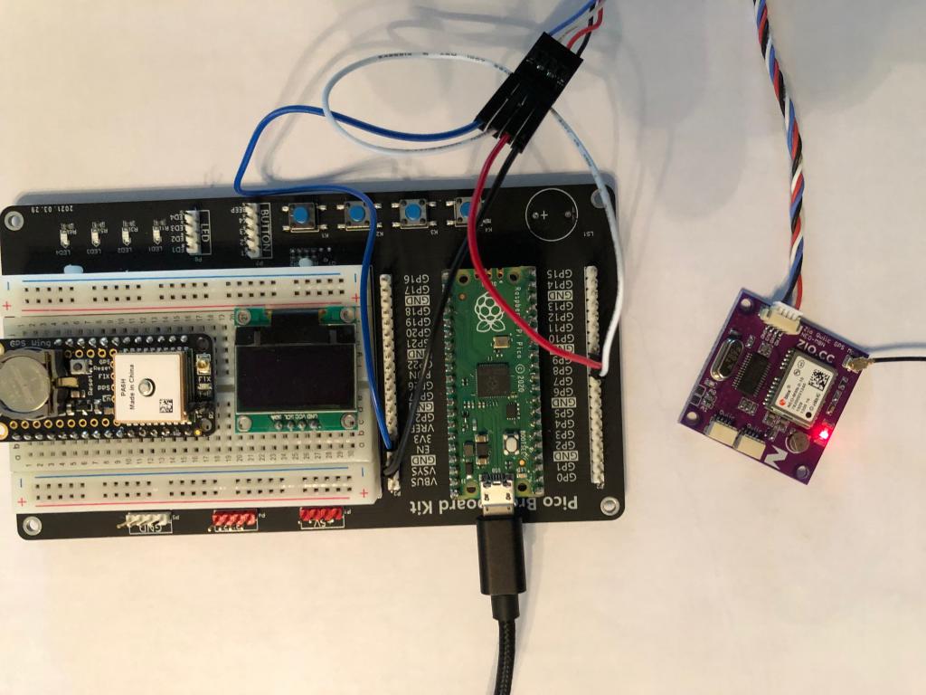

Also works with the Zio Qwiic GPS module.
