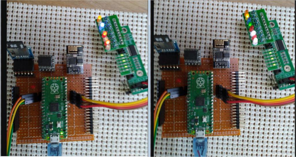

This works for me to flash LEDs on an MCP23017:
' MCP23017.bas
 const mcp23017 = &h20 ' A2, A1, A0, R/W all connected to 0V
 Const i2caddr=mcp23017
 const IODIRA = &h00 ' Port A IO Direction register DEFAULT = I/P
 const IODIRB = &h01 ' Port B IO Direction register DEFAULT = I/P
 const IOCON = &h0A ' IO Expander config register - address &h0B accesses the same register
 const GPIOA = &h12 ' Port A General purpose register
 const GPIOB = &h13 ' Port B General Purpose register
 const OLATA = &h14 ' Port A latch register
 const OLATB = &h15 ' Port B latch register
 const GPUPB = &h0D ' Port B pull-up register
 SetPin 14,i2c1sda
 SetPin 15,i2c1scl
 I2C2 open 100, 1000
 I2C2 WRITE MCP23017,0,2,IODIRA,0 ' set direction to output
 I2C2 WRITE MCP23017,0,2,IODIRB,0 ' set direction to output
'  I2C2 WRITE MCP23017,0,2,GPUPB,&h3f ' set weak pullups on all except bits 6&7
do
 mcp17
loop
sub mcp17
'  I2C2 WRITE MCP23017,0,2,IODIRA,0 ' set direction to output
'  I2C2 WRITE MCP23017,0,2,IODIRB,0 ' set direction to output
 print "write to mcp23017"
 for i = 1 to 6
   I2C2 Write MCP23017,0,2,OLATA,&b10101010 '
   I2C2 Write MCP23017,0,2,OLATB,&b01010101 '
   PAUSE     1000
   I2C2 Write MCP23017,0,2,OLATA,&b01010101 '
   I2C2 Write MCP23017,0,2,OLATB,&b10101010 '
   PAUSE     1000
 Next i
 I2C2 Write MCP23017,0,2,OLATA,0 ' turn all off
 I2C2 Write MCP23017,0,2,OLATB,0 ' turn all off
 pause 1000
end sub
