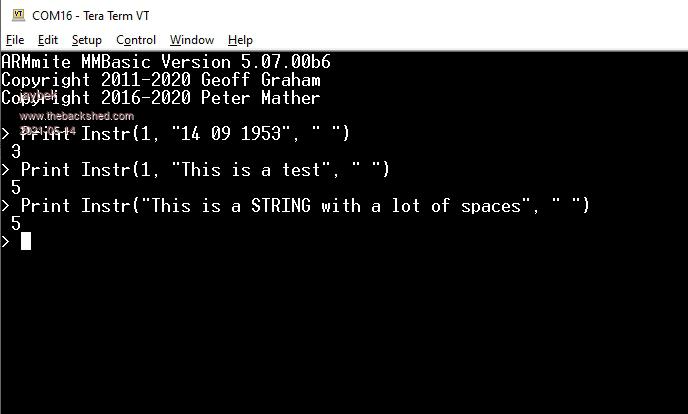

Hey All
I'm running  ArmmiteF4 Version 5.07.00b12, and this looks like a bug to me

What were you expecting to see?
In all three cases the INSTR function returns the position , starting from 1, of the first encountered instance of the search string, in you example, a space.
The third example has omitted the optional start position so defaults to 1 and again returns the first instance of the search string correctly.

The following code will print out all positions in the string to be searched of instances of the search string

  jaybek said  ... this looks like a bug to me...
don't think so. 3rd character, 5th character & 5th character - looks good to me.
throw some wood on the fire - what were you expecting to see?

Yes, You are right. Sorry, but I tried to run the little program from 'Getting Started...' by GG, page 44, and it keeps erroring out. I wrongfully assumed that it was Instr() there were cousin it to fail.
But something weird IS happening in the 'Function GetDays(d$)'.
If you, just before the 'If'-Statement, print out the value of 's1', and the your input data is in the correct format, you will get the value '3'.
And then the next line 'If s1 = 0 Then', -  evaluates True!
I've bin coding in StarOffice Basic (Libre Office, Open Office) for more than a decade, and yes there are diffs, but this is a bit unexpected.

The program works fine - you must have a typo

Sorry, - but I'm obviously a narrow sighted idiot at times:
My glasses has bin missing for a couple of days, and in despair over that i couldn't get such a simple program to run, I yanked it into Libre office Basic, and made the few tweaks that was necessary to make it run, but i did get the exact same error there!!!
Then it was time for a strong cup of coffe and there they were! My glasses (I hate them! The Elves! I've bin looking there several times!! (Sometimes i love them)).
Running the program again (this time without a cane stick) i realized that the input format was 'dd mmm yyyy' and NOT 'dd mm yyyy' witch i'd bin using the hole time, not paying attention to why there was a StringArray of  month-names.
Wow, this is embarrassing. I discovered that I can still blush at my age of 60!
I really DO hope you all can have a good laugh over this, and i haven't caused too much disturbance. A typical 'Error 40'!
