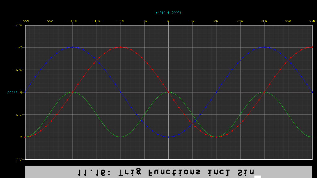

First, I've been playing with the newer video modes, and found an amusing bug since I received the CMM2 a couple of weeks ago with early August firmware: Image captures are flipped vertically.  Here are two BMPs, the first from well before the recent firmware (using mode 9:16), and the latter from after (using mode 11:16).  They display upright, of course, on my LCD display.  The lower one uses OPTION Y_AXIS UP (a potential clue!)
and

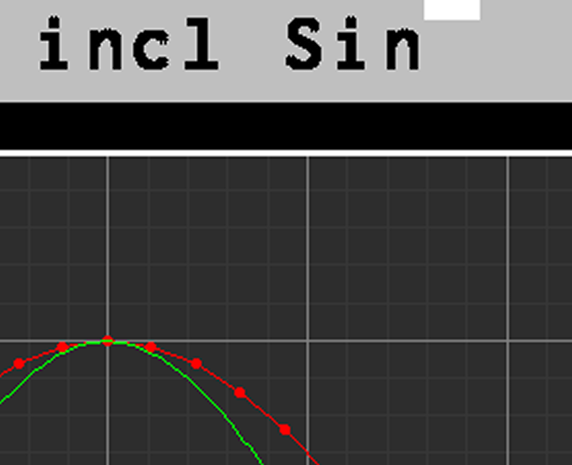

Second, if you take a close look at what should be the upper right part of the title (flipped and enlarged below), you'll see a white box.  I had hoped this would be a Superscript 2 (for Sine Squared).  The documentation shows this as Character &HFD (I included it in the TEXT command with a "STR$(&HFD)" concatenation).
Happy to share the code that generated the plot.

OK - I've narrowed it down a bit.  The superscript 2 (CHR$(253)) works fine in fonts 1 and 4, but doesn't in 2, 3, or 5, regardless of video mode.  Here's a clip of the SAVE IMAGE using Mode 12:
Strangely enough, this image was not flipped vetrically; I had done a power cycle before grabbing this one, and had not (yet) done an OPTION Y_AXIS UP command at the command line or inside a program.
