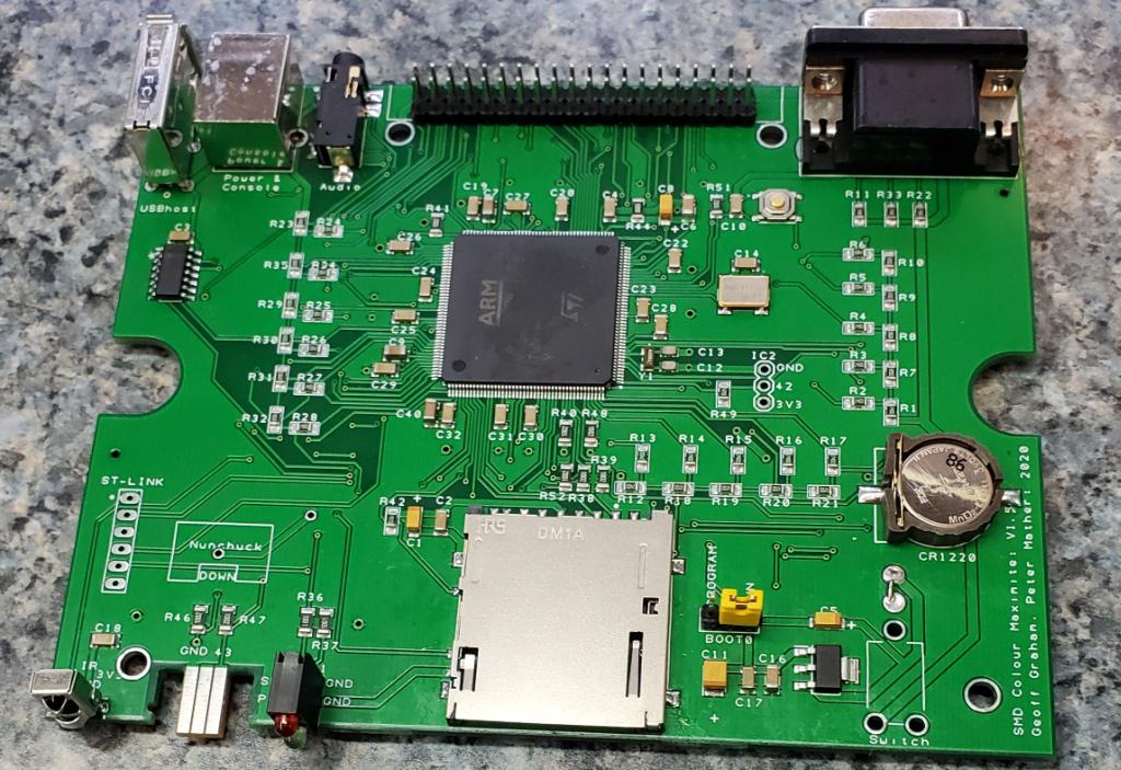

  Quote   At this point the only thing that I can suspect is that the processor chip (rev Y) that JLC is stuffing has bad internal RAM.
Send me a "bad" board and I'll test. Can't see a better solution. Email me direct and I'll let you have my address
This is pretty painful. I have customers waiting for shipments.
I have to make the decision to either refund their payment or ask them to wait perhaps weeks.
WW and Grogster - have you built boards partially assembled by JLC? Do they retain options?

  CircuitGizmos said  I do OPTION LIST and get:
OPTION USBKEYBOARD UK
With battery still in, I type:
OPTION USBKEYBOARD US
After the reset, I type OPTION LIST and get:
It is a Y processor, if that matters.
Interesting that this is the same thing I'm experiencing with my troubled board that I just received from you (as discussed in the main CMM2 topic).
In my case, not only the USBKEYBOARD option not being retained, but also other OPTION settings like the SD TIMING.
ie. OPTION LIST appears to always prints the same unchanged initial 3 lines.
So, although my show stopper problem is not being able to get SD Card functional, this OPTION issue was viewed as the primary problem to focus on / understand.

  CircuitGizmos said
  matherp said
  Quote  Correct me if I'm wrong, but with no battery shouldn't the setting survive the reboot?
No: all settings are stored in a battery backed area in the RTC domain on the chip. Without the battery there is no power to that RAM
I see. I would have thought that the battery is the backup source for that RAM, not the only source.
Someone mentioned that the VBAT jumper on the WaveShare board is needed if you remove the battery.
This coincides with the WaveShare documentation:
VBAT: short the jumper to use system power supply, open it to connect external power, such as battery
ie. It appears you either have a battery connected, OR, you have the VBAT jumper in place, otherwise there would be no power to the RTC / backup?
The boards that I can't get to stick to "US" also cannot access the SD card. They all have 3V batteries and the path from the battery to the processor pin is fine.
The difference is that they are not waveshare boards. They are the version 1.5 board with the surface mount parts put in place by JLC.

  CircuitGizmos said  The boards that I can't get to stick to "US" also cannot access the SD card. They all have 3V batteries and the path from the battery to the processor pin is fine.
Interestingly though, what you just said seems to directly match with the issues I am having with the Waveshare based v2.0 board, that I just received from you!
ie. US option not sticking, and also cannot access SD card!
nb. I also recently noted the repeating key issue after arecent firmware update (I'm about to load the latest to see if that at least goes away).
So, in summary, what you are describing is identical to the issues I'm having on the Waveshare board you sent me.
Exactly! The design is the "same" but the implementation is different.
OPTIONS are stored in this battery RAM. I don't know what else is. That is why I suspect that the RAM isn't right. It's a possibility. Bits stuck either high or low? That RAM is important enough that testing it on powerup might be prudent. It's only a few k.
What else could be wrong? The 'CUBE' programmer? I updated it. Residue? I used Trichloroethane to clean the board and give myself cancer. The big RAM passes the minimum RAM test.
Edited 2020-06-18 08:57 by CircuitGizmos

  GregZone said
So, given that you are having the same problem with some JLC supplied SoC chips, that I'm also having on a WaveShare based CMM2, that would seem to rule out a bad batch of SoC chips (The JLC supplied SoC chips presumably won't be from the same source that you sourced your WaveShare boards from?).
Wouldn't this then point to it being more likley a firmware issue (not a SoC / hardware fault)?
Should we be loading some earlier firmware, to see if the issues go away?
I loaded rc17 (just grabbed an early one) and the same thing happens. This is one that only gives 0=UK and 1=US as options.
No battery installed. I reset it (button), and it didn't ask for keyboard type. So the reset code is different from the power up code? Not having the battery in there should have had it ask again for keyboard type...

Posted: 11:28pm 17 Jun 2020
Here is V2.1
https://www.c-com.com.au/stuff/cube21.zip
There could be something to do with a combination of chip revision and cube version.
We had some issues with saving options between versions during development.
V2.1 works OK for both my V and Y Waveshare boards.
Re battery backup
Pressing reset with power still applied but no battery will retain settings.
Battery only comes into play with power removed.
