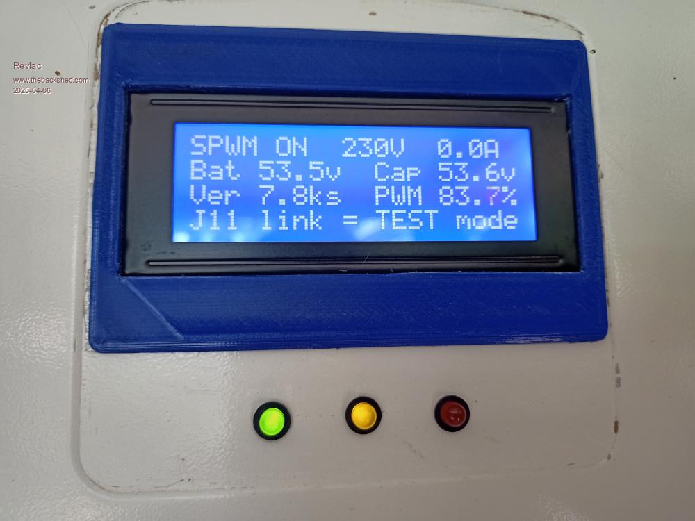

The 5V voltage regulator that was getting a bit hot, after much checking, everything else was working as it should be, just that the LCD was using a little too much from the 5V regulator (in a box with no airflow) so a little mod was suggested by Wiseguy,
"we can cut the track on the bottom side of the LCD +5V pin heading towards pin14 of U6 (HC86).
If we feed a seperate 5V supply to the +5V LCD pin (and the 2 x LED buffer chips still connected to the LCD +5 pin) it will solve the problem."
I also had to fit a 5V rail monitor to the LCD PCB, or it will corrupt the nano first time power is turned off.....I had to find out.
Testing has gone well, and it uses a little less power than before just running from a lab power supply, likely because its not wasted in heat.
I ended up changing the Nano I had and put in an older Nano I had, seems to work better with the computer and has the bigger USB socked than the other one, will use it for running an LCD easy job for it.

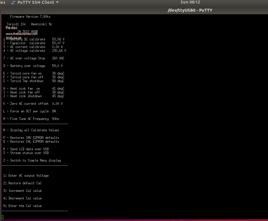

Now I did some of the Calibrations this morning using PUTTY on the Ubuntu PC (the Windows one still not happy) it works a bit like Tera Term, but haven't figured it out completely yet, when selecting menu items it will scroll down the list to where it should, but I couldn't enter the battery calibrations, typing in the new value, it had a flashing courser but no numbers appeared when typed, will probably sort that out later, but no problem I used the increment and decrement a few times and it worked a treat......All Good.
Voltage is good.
Still more work to be done, I should do the mod and remove the diode etc under the Nano controller, The Contactor jumping off and back on again, quite a surprise when not expecting it.

Posted: 09:59pm 07 Apr 2025
  Quote  when selecting menu items it will scroll down the list to where it should, but I couldn't enter the battery calibrations, typing in the new value, it had a flashing courser but no numbers appeared when typed, will probably sort that out later, but no problem I used the increment and decrement a few times and it worked a treat......All Good.
Make sure "Local echo" is selected in the Terminal Setup application, you want the Terminal Program to show the keystrokes that you type.
BTW The latest version of the CODE is Version 8, the Latest changes.txt has the changes. Mainly LCD display corrections under certian fault conditions and a lot more info and index links added to the "Nano Hex and Menu.pdf"

Revlac
Joined: 31/12/2016
Posts: 1309
Posted: 12:48pm 08 Apr 2025
Ok PuTTy Local echo and Local line ending was on auto,    Changed Both to Forced ON, looks like that will do the job, works on the other computer will try it later, still have to calibrate the Amperage as I hadn't done it yet, I run the Hot water system for a few hours today and could see it was out a bit.

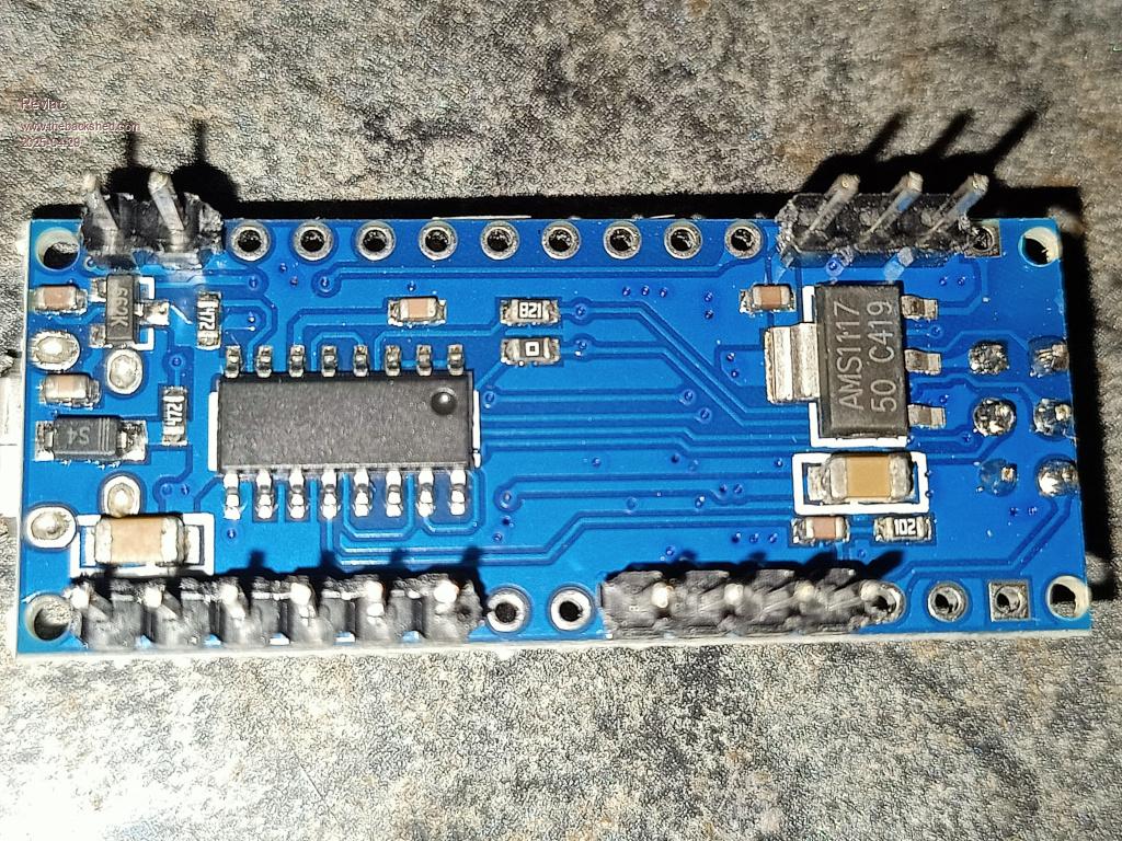

Posted: 10:29pm 18 Apr 2025
I have modified a couple of Nano's following the instructions (nicely done easy to follow) KeepIS has posted, and the Nano running the inverter works as it should, no interruptions when using the USB port, what I did find, I have at least 3 different Nano's.
The first Nano I had running the inverter, had some trouble with the usb driver on windows (posted earlier) it was the last batch of nano's bought it appears that they were the same as the last one in the Nano round up (Nano Board Info) and cannot be modified, so I had already decided to use them for the LCD duties before finding out about this, all is good.
The other Nano's some are CH340P and others CH340PB as identified by AVRDUDESS, working no problems at all.

KeepIS
Joined: 13/10/2014
Posts: 2284
Posted: 11:56pm 18 Apr 2025
Thanks for posting your results, it's nice to know the Info was easy to follow and even better, the USB port can no longer upset a "running" Nano Inverter in ANY way.
A good test would be to try one extra turn of heavy input cable to see how it effects the Duty cycle. Great to see its been running for a few days now.

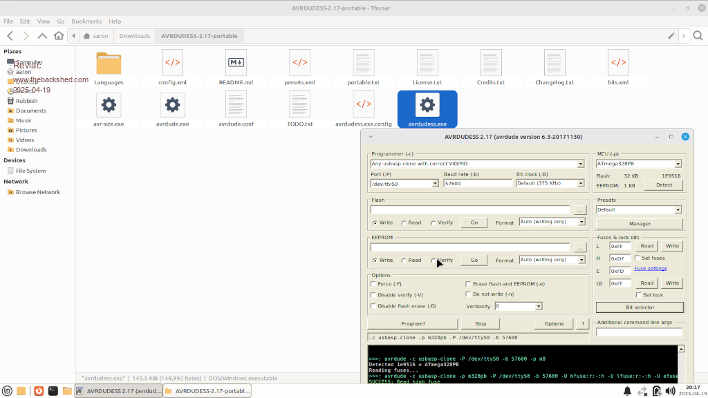

Posted: 10:44am 19 Apr 2025
I may have to put this some wear else but will start it off anyway.
FOR those who want to use Linux Mint and AVRDUDESS to program the Nano.
I think mab1 might be interested?
I did get some info from here https://github.com/ZakKemble/AVRDUDESS
Tried a few things but didn't quite get it working yet.
The package that KeepIS posted earlier had a portable version.
Not sure how I got it working or it was working before and I only just noticed.
Screenshot, looks like it will work.
Also the version of Mint I used did not have the CH340 driver package installed, talk about that solution later if needed.
Cheers Aaron

mab1
Joined: 10/02/2015
Posts: 287
Posted: 07:47pm 19 Apr 2025
Thanks revlac,
I tried keepis's zip version on the imac
and got: "Microsoft windows applications are not supported on os x"
I also found my way to the github page you referenced and downloaded averdudess 2.18 portable.zip ("portable for any OS") onto the imac - unpacked and got exactly the same error message . Just wondering if I'm doing something stupid
I have also tried keepis's zip version on win xp and it runs   , but then I saw the red error message in the box   :
">>> Averdude.exe
ERROR: unable to start process. The specified executable is not a valid Win32 application"
So I'm not sure what to try next
Edit: following your linky takes me to a different Github page - will try and pursue the imac route...

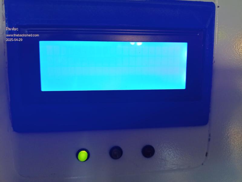

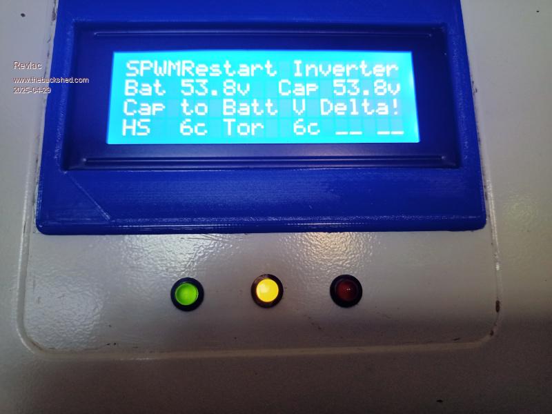

Well it was interesting this morning, Inverter output stopped somewhere between 1:00AM and 8:00AM, absolutely nothing running at all,  used some power last night but battery capacity would have been over 90%.
So I restarted the Inverter and it fired up until about the time the output relay turned on (give or take a few seconds) and noticed the LCD go blank, cant tell exactly when it went blank before taking a photo, the rest of the Inverter was running ok and output voltage was all good.
Restarted again thinking I will get a short video of it, but no its working perfectly now.
I still haven't upgraded the main Nano from 7.8Ks to the latest HEX code yet, I have one done and put it somewhere.
Cheers Aaron

KeepIS
Joined: 13/10/2014
Posts: 2284
Posted: 12:35am 29 Apr 2025
Are you running the latest version ?
I had that situation out of the blue a few days ago, that's the reason for VER 8.1.
I make sure it's a Delta error before stopping SPWM and requesting a restart.
EDIT: Does the LCD have a boot loader? does it have the USB Reset Cap removed?
BTW Mine also happened in the middle of the night with virtually no load, after 8 months of almost 24-7 run time.
I know how it could happen on that one trip point, the fact that it happened once after all this time is a testament to the great stability of the ADC inputs and the little Nano in general, along with the quality of the controller PCB design
Edited 2025-04-29 11:17 by KeepIS
Revlac
Joined: 31/12/2016
Posts: 1309
Posted: 10:58am 29 Apr 2025
Now running VER 8.1, on a different Nano, seems to make a slightly different transformer hum starting up, will run tomorrow as I had to put up with some noisy machinery today.
The battery and capacitor values have been within .1volt all the time and remain strong under load.
The LCD Nano has no bootloader, but the USB Reset cap might still be in place, don't know which cap it is on this nano.......(see photo)
I'm sure we will learn more as more Inverters are built and running in the field, different builds and running different appliances.....makes it interesting.
Its been running good all day and only just completed the calibration (VER 8.1 on the new Nano) tonight, using Linux Mint and PuTTY SSH Client Terminal.
Cheers Aaron
