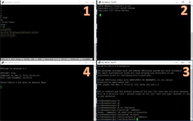

1) start minicom on /dev/ttyAMA0 (I connect on UART0 of raspberry a Micromite), you can see, I'm editing code on micromite on UART0<-->MICROMITE console.. OK!!
2) start pi-mmbasic, run a simple code. OK!!
3) quit from pi-mmbasic. OK!!
4) try to start again minicom on /dev/ttyAMA0, UART0 not answer. NO!!!
I tried to go out and go back to minicom. nothing to do. The only solution is to restart raspy.

As I said in my previous post. Something in the boot up sequence is setting the pins to UART mode which is an alternate setting. PIGPIO is setting them to standard digital I/O. When MMBasic exits it leaves all the pins as digital inputs i.e the only guaranteed safe mode - exactly the same as the Micromite. To solve this you need to find the boot code that does the setup and then run it after you exit MMBasic.

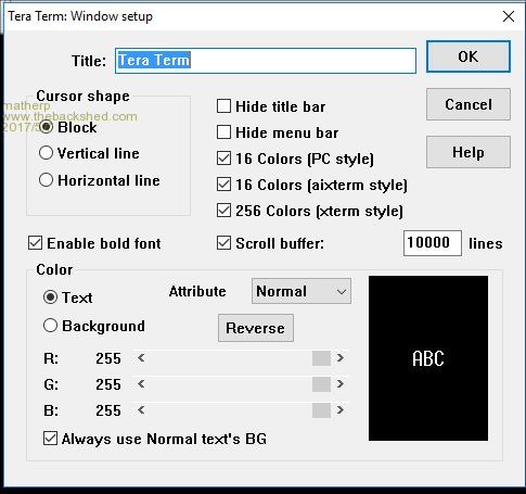

Jim: I don't know why you aren't seeing colour in Teraterm. This is my configuration

Posted: 07:44pm 07 May 2017
I still can't get colour using teraterm.
Putty is OK so it's not mmbasic or the Pi settings
With TeraTerrm I get colour from other micromites and 'some' colour from the Pi's command line.
That is 'some' but not as much as when using Putty.
I can't see any obvious setting in TeraTerm but it must be the way it negotiates it's capabilities with the PI when first connecting. I can monitor things if I connect using Telnet but not with SSH.
Can you send me a copy of your TERATERM.INI file and I will try and find where the difference is. It's starting to bug me.

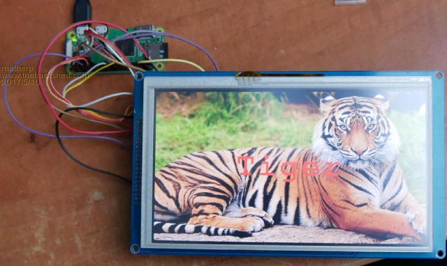

This includes a bit of tidying up and also full support for the SSD1963 displays (not though as a console)
pinout is:
SSD1963_pins
SSD1963_WR_PIN 32 //GPIO 12
SSD1963_RS_PIN 13 //GPIO 27
SSD1963_RESET_PIN 31 //GPIO 6
SSD1963_DAT1 35 //GPIO 19
SSD1963_DAT2 38 //GPIO 20
SSD1963_DAT3 40 //GPIO 21
SSD1963_DAT4 15 //GPIO 22
SSD1963_DAT5 16 //GPIO 23
SSD1963_DAT6 18 //GPIO 24
SSD1963_DAT7 22 //GPIO 25
SSD1963_DAT8 37 //GPIO 26
Option syntax and all GUI/drawing commands are exactly the same as the MM+ and MMX
e.g.
OPTION LCDPANEL SSD1963_7,RL,,33
In this example pin 33 is used for RD to allow transparent text and BLIT to be used.
Performance on a Pi 3 is reasonable (Image Load is very fast). Somewhat slower on a Pi-zero (800x480*24 image loads in 0.873 seconds)
