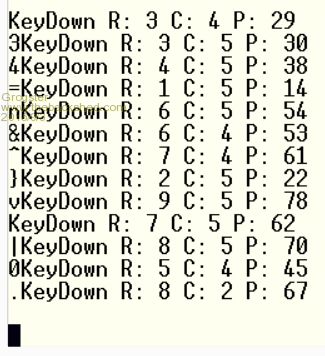

EDIT - Updated test results:
NO RESPONSE at all from the \ button, 2nd to the right of the spacebar.Edited by Grogster 2015-09-04

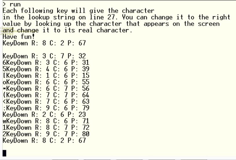

Hmmm. That is exactly the same output.
Still miss keys. I hope there is not a mistake in the matrix.
Can you change this line:
[code]DIM Matrix.KeyDown.Debug = 0 'DEBUG[/code]
to this:
[code]DIM Matrix.KeyDown.Debug = 1 'DEBUG[/code]
It will then print a line with the row and column numbers.
Maybe that helps pin down which ones are missing.

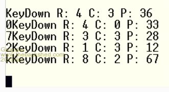

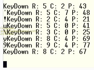

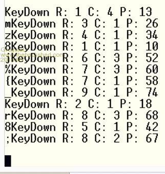

Posted: 03:45am 03 Sep 2015

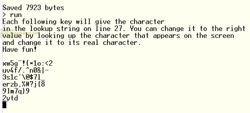

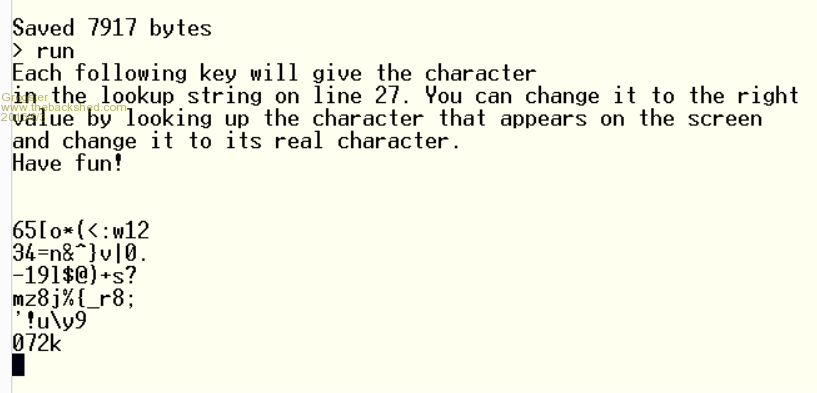

RESULTS:
ESC-F12, left to right:
TAB-Delete, left to right:
Caps-Enter, left to right:
LShift-RShift, left to right:
Fn-\, left to right:
Left,Up,Down,Right arrows:
Note that I pressed ENTER at the end of each row, to get a line on the TT screen, so I knew where to crop the screen grabs.......
Unless you actually WANT to do all the work to get this running right, you could just ignore it at this point, as my IF/THEN code works fine, it is just not that efficient and can't handle up/down code etc, but for my purposes, that is not needed anyway.Edited by Grogster 2015-09-04
Posted: 03:55am 03 Sep 2015
Ah i see the mistake.
change in de subroutine this line:
[code]P = row * 8 + col + 1[/code]
into
[code]P = (row - 1) * 8 + col + 1[/code]
I am learning a lot to decode a matrix and handle all the shift/ctrl, more than one key issues etc. I am happy you actually have some hardware to test it on.:)
Edited by TZAdvantage 2015-09-04

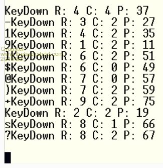

RESULT:
The \ key is now producing a result.
ENTER position changed to a + character, so I made that zero, reran the code, and it has move to 59 - is that OK?
How are we progressing now?
Posted: 04:09am 03 Sep 2015
That is much better.
I'll send you a Lookup string within a few minutes so that all the keys return their right character (without shift/control/caps/fn etc for now).

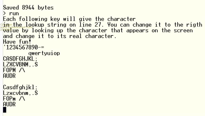

Posted: 03:20pm 03 Sep 2015
New code acknowledged. I will try this out later today, and let you know.
Posted: 04:55pm 03 Sep 2015

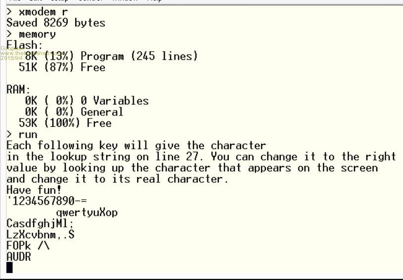

RESULTS:
Posted: 05:22pm 03 Sep 2015
Ok that still needs a small tweak in the Lookup string.
[code]
DIM Matrix.Lookup LENGTH 72 AS STRING = "XcdRLe3XX,lXPu9X zaDTq1`UxsACw2XmSFXBXXOgXfvtr45hnjbyo76X;E./p0-XmkX\i8="
DIM Matrix.LShift LENGTH 72 AS STRING = "xCDxxE#xx<LxxU(x ZAxxQ!~xXSxxW@xMxxxxxxxGxFVTR$%HNJBYO&^x:x>?P)_xMKx|i*+"
[/code]
I am working on the capslock and shift.
You can also try to use more then one key.
I do not have a protection against ghosting so it should only work with 2 key rollover.

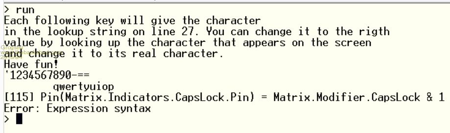

Posted: 05:31pm 03 Sep 2015
I have a test version for the capslock. Also the LED should work.
I have to go take a nap, worked all night.
Some idiot at the Telecom company screwed up and made 800 of my customers SIMs disappear. All hell broke loose and i am in need of some rest.
While waiting for their repairs,which still are not ready i had time to fiddle with the code bit.

END SUB
SUB Matrix.SetRow(row)
LOCAL integer Value = 0
if row > 0 then Value = 511 - (2 ^ (row-1))
PORT(2,6,9,2,25,1) = Value
END SUB
FUNCTION Matrix.ReadCols()
'Column pins 15,16,17,21,22,23,24,26
Matrix.ReadCols = 255 - PORT(15,3,21,4,26,1)
END FUNCTION
SUB Matrix.Scan()
LOCAL integer Row
Matrix.ScanCount = Matrix.ScanCount + 1
if Matrix.ScanCount = Matrix.REPEATRATE then
Matrix.RepeatKeys
Matrix.ScanCount = 0
endIF
IF Matrix.State = 0 then
Matrix.SetRow 0
Matrix.State = 1
ENDIF
if Matrix.State = 1 then
Matrix.FirstScan = Matrix.ReadCols()
Matrix.State = 2
exit sub
endif
if Matrix.State = 2 THEN
Matrix.ScanCode = Matrix.ReadCols()
if Matrix.FirstScan <> Matrix.ScanCode then
'Unreliable scan values detected
Matrix.FirstScan = Matrix.ScanCode
EXIT SUB
ENDIF
if Matrix.ScanCode = 0 then
Matrix.ReleaseKeys
Matrix.State = 1
exit sub
endif
'Scan the whole matrix
for Row = 1 to Matrix.NumberOfRows
Matrix.SetRow(Row)
'Maybe need a tiny delay to allow for correct read
Matrix.Current(Row) = Matrix.ReadCols()
next
Matrix.ProcessScan
RepeatKey = 0
Matrix.State = 0
EXIT SUB
ENDIF
'Should never end up here.
'If it does then reset state
Matrix.State = 0
RepeatKey = 0
END SUB
SUB Matrix.ReleaseKeys()
LOCAL Row,Col
'release ALL keys
if Matrix.Prev(Row) > 0 then
for Col = 0 to Matrix.NumberOfCols
if (Matrix.Prev(Row) AND (2 ^ Col) ) > 0 then
'If the key was pressed previous scan then release it by calling keyup
Matrix.KeyUp Row, Col
endif
next
endif
Matrix.Prev(Row) = 0
next
end SUB
SUB Matrix.ProcessScan()
LOCAL integer Row, Col, Changes
Changes = Matrix.Prev(Row) XOR Matrix.Current(Row) ' every bit that changed will be 1
if Matrix.ProcessScan.Debug = 1 then print "Prev:"Matrix.Prev(Row)"Cur:"Matrix.Current(Row)"Changes" Changes; 'DEBUG
if Changes > 0 then
P = 2 ^ Col
'if Matrix.Debug = 1 then Print P;
if (Changes AND P) > 0 then
if (Matrix.Current(Row) AND P) = 0 then
else
Matrix.KeyDown Row, Col
endif
endif
next
endif
if Matrix.ProcessScan.Debug = 1 then print 'DEBUG
Matrix.Prev(Row) = Matrix.Current(Row)
next
end SUB
SUB Matrix.KeyDown(row, col)
LOCAL Key$, K, P
if Matrix.KeyDown.Debug = 1 or Matrix.EnterPosition = 0 then 'DEBUG
print "KeyDown R:" row " C:" col " P:" P 'DEBUG
endif 'DEBUG
if Matrix.EnterPosition = 0 then 'DEBUG
Matrix.EnterPosition = P 'DEBUG
POKE VAR Matrix.Lookup, Matrix.EnterPosition , Matrix.Key.Enter 'DEBUG
print "Enter key has been set. Its position is" P 'DEBUG
print 'DEBUG
PRINT "Change the code on line 22 to:" 'DEBUG
print "DIM Matrix.EnterPosition ="P 'DEBUG
print
print "Stopping program. Use Edit or MMEdit now" 'DEBUG
print "To change the code." 'DEBUG
END 'DEBUG
endif 'DEBUG
Key$ = MID$(Matrix.Lookup, P, 1)
K = ASC(Key$)
IF K = Matrix.Key.CapsLock then
Matrix.Modifier.CapsLock = NOT Matrix.Modifier.CapsLock
UpdateIndicators
endif
IF Matrix.Modifier.CapsLock = 1 then
if K >= ASC("a") and K <= ASC("z") then Key$ = Ucase$(Key$)
ENDIF
if Matrix.Output.Mode <> Matrix.Output.Modes.RAW then
if Key$ = chr$(13) then Key$ = Matrix.Output.Key.Enter
'more to add later
endif
Matrix.Buffer$ = Matrix.Buffer$ + Key$
END SUB
SUB Matrix.KeyUp(row,col)
if Matrix.KeyUp.Debug = 1 then print "KeyUp R:" row " C:" col 'DEBUG
end SUB
SUB Matrix.RepeatKeys()
LOCAL A = 1
END SUB
[/code]

Posted: 12:22am 04 Sep 2015
RESULT:
Posted: 12:25am 04 Sep 2015
Oh boy. I am in C writing mode today.
The & should be AND in basic. How dumb was that. :)
The next line has the same.
Posted: 12:30am 04 Sep 2015
RESULT:
I went back and pressed CAPS again at the end of the first test, then repeated those rows. Seems to be handling the CAPS LOCK key OK. No CAPS LED at the moment, but when you get time.....
EDIT: Any reason you are using upper-case character for the control keys, rather then using non-printable control codes? I was using mostly codes from 00 to 1F for special control keys. These are non-printable character codes.
If you press CAPS LOCK, then F, you will get an 'F', and is the connected MCU not going to have a hard time deciding if this is an 'F' or a 'Fn' code?Edited by Grogster 2015-09-05
Posted: 01:28am 04 Sep 2015
The CapsLED should have worked. I'll check....
Ok i forget to use setpin.
You can add the following lines starting at line 91 right after the pins for the rows and cols are set:
[code]
'Setup CapsLock and Power pins
SETPIN Matrix.Indicators.CapsLock.Pin, DOUT
SETPIN Matrix.Indicators.Power.Pin, DOUT
[/code]
I used readable character because i use a lookup string.
All keys pressed will be lowercase because it is still unmodified.
A capital letter is easy to add to the lookup string as it is just text.
Otherwise the lookup string would need a lot of +CHR$()+ and that will make it long and difficult to read.
So in the case a key is pressed it is looked up. If it is a special key (A-Z) then that needs to be processed and will not result in a character being send.
Once a shift is detected then the second lookup string has all the shifted values. These are all capital letters and special characters. A small x is invalid so i can test for that and not output anything if the combination is not allowed.
At the end none of the capital letters in the first lookup string will reach the output.
The Fn key will not output anything by itself. For instance if you hold Fn and press 3 then the code for F3 will be send. (This still needs to be done).
Edited by TZAdvantage 2015-09-05
