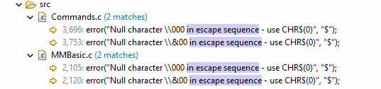

Since the new parameter type // has been added to the error() message format the errors for trying to use  //000 and /&00 to represent a Null character are being formatted as integers.
e.g.
  "Null character 0&00 in escape sequence - use CHR"
  "Null character 0000 in escape sequence - use CHR"
  "Null character 2007AEA7&00 in escape sequence - use CHR(0)"
  "Null character 80000000000 in escape sequence - use CHR(0)"
Suggested this new error message is used in place of the current error message at the locations below. i.e. don't included the //000 and /&00 which are being formatted.
if(i==0)error("Illegal escape sequence, use CHR$(0) for the Null character","$");
