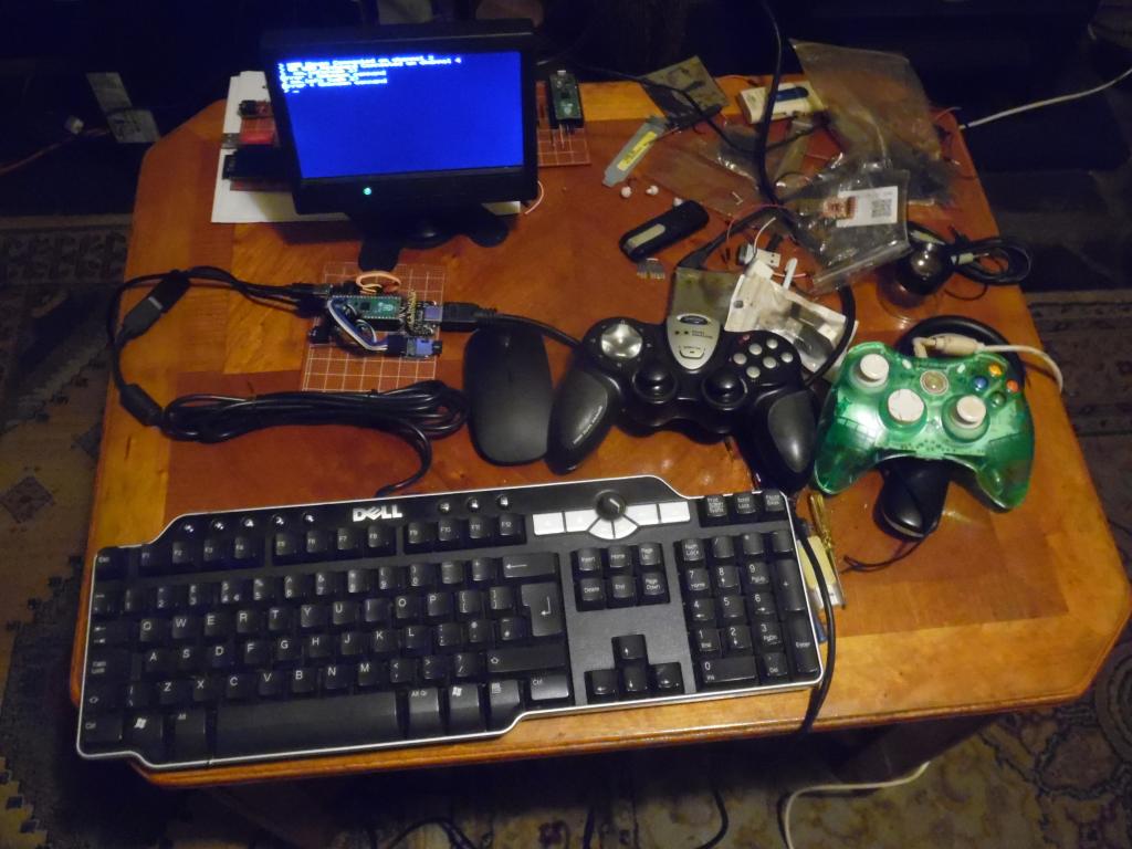

why does MM.INFO(USB 1) say unknown command?
I dug out an old keyboard with 2 usb sockets, plugged a wireless mouse in and it's detected but not the the controllers, are these generic?
Edit my bad it's print mm.info(usb 1). returns 1. sorry

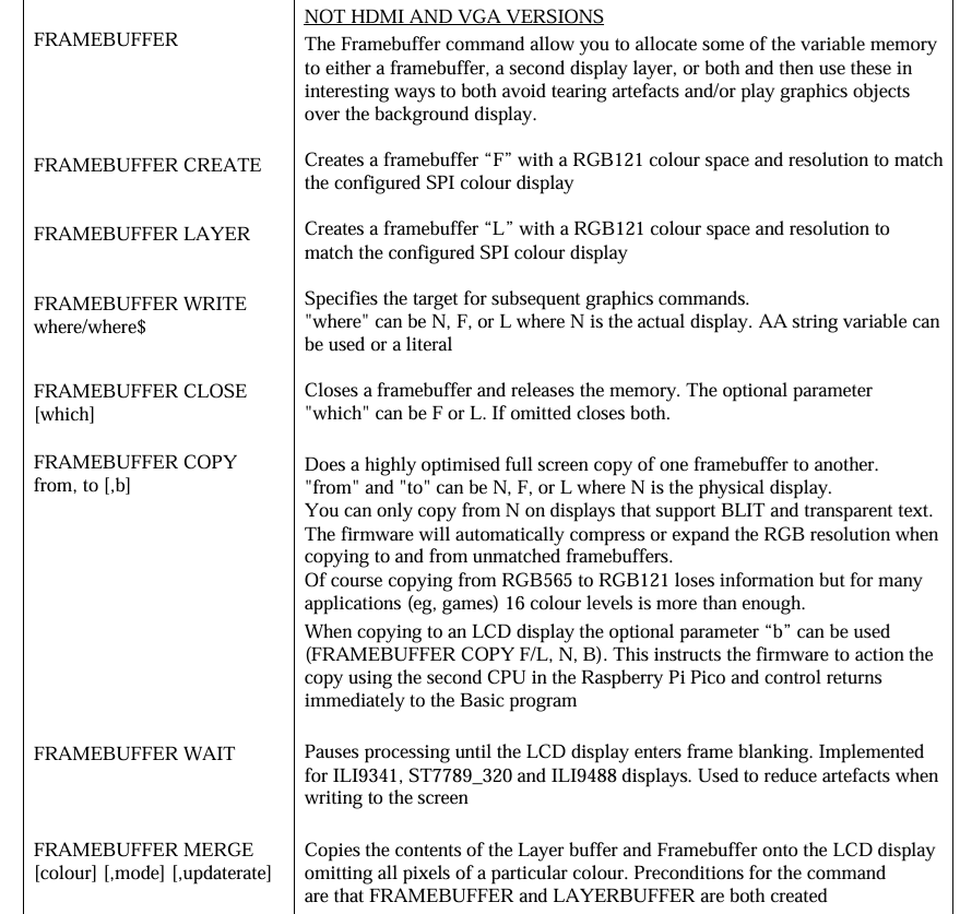

Something for Geoff (I'm not sure if this has been mentioned yet),
Manual (Ver 6.00.03) page 85 says:
MM.INFO(EXISTS FILE fname$)
Returns 1 if the specified file exists, returns -1 if fname$ is a directory, otherwise returns 0.
That's incorrect. The correct description would be that directories return 0 (for V6.01.00b5).
Note: It would be desirable/easier if it worked as described. This means the code, not the manual, should be changed. IMHO.
Kind regards
Michael
Edited 2025-09-01 20:02 by twofingers

Posted: 01:46pm 01 Sep 2025
V6.01.00b11
PicoMiteV6.01.00b11.zip
FRAMEBUFFER SYNC will now work with FRAMEBUFFER COPY. In addition if used before a copy or merge is issued it will time out and return after 100mSec with no error.
MM.INFO(EXISTS FILE fname$) now conforms to manual
Max filename/pathname increased to 127 characters for RP2350 versions except WEBMITE.
Additional error checking included so that file/pathnames > than the maximum should give a standard MMbasic error rather than crashing.

Posted: 08:56pm 01 Sep 2025
Is it for hdmi or lcd?
Posts: 9246
Posted: 06:43am 02 Sep 2025
LCD only, I think. It prevents image tearing.
Posts: 6198
Posted: 08:15am 02 Sep 2025
Stan,
On VGA and HDMI the screen memory (FRAMEBUFFER N) is inside the pico. And also the FRAMEBUFFER LAYER memory is inside the pico. The VGA/HDMI shows L overlayed on N automatically (assuming you have FRAMEBUFFER L enabled). The overlaying is part of the video driver, and happens real time when generating the video data that is put on the HDMI/VGA cable.
On an LCD screen the FRAMEBUFFER N is actually inside the LCD itself, so overlaying L is very slow (via SPI get pixel data from the LCD, combine it with data in L, and SPI write it back to screen). The trick that is used is to create a "virtual" framebuffer in memory (FRAMEBUFFER F) and the same overlay FRAMEBUFFER L. The FRAMEBUFFER MERGE command (for LCD's only) merges the RAM values in F and L, and blasts that at maximum speed to the LCD. So the LCD is not read, it is only used as an output device when this happens. This is much faster, and allows to use the LCD for video games.
