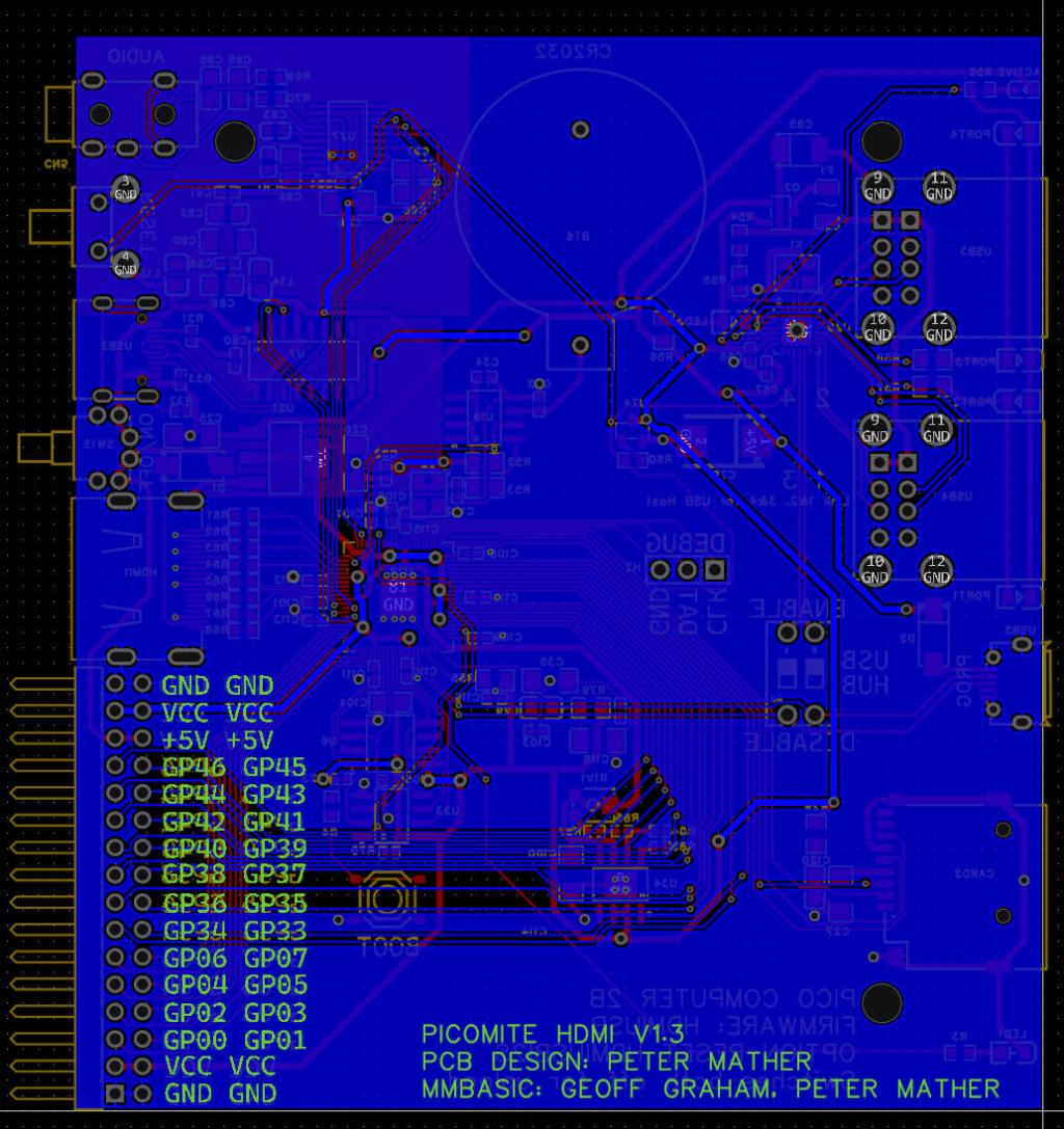

Coming soon
not routed yet and component placements may change but you get the idea
Posts: 3871
Posted: 02:49pm 04 Mar 2025
Nice. Your silk screen has GP37 twice.

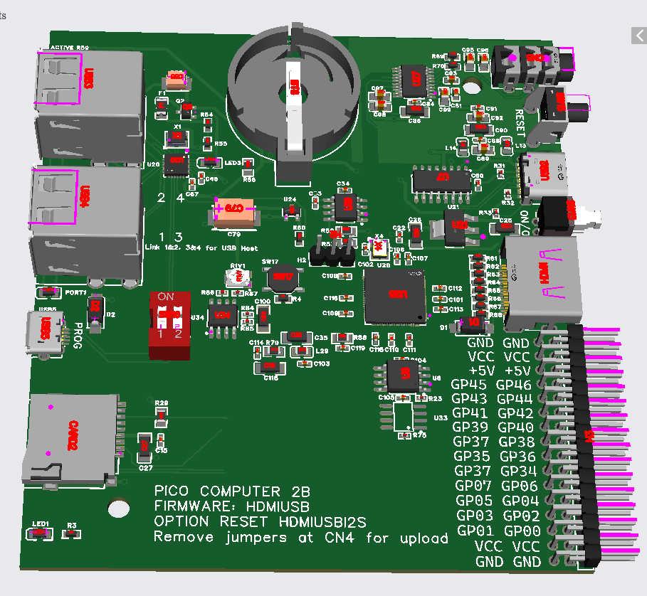

- silkscreen text: "jumpers at CN4" refer to a switch ?

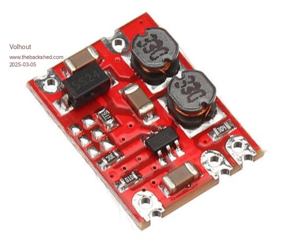

- Would it be an option to add a buck/boost for the 5V ? You have suggested multiple times that a "good USB-C" cable is needed. Not for communications, but for voltage drop on the power conductors. A buck/boost convertor would guarantee adequate 5V for the attached 4 USB devices, even when the voltage on the USB-C drops to 4V.
Something like this (but then put on the board, not as a module). With proper design you could even make this compatible with 12V/20V on USB-C (with a fast charger).

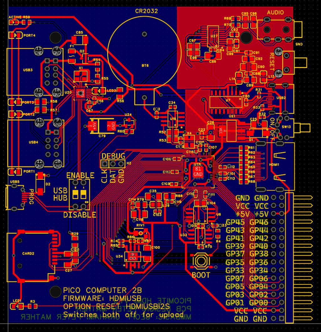

Schematic
ddf6cc27-0325-48cc-9c50-870099aae8e6.pdf
Routed versions
Edited 2025-03-05 18:57 by matherp

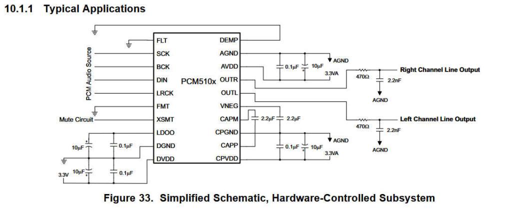

On the PCM5102: it has a charge pump build in (creating a negative voltage). It does that by chopping the 3.3V. Why do you power the chopper input pin to analog Vdd and analog ground ? It is the most noisy in the whole audio circuit. Is this what the datasheet tells you ?

The datasheet explicitly shows the charge pump with the same supply as the analog circuitry

I've just modified a 3V3 version of one of those little S09 buck/boost converters to 5V by changing the feedback resistor to 150K (I don't happen to have any 5V ones). I have it powering my PicoGAME HDMI with wireless keyboard, two generic gamepads and a SD card. Barely warm hanging in free air and the output voltage has barely dropped from the off-load voltage.
103mA drawn from a 12V supply to the convertor, 169mA at 7.5V. My little 300mA power supply is shutting down when I try lower voltages, which makes sense, I think.
Watch out for a new "portable" design with 3-15V (well, that's what they say) input. :)
