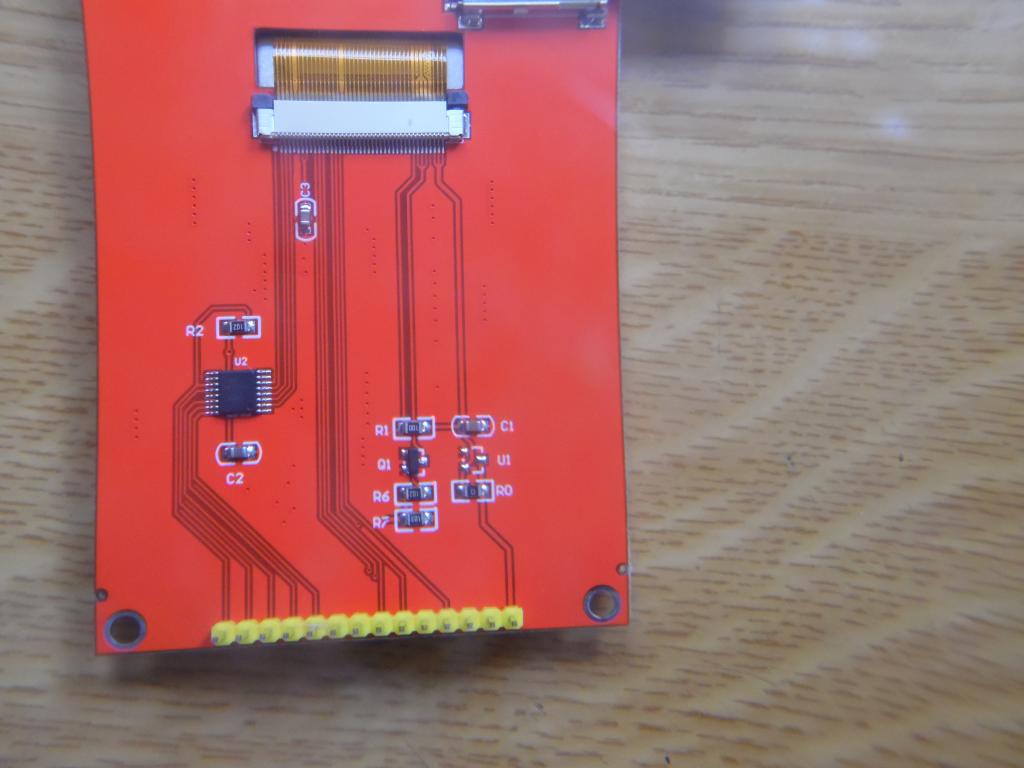

  Quote   Is the BL 3.3v only.
The whole panel is 3.3V only. The 3.3V regulator (U1) has not been fitted and is bypassed by a link (R0).
The backlight anodes go to Vdd (Pin 1) via R1 (10Ω) and Q1 switches the cathodes to ground. The base goes to BL pin via R6 (1kΩ) and to ⏚ via R7 (10kΩ).
The old 2.8" ILI9341 don't have Q1, the LED anodes go direct to LED pin and cathodes direct to ground so they require an external resistor to limit the current.
I inadvertently plugged the 4" panel into a 5V board without any damage but SD cards are damaged by 5V, fortunately did not use one.
To use the 4" panel on a board that has 5V on Vdd remove R0 and install U1 (3.3V LDO regulator).
Edit. Followed my own advice, added a regulator as above.
Now running on 5V.

@phil99 what regulator did you use. I have identified the IN pad one should be GROUND and one OUT, I cant identify the ground pad.
Also I guess these displays can't be used with the MM BackPack because the PWM signal to the backlight is 5v.
Edited 2024-04-10 14:23 by palcal
Posts: 3417
Posted: 05:06am 10 Apr 2024
The regulator was salvaged from a dead 2.8" panel and doesn't have a recognisable type number. Too small for that.
Looking at the 4" panel with SD socket top left and connector pin 1 (Vdd) top right which goes to the middle (top) pin of the reg. Connector pin 2 ⏚ goes to bottom left of the reg. Bottom right of the reg. is 3.3V out and goes to C1 and R1.
The 1kΩ base resistor of Q1 is high enough to allow 5V PWM. Just 4.4mA max at 5V.

I've searched Element14 and RS Components but can't find any with the correct footprint. I have some SMD regs I can probably wire in somehow but would like to do it properly.
@morgs67 what one did you order.
palcal
Joined: 12/10/2011
Posts: 2053
Posted: 07:19am 10 Apr 2024
It's taken me over an hour but I finally found one at RS components
MCP 1754-3302CB its 150ma, should be ok.

Modified my Pico backpack to supply display with 3.3v.  The 4" display that stopped working on 5v. is now alive again and calibrates ok. Now to test on MM2 with 3.3v.
On the MM2 the 3.5" screen won't calibrate I get Touch Hardware Failure after two targets and it won't calibrate on the Pico so maybe a display fault.
So my 4" screens now work and calibrate on both Pico and MM2.
