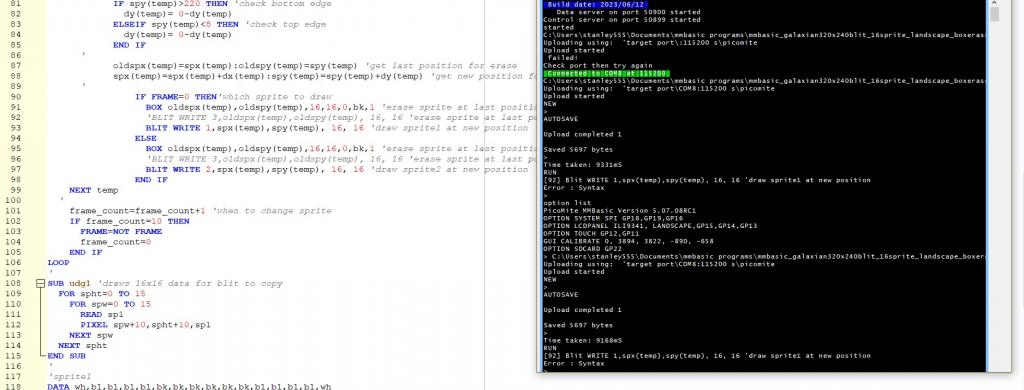

Using V5.07.08RC1 and getting blit error I did not get before. Has it changed?
Edited 2023-10-28 04:00 by stanleyella

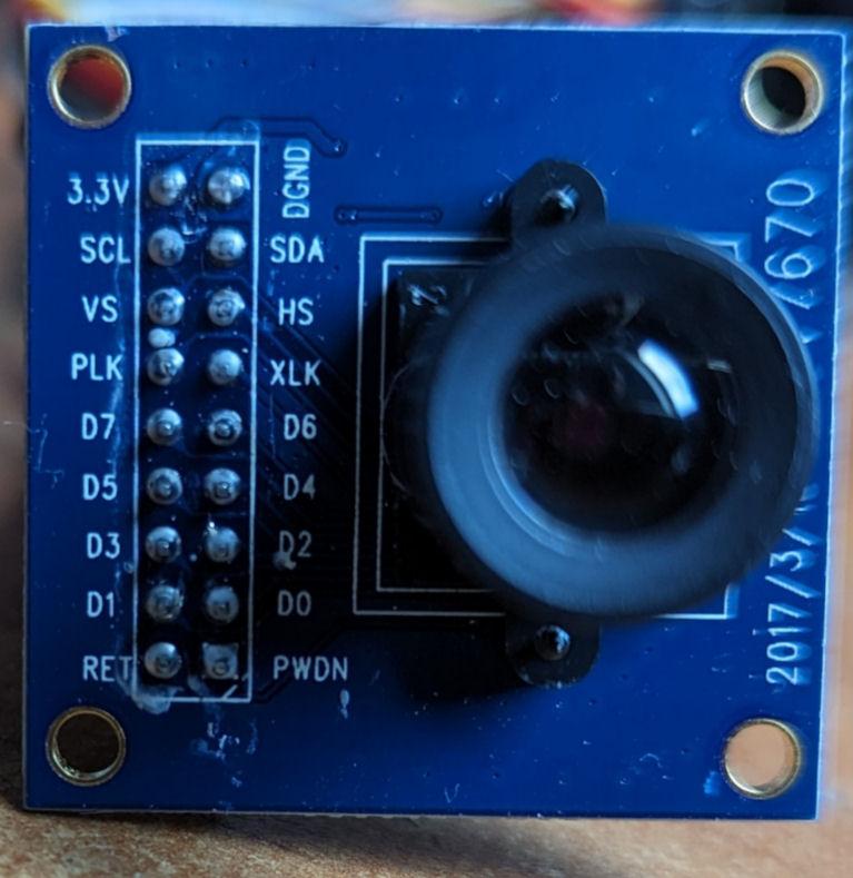

New Command supporting the OV7670 camera module e.g.
Wire 3.3V to 3.3V on the Pico
Wire GND and PWDN to GND on the Pico
Enable OPTION SYSTEM I2C on the Pico and wire SCL and SDA to the relevant pins (may be labelled SIOC and SIOD on the camera module). These connections must have a pullup to 3.3V - 2K7 recommended)
Other pins are wired as per the OPEN command. (NB: VS may be labelled VSYNC, HS may be labelled HREF, PLK may be labelled PCLK, RET may be labelled RESET and XLK may be XCLK on your module)
D0pin defines the start of a range of 8 contiguous pins (e.g.GP0 - GP7).

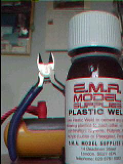

BITBANG CAMERA CAPTURE [scale, [x , y]]
This captures a picture from the camera (RGB565) and displays it on an LCD screen. An SPI LCD must be connected and enabled in order for the command to work. (ILI9341 and ST7789_320 recommended).
Scale defaults to 1 and x,y each to 0
By default a 160x120 image is output on the LCD with the top left at 0,0 on the LCD. Setting scale to 2 will fill a 320x240 display with the image. Setting the x and y parameters will offset the top left of the image on the LCD.
Update rate in a continuous loop is 7FPS onto the display at 1:1 scale and 5FPS scaled to 320x240.
Of course, assuming the display has MISO wired it is then possible to save the image to disk using the SAVE IMAGE command as used to create the example image above.

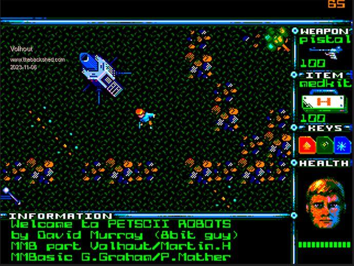

Dear Peter,
The PETSCII team is trying to make the game compliant with both LCD and VGA.
In that effort they are using the "FRAMEBUFFER WRITE sc$" where sc$ is either N or F, depending on the platform.
When running PicoMiteVGA 50708RC12, the command FRAMEBUFFER WRITE sc$ gives a syntax error when sc$="N" or "n".
I tried the latest PicoMiteVGA 50708RC14, and the same happens.
I am not sure the command is correctly implemented in picomite VGA. Can you confirm?
Thanks,
