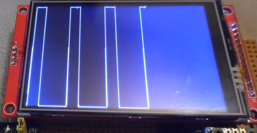

Posted: 06:35pm 28 Aug 2023
mem says 142K ram so my bad.
ili9341 320x240x3=230400 so too big as well.
I had tried your code phil99. Nice but I prefer faster display so redoing original code with additions.
SetPin GP2,pwm1A 'this optional test signal comment out
PWM 1,5000,30   ' square wave ,this optional test signal comment out
dim count%,samples!(320),old_samples!(320)
SETPIN GP26, AIn
adc open 500000,1 'samples per second
cls
do
  adc start samples!() 'get new samples
  math scale samples!(),319,samples!()'scale to 320 pixel
  for count%=0 to 318 'screen width
   'pixel count%,old_samples!(count%),rgb(black) 'erase old_sample
   'pixel count%,samples!(count%),rgb(white) 'draw new sample
    line count%,old_samples!(count%),count%+1,old_samples!(count%+1),,rgb(black) 'erase old_sample
    line count%,samples!(count%),count%+1,samples!(count%+1),,rgb(white) 'draw new sample
  next count%
  math add samples!(),0,old_samples!() 'copies new samples to old_samples
loop
I still have the problem of using pixels and only see bottom lines but using lines all wave shows.

Posted: 08:10pm 28 Aug 2023
Mick, NPH scope is pixels and shows complete wave form but it's long and subs ,maybe mine too fast cos pixels is faster than joined lines and simpler.
still experimenting as learn a lot. cheers stan
Posted: 09:38pm 28 Aug 2023
in my simple scope above doesn't do anything but if I comment it out I get a tiny wave but changing it shows no change
PWM 1,5000,70   ' square wave ,this optional test signal comment out
dim x%,samples!(640),old_samples!(640)
SETPIN GP26, AIn
cls
do
'trigger
c%=0
 do:If samples!(c%) > 0.1 then if samples!(c%+1) < 0.2 then exit do
  inc c%:loop while c%<320
 math scale samples!(),190,samples!()'scale to 320 pixel
  for x%=0 to 318 'screen width
   'pixel x%,old_samples!(x%),rgb(black) 'erase old_sample
   'pixel x%,samples!(x%),rgb(white) 'draw new sample
    line x%,old_samples!(x%+c%),x%+1,old_samples!(x%+c%+1),,rgb(black) 'erase old_sample
    line x%,samples!(x%+c%),x%+1,samples!(x%+c%+1),,rgb(white) 'draw new sample
  next x%
loop
not scaled to 190.. odd
Posts: 3417
Posted: 12:58am 29 Aug 2023
Math Scale scales the value of each sample, not the number of samples. Replace 190 with (MM.VRes / 3.3) to get the right height.
The lack of width suggests you may be using the ILI9488 with MM.HRes = 480.
Try these changes, they should work for any screen:-
HRes = MM.HRes * 2
dim x%, samples!(HRes), old_samples!(HRes)
  inc c%:loop while c% < MM.HRes
  for x%=0 to MM.HRes - 1 'screen width
Edited 2023-08-29 11:07 by phil99
Posted: 02:35pm 29 Aug 2023
Hi phil99. ili9488 and scope x and y height/width 320x320.
math scale samples!(),190,samples!()'scale to 190 pixel
This scales the matrix in() by the scalar scale and puts the answer in out()
so I read 0V to 3.3V and scales to 0 to 190... all 640 elements of samples!() back to samples!()
It should scale to any val but it doesn't, it stays 3.3V=320.
Posts: 3417
Posted: 09:41pm 29 Aug 2023
  Quote  so I read 0V to 3.3V and scales to 0 to 190
Math Scale scales the value of each sample By 190 not To 190.
ie. 3.3 (input) x 190 (scale factor) = 627 (output) which would be off screen, but the display driver (or the panel) limits it to 320 (MM.VRes).
To scale to 190 use (190 / 3.3).

Dim INTEGER a_time, a_diff, a_state, a_old, a_press ' ADC frequency button debouncing and status
Dim INTEGER Horizontal(Hres)      ' Horizontal coordinate buffer for fast graticule and buffer draw
Dim FLOAT   sample(2*Hres)        ' Extra size to hopefully pick up a trigger event
Dim FLOAT   buffer(Hres)          ' Display buffer for screen output
Dim INTEGER addr.sample, addr.buffer
Dim INTEGER HMajorX1(HMajor+1), HMajory1(HMajor+1), HMajory2(HMajor+1) ' For Horizontal Major Axes
Dim INTEGER VMajorX1(VMajor+1), VMajorx2(VMajor+1), VMajory1(VMajor+1) ' For Vertical   Major Axes
Dim INTEGER HMinorX1(HMinor+1), HMinory1(HMinor+1), HMinory2(HMinor+1) ' For Horizontal Minor Axes
Dim INTEGER VMinorX1(VMinor+1), VMinorx2(VMinor+1), VMinory1(VMinor+1) ' For Vertical   Minor Axes
Dim Float   V.Scale(10), V.Offset(10), V.MajVolts(10)
Dim Float   H.Freq(10),  H.Seconds(10)
Dim String  H.Units$(10), keypress$
' ========================== Initialization =================================
Timer = 0
Initialize_Arrays
Initialize_Hardware
Display_Instructions
Draw_Graticules
' ========================== Processing Loop ================================
 Randomize_Test_Signal
 trigger_timeout = Timer
   Handle_Keypresses
   Handle_Switches
   trigger = -1
   Get_Samples
   trigger = find_trigger(Trig_Type)
   If Timer-trigger_timeout > 2500 Then Display_No_Trigger ' Waiting too long for a trigger.
 Loop Until trigger >= 0
 If Timer-trigger_timeout > 2500 Then Draw_Graticules      ' OK, we've got a trigger. Clear message.

Posted: 01:55pm 30 Aug 2023
Er..wow! I have been using math scale under a mis preconception all along, DOH!
Ta for pointing out my error. stan
