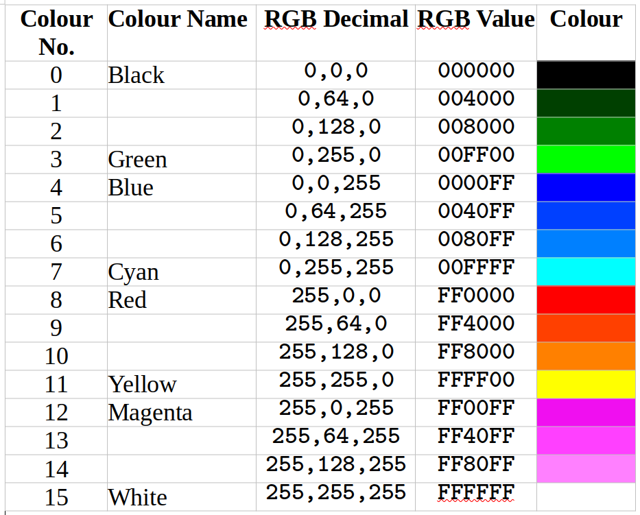

Thanks @phil99, I must have been reading incorrect information.  Maybe it was related to different hardware.  Like I said, I was Googling, looking for the answers.
I'll update the table and see what it looks like.
Mmm...unfortunately it just darked all the blended colours, reducing the dynamic range of the palette.
Are the values you've given based on the resistor values in the Green circuit of the VGA?  ie. bit values 10 is twice the voltage of bit values 01.

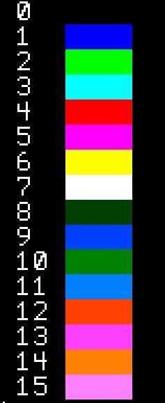

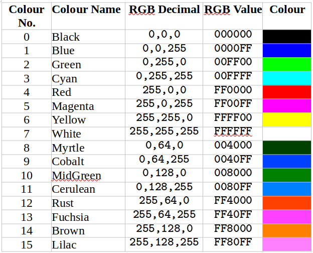

The Order of the Colornubers, as also used in Sprite Files, are
0=BLACK
1=BLUE
2=GREEN
3=CYAN
4=RED
5=MAGENTA
6=YELLOW
7=WHITE
8=MYRTLE
9=COBALT
A=MIDGREEN
B=CERULEAN
C=RUST
D=FUCHSIA
E=BROWN
F=LILAC

  Hawk said  Are the values you've given based on the resistor values in the Green circuit of the VGA?  ie. bit values 10 is twice the voltage of bit values 01.
For green the two most significant bits of the byte become Green High and Green Low.
For red and blue just the MSB is used.
For the VGA that program just reads back values from the frame buffer. The resistors determine what actually goes to the screen. Put a 1k trim-pot plus 220R in series with each of 4 pins and you can have whatever you like.
Four bits just isn't enough to be too fussy about precision. No matter what 16 you choose all colours in between those will be wrong, and that is the great majority of colours.

OK, I've updated according to Martin's info.  I can't go against the facts, but I do like the palette I posted that has the shades of the same colours all together.  I can see the patterns in the numbers of the correct palette so I guess there's a programmatic reason for it.
So when you create an indexed bitmap to use in a program, the palette needs to be like this?   I'll need to update my palette in the GIMP.
Sorry...this has really corrupted the original topic.  I didn't intend this to get so far off topic.  Perhaps it needs moving to it's own thread.

Thanks for the explanation gentlemen.  So the upshot is, the actual colours that are displayed will be different for each version of the VGA output circuit.  There is no standard.  So what might look good on one machine may look very different on another.
Any palette that we define in a paint program to use to create graphics for the PicoMiteVGA will be just an approximation of the final output from the device.
At least now I have that palette to work with, and based on my experiments on my device, it's a pretty good approximation, so thanks again.
I'm finding working without a grey value challenging, but it's the limitations that bring out creativity, right?  Was RGBI ever considered as a viable option for the PicoMiteVGA?
For those that use the GIMP, here is the palette.
PicoMiteVGA.gpl.zip
