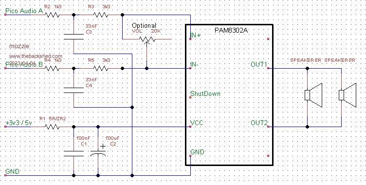

  mozzie said  I have tested a very simple circuit with a PAM8302 mono amp with differential inputs and it is quiet as the grave with no signal even with a simple single stage filter and very little supply bypassing.
Using Peter's "M" parameter and Mozzie's circuit the PAM8302 is back in the game!
The differential PWM signals are filtered and sent to the PAM8302 differential inputs as per Volhout's circuit above.

After some further tinkering I'm sorry to say that the PAM8403 is not a great match to this circuit, the input is non-differential so doesn't allow the new magic to work
I did try to feed the audio across the inputs (L/R) and speaker across the outputs (L+/R+), but whilst it does make sound, it still makes a lot of odd noises, pretty sure its heterodyning due to the oscillators operating at different frequencies between channels. Someone else here might have a better solution. You could also use an op-amp buffer to drive it, that would work fine.
See below for basic circuit with PAM8302:
This uses what was handy and could be optimised further, most values non-critical.
Volume control as attenuator to keep signal impedance balanced.
As suggested by others, will also work with LM386(x2 bridge) TDA2822 etc
LM4871 possibly not as its a bridge amp internally, cant feed differential signal.

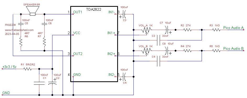

  mozzie said  As suggested by others, will also work with LM386(x2 bridge) TDA2822 etc ...
Am I correct that you would only require one TDA2822 ? That looks like a cheap/easily available DIP package that would be preferable to a "module". Does anyone know if it requires significant support components ? - I know I could look at the spec. sheet, but ... lazy .

G'day Tom,
Correct, only 1 x TDA2822 required but they have been obsolete in DIP package for a while from legit suppliers so its ALI etc and hope they work.
There is also TDA2822D in SOIC still around if you can find them.
This works with the PWM output from the Pico, no DAC required.
This is the circuit I am using:
Its a bit messy but that is the layout of the chip...
Once again you can play around with different filters etc that others have designed, this was what I had at hand, also requires stereo volume control pot.
Lyle.

Lyle, on the PAM8302A circuit is that the circuit for a PAM IC on its own or for the module ?

Hi Tom,
The circuit is for the module, however the input circuit for the TDA2822 is an improvement so I'll update the PAM circuit if required.

The PAM8302 solution is probably the better way to go as the shutdown mode allows you to switch it off to save the batteries. (extra GPIO pin on header required)
A 1k resistor in parallel with the 20k pot will do the trick for the volume control.

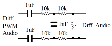

Posts: 3417
Posted: 12:44pm 05 Apr 2023
Comparing Mozzie's circuit and the TDA2822 datasheet example circuit for bridge mode shows C3 as 10uF going direct from IN1- to IN2-, not Gnd. and C4 as 10nF from IN2- to Gnd.
Smaller caps saving a little space.
The dual volume control could be replaced by a single pot (wired as a variable resistor) between IN1+ and IN2+. Plus a 10k resistor from each IN+ to Gnd.
For the low pass filter a single cap could go from the junction of R2 & R3 to the junction of R4 & R5.

With Peters change to the Play Sound (mono) function making the output differential, we need to use 2 in-phase amplifiers (or a differential amp) to drive the speaker, thankfully the TDA2822 makes this possible but the extra components are a problem.
Or are you suggesting to make the filter section extract the differential signal, that would be an awesome solution if it would work

Posts: 3417
Posted: 11:01pm 05 Apr 2023
"Or are you suggesting to make the filter section extract the differential signal,"
Yes, as it is a single differential signal and not two independent signals a single differential filter should work. Same with the volume control.
Edit
Test filter, ignore the values just testing the concept. Seems to work ok.
