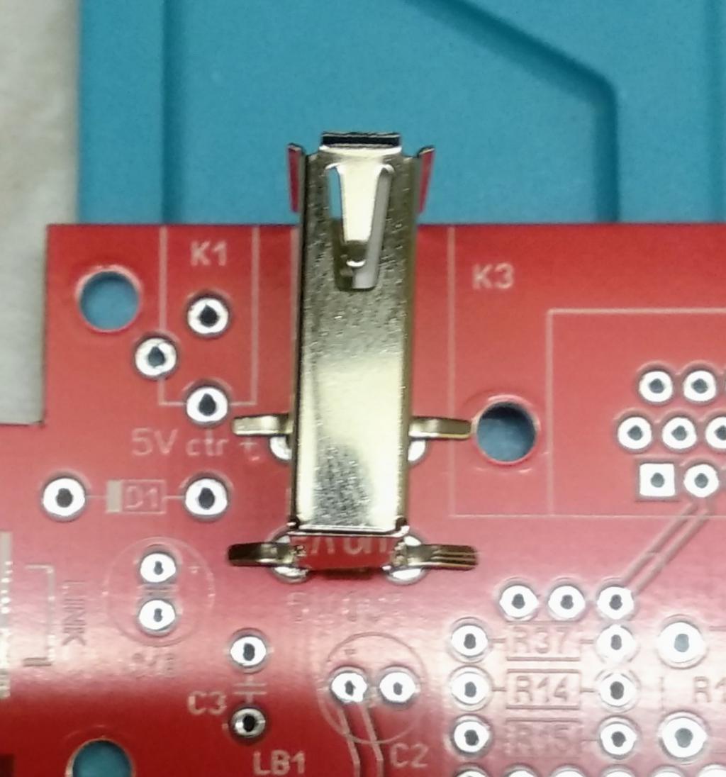

Mick regarding the USB-A socket. The attached photo shows that all the holes are basically aligned correctly for the AliExpress component (which I can only find in this orientation). The legs however are 1.5mm wide and thus need bigger holes or slots, personally I would look at adding another 0.2mm to that to provide some wiggle room.

I'd already improved the alignment of the USB-A fixing holes so the "back" holes line up now. I'll change the pads to 2.5mm outside, 1.65mm inside. I don't want them to be too sloppy with the "official" sockets.
