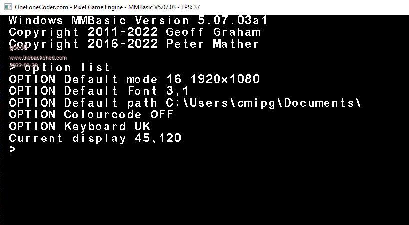

I would like MMbasic for windows to respect the basic rules and for example, when using the windows resolution, "MMbasic for windows" does like 999 999 999 applications, and positions the point 0,0 at the top left of the window and not under top horizontal border, as it does with mode 16 in 1920x1080 screen resolution

  Quote  I would like MMbasic for windows to respect the basic rules and for example, when using the windows resolution, "MMbasic for windows" does like 999 999 999 applications, and positions the point 0,0 at the top left of the window and not under top horizontal border, as it does with mode 16 in 1920x1080 screen resolution
It doesn't do as you say if you have a screen resolution big enough to display 1920*1080 with a border. e.g. a 4K screen
Use mode -16 to get full screen if you must otherwise use a lower resolution that fits your monitor.

Posted: 09:21am 19 Mar 2022
This is wrong, I have a higher resolution, with 2 screens at 1920x1080 each, so a resolution for windows of 3840x1080 and I still have the same problem
I attach here a file containing screenshots of the same program under vb6 with a window in 1920x1080 in normal mode (not maximized) and under MMBasic mode 16, and it appears that under vb6 we can see the text positioned at 0.0 while under MMB the text is hidden by the top border
when in mode -16 it does not work correctly
1 - in some cases I have a complete flashing of the screen which makes any application impossible
2 - it is impossible to set the default mode -16
3 - when you take a screenshot in this mode, with text and lines, the result gives an empty image, without text and without drawing, whereas in mode 16 it works correctly (see attached screenshots )
testscreens.zip
Posts: 12059
Posted: 09:22am 19 Mar 2022
You still have only 1080 high and I'm not spending time on this, no way to replicate dual screens and the vagaries of your drivers  - sorry
Try mode 19 which is optimised for 1080p monitors
Edited 2022-03-19 19:32 by matherp
goc30
Joined: 12/04/2017
Location: France
Posts: 435
Posted: 10:42am 20 Mar 2022
  matherp said  You still have only 1080 high and I'm not spending time on this, no way to replicate dual screens and the vagaries of your drivers  - sorry
first, can-you explaine this screen_capture
I am in 1920x1080 res and you can see that first line is visble, not under mmb4w window's top border
If the A1 version works and after that it no longer works, it means that you have modified something that worked well for something that has a malfunction.
Second, in mode 19 , I lost 80 pixels why?? have you tested a resolution of 1920 x 1079 ??
Third, If I put my second screen after bottom of first screen (posy1=1080, posy2=2159), mode 16 work correctly, but bottom bord of mmb4w's window is in second screen (y1=0 and y2=1080) why y2 pos is not 1079 ??
in all app working under MSWindow (from 3.1 to 11), windo's borders are into screen resolution, not out of, except mmb4w
