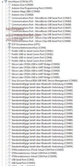

Michael
Just an impression to show how many COM ports you can have.(Win7):
Edited 2022-02-06 05:22 by twofingers

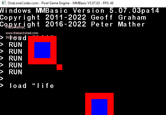

Posted: 10:33pm 06 Feb 2022
found a problem with blit :
Box 100,100,100,100,22,RGB(red),RGB(blue)
Blit 100,100,300,300,100,100
Blit read 1,100,100,20,20
Blit write 1,200,200
buffer in use
Plasma

  Plasmamac said  buffer in use
Worked for me, but got the error on a second run. Blit buffer must be closed before attempting BLIT READ a second time.
I use ON ERROR SKIP: BLIT CLOSE 1 before a BLIT READ just in case the BLIT buffer exists.

Plasmamac
Joined: 31/01/2019
Posts: 620
Posted: 04:15pm 08 Feb 2022
Hi
after :
the next command will crash
*load
*new
etc
Edited 2022-02-09 02:33 by Plasmamac
