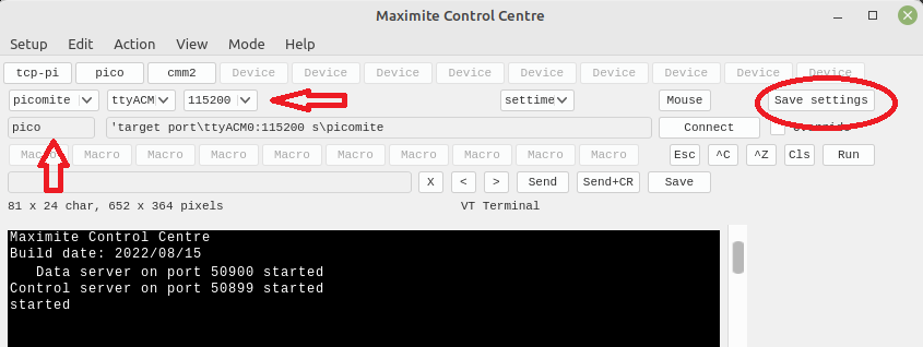

Posted: 11:09am 15 Aug 2022
Hi Jim,
What is the envisioned way to "save" the MMCC config ?
I set up VGAmite, ttyACM0, 38400 then connect in MMCC. When I save this config, next power up it is not memorized.
Maybe it is the order in which I use MMEdit.
- I first start MMCC, config it, connect
- Then I start MMEdit, select picomite syntax, and open source file. Then upload and run.
Is this the preferred way of working ? (linux version)

Posted: 09:17pm 15 Aug 2022
I do need to complete more of the help files.
You need to specify 3 things.
Type of device, com port, and port speed (or TCPIP address and port number)
If you want to save the settings for your device, you have to give it a name - in my case it's called 'pico'
Then 'save settings' and it will be added to the next available device in the top row.
The last connected device is remembered so there should be no need to set it again if you only have one device.
@Volhout,
I will add a prompt for device name if you have left that box blank. On the Linux rendering, that is not obviously a box for entry. I think that was your problem. The inf files are located in the data sub-folder and need write permissions.
Also note the VGAmite refers to the original blackpill, a short-lived offering. In light of current naming, I will have to change that. The picomite selection also covers the VGA version on the pico because as far as MMEdit is concerned, they are the same.
Sorry about all the confusion.

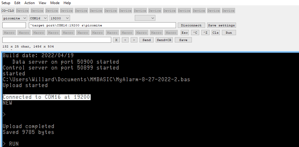

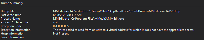

Posted: 08:30pm 27 Aug 2022
I've been having issues with the latest releases.
When I try to DEPLOY with F2, the MCC insists that my com port changed... (it didn't) and refuses to upload.  Falling back to a version I had from April works just fine.

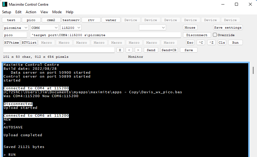

Posted: 05:34am 28 Aug 2022
  pwillard said  I've been having issues with the latest releases.
If you are happy with the early build of MMEdit, you are welcome to stay with it but it has more bugs than a mangy dog's backside.
If you want me to work out why the more recent build doesn't work for you, I need more details.
The code that decides to display the "port changed" message is simple:
If currentConnection <>"" And currentConnection <> newConnection
  MMdisconnect()
  notice("Port Changed!"+#LF$+"disconnecting first.",2000)
Which means.
If the device is currently connected and the current connection specs are different to the new specs, then disconnect and show a warning.
After that, MMCC will reconnect using the new specs.
I will add a test for Windows users to cater for a change in case (COM to com) but that wouldn't stop a successful re-connection.
I will print more debug information to the terminal window which should help diagnose.
MMCC gets its port information from the first line of your code and if it is not specified there, it use the device specifications in MMCC (to the left of the "connect" button).
It would help if you can post a screen print of the MMCC after a fail. Something similar to this:
I have tried every combination I can think of looking for a bug but there is obviously a sequence I have not thought of.

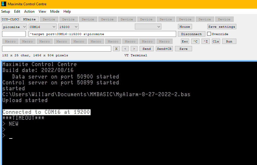

Posted: 11:13am 28 Aug 2022
Well, as mentioned...   I get reasonably correct behavior from the earlier release.
So I then installed the 8/16 version again... and I get a slightly different behavior now.  It stopped complaining about CHANGED COM port on deploy... it now just times out.
Was able to reproduce this twice after shutting down MMEDIT and ControlCenter.
Also... If I do a fresh restart of MMEDIT 8/16, and load a program into the editor but then "just goofing" I chose to MANUALLY change the Syntax from default CMM2 to PICOMITE, the program will crash to desktop.
I'm not sure if I need to wipe out persistent settings or not, so maybe that's why I'm getting unusual results.  So, I'm going to do a complete wipe again and re-install.
So... complete removal... uninstall, remove multiple folders... re-install... same thing. TIMEOUT.
Using Teraterm to upload with Autosave works fine... I'm stumped.

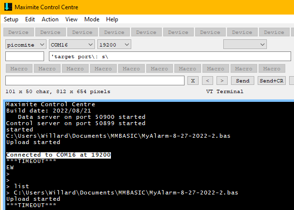

Posted: 10:30pm 28 Aug 2022
You appear to have a port specification as the first line of your program. Can you share that first line with me?
If the first line of your program has (what looks like) a port specs, that has priority over the MMCC settings unless you have "override" ticked, in which sasses MMCC always wins.
When you were having problems with the "port changed" warnings, I suspect that you had different baud rates set in MMCC and your program first line.
  Quote  Also... If I do a fresh restart of MMEDIT 8/16, and load a program into the editor but then "just goofing" I chose to MANUALLY change the Syntax from default CMM2 to PICOMITE, the program will crash to desktop.
Can you expand on "goofing"? I was never any good at mind reading.
If you do reinstall fully or just delete your MMEdit.inf and MMCC.inf files to reset things, please keep a copy of the two inf files first so I have something to go on.

Posted: 10:45am 29 Aug 2022
Goofing:  Doing something I didn't *need* to do... but doing it anyway.
And yes, my first line is:
'target port\COM16:19200 s\picomite
and I was relying on that... not what MMCC had a "saved" setting for, for example.
If I make sure that MMCC config and the first line match...
and then disconnect MMCC from Picomit and then reconnect to Picomite
I still get...
Upload started
***TIMEOUT***
...when I select DEPLOY
I'm not sure if I need to mention that I'm using the latest non-vga picomite beta.
I still get...
Upload started
***TIMEOUT***
Yesterday I had the same, in my case it was a (second) terminal program blocking MMCC access to the port. I closed the terminal program and all was fine.
pwillard
Joined: 07/06/2022
Posts: 347
Posted: 12:08pm 29 Aug 2022
Good troubleshooting idea... but this is after a fresh reboot, so no other terminal was running.  For sanity checking... I'm going to drop back to an older version of PICOMITE firmware. PicoMiteV5.07.04
Fresh Picomite Firmware
reboot
Verify communication with PICO.
1st line setup removed from code.
Now relying on MMCC settings
Maximite Control Centre
Build date: 2022/08/21
  Data server on port 50900 started
Control server on port 50899 started
started
Connected to COM16 at 115200
> run
Code is running...  printing updates
Update time: 08:16:03
DST STATE =  1
CTRL-C to break the connection...
Get ">" prompt back.
In MMEDIT, press deploy...
> C:\Users\Willard\Documents\MMBASIC\MyAlarm-8-27-2022-2.bas
Uploading using:  'target port\COM16:115200 s\picomite
Upload started
***TIMEOUT***
I'm stumped...
Again... I can later startup a Teraterm session and do an Autosave upload just fine...
and this was all working a few weeks ago but I was using older releases..
To Be Honest: I'm starting to suspect my PICO is not OK.
CONCLUSION CONFIRMED: It's my PICO.  The PIMORONI PICO LIPO. Different enough to be a problem...
Edited 2022-08-30 04:48 by pwillard
