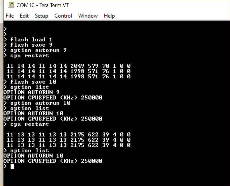

Posts: 9271
Posted: 09:32pm 21 Aug 2021
OPTION AUTORUN 1 works fine
OPTION AUTORUN 10 doesn't. The option has disappeared from the list after powering up.
I've not checked the other slots. Only just discovered this.

Posts: 9271
Posted: 07:50am 22 Aug 2021
weird... I'll try again. It definitely didn't work though. I had a digital clock in flash 10 and I couldn't get it to auto run. I tried by disconnecting & reconnecting usb and also by powering direct without usb. No go. I copied the prog into flash 1 and it works perfectly every time. I'll double check.
Posts: 9271
Posted: 08:05am 22 Aug 2021

Posts: 12084
Posted: 08:20am 22 Aug 2021
Try without the option memory command - that is the most likely area for a bug in the firmware
Posts: 9271
Posted: 08:51am 22 Aug 2021
I've reinstalled, without that bit, and slots 1 and 2 are fine now. I'll try adding that option and see if it messes things up.
EDIT:
Yep, it messed things up. Autorun 2 isn't working now. I tried option memory 0, 80384 and that didn't fix it, but it now reports memory 80384,83456 which is correct for 59 controls at 52 bytes each.
Option memory 0,81920 has restored autorun 2 to life.
Edited 2021-08-22 19:12 by Mixtel90
Posts: 12084
Posted: 10:08am 22 Aug 2021
Please try the attached - no version change
PicoMiteV5.07.00b14.zip
