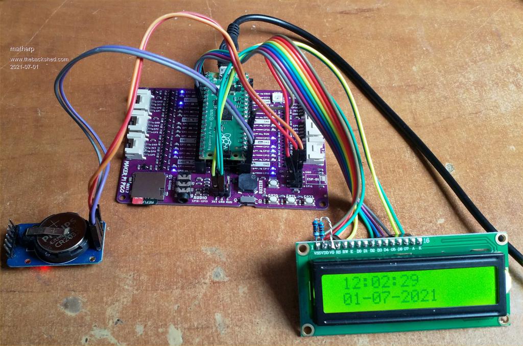

a45
PicomiteV5.07.00a45.zip
KEYPAD and LCD commands now working - see MM2 manual.
Note you should use a 3.3V LCD as in the picture - they are available
Things to do:
Implement the GPS functionality from the Armmites
Implement background ADC functionality
Implement SOUND
That should then be pretty much it for a good usable port with the bonus of the high speed, DIL form factor, and chip specific functionality like PIO in a very cheap package
Edited 2021-07-01 21:58 by matherp
