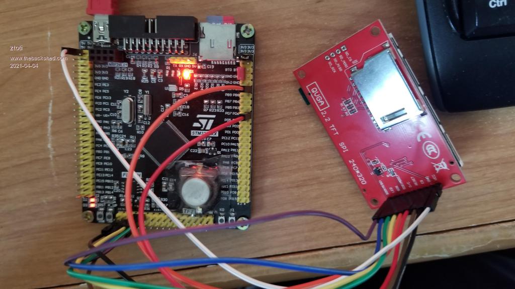

  ztoti said  I connected ILI9341 to the board according with the manual:
OPTION LCDPANEL ILI9341, LANDSCAPE, PE0, PD6, PC4
but I have just black screen. Backlight command works just fine (brightness is going from min to max) and this is it, GUI test lcdpanel doesn't work.

I have SPI ILI9341 and use it in many projects with MM,MM2,MM2+,MMExtreme and no problem at all. I tried also with SPI ILI9341 without the touch panel, same result - black screen.
What I did:
OPTION LCDPANEL DISABLE
OPTION LIST  ......no display config. on the screen
 connect SPI ILI 9341 as on the manual, D/C on PE0, RESET on PD6, CS on PC4
 restart ARMmite
GUI TEST LCDPANEL   just black screen
Attached is the picture how I attached ILI9341 without touch screen (CS on GND)

Where does the LED connect. Can't quite see it but looks like the blue wire. It is connected to the LCD_BL on FSMC pin 28?  The LCD_BL can only drive at logic level so you will need to give the LED pin on the LCD 3.3v directly.
To drive from the LCD_BL on the FSMC you will need something like this.
F4 H7FotSF4xGT

Thank you guys for your effort, it start to works after I entered the command in PORTRAIT mode. Anyway, my backlight works fine without any transistor driver, just the command is inverted but it is ok.
It was really strange behavior, I tried 100 times with no success and after I tried
OPTION LCDPANEL ILI9341,P,PE0,PD6 (portrait mode), the display is OK now.
Thank you a lot,
Zoran
