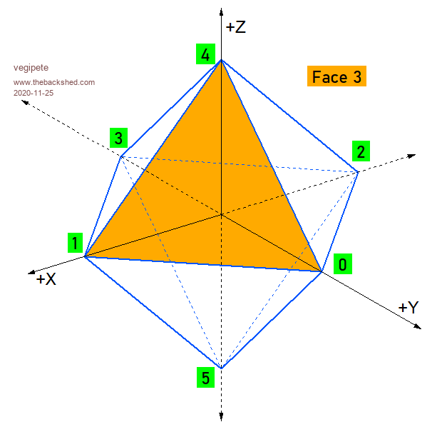

  matherp said  and finally the calculated surface normals for each face based on the 1st point-2nd and 3rd-2nd.
It is this latter that I really need to be sure of before I go any further.

Face 3 vertices , 0, 4, 1,   83.3333,   83.3333,   83.3333,   -0.5774,   -0.5774,   -0.5774
Excellent start. However, the face normal looks mathematically backwards if positive is to be outward.
Something needs to flip. Could be (1st point - 2nd point) and (1st point - 3rd point)
Or (1st - 2nd), (2nd - 3rd)
Posts: 12085
Posted: 10:49pm 24 Nov 2020
Think it is correct. The greater the Z the further away. Face 3 has positive Z therefore -ve normal so don't display
vegipete
Joined: 29/01/2013
Posts: 1186
Posted: 12:22am 25 Nov 2020
For the given coordinates, face 3 has vertices at:
(0,250,0)  (250,0,0)  (0,0,250)
Centroid at (83.33, 83.33, 83.33) seems correct.
The outward normal should be (positive,positive,positive), which is pointing away from the origin.
The face normal is unrelated to the viewer. The angle between the viewing direction and the face normal determines visibility, but your initial data makes no reference to viewing position/direction.
This image is orthogonal projection, not perspective. I'm quite sure I have my axis orientation correct for normal right handed geometry. The translation to flipped screen coordinates (since positive y is down on the screen) must be done with care.

For reference, based on the vertex coordinates, the center of the octahedron is at (0,0,0) and
vertex 0 is in the direction of +Y
vertex 1 is in the direction of +X
vertex 2 is in the direction of -X
vertex 3 is in the direction of -Y
vertex 4 is in the direction of +Z
vertex 5 is in the direction of -Z

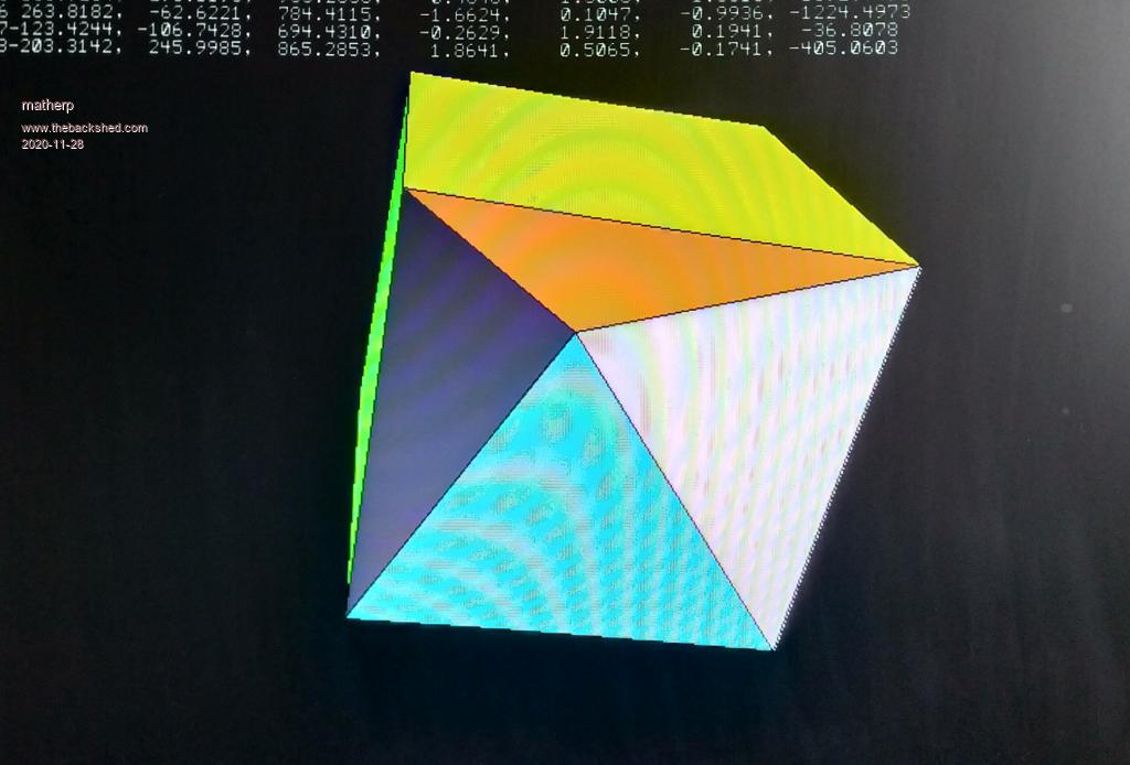

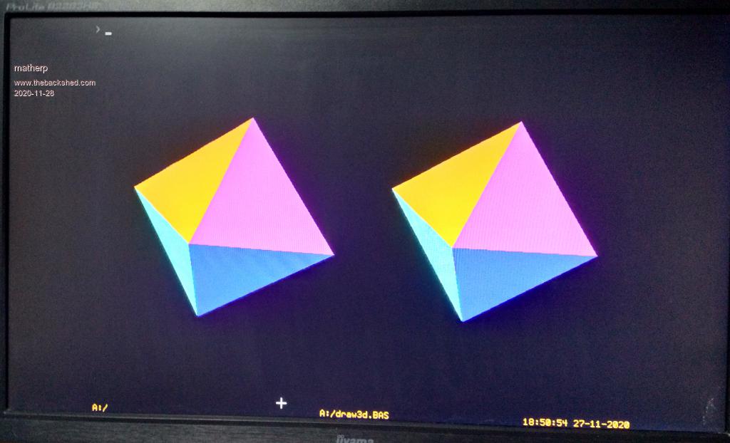

Posts: 12085
Posted: 07:10pm 27 Nov 2020
Guys
It would be great if you could find time to have a play with the attached hack version
CMM2V1.5.zip
This has the start of the 3D engine. The four commands implemented so far should be obvious from the example program
option explicit
option default float
dim integer camera_y = mm.vres-20
dim integer viewplane = 700
dim integer camera_z = 0
dim integer camera_x
dim integer c
timer=0
dim q(4)
dim yaw=rad(1),pitch=rad(2),roll=rad(0.5)
dim integer nv=6, nf=8 ' octahedron has 6 vertices and 8 faces
'array to hold vertices
dim v(2,nv-1)=(0,250,0,   250,0,0,   -250,0,0,  0,-250,0,   0,0,250,   0,0,-250)
' array to hold number of vertices for each face
dim integer fc(nf-1) =(3, 3, 3, 3, 3, 3, 3, 3)
dim integer bcol(nf-1)=(rgb(red),rgb(blue),rgb(green),rgb(magenta),rgb(yellow),rgb(cyan),rgb(brown),rgb(gray))
dim integer fcol(nf-1)=(0,0,0,0,0,0,0,0)
'array to hold vertices for each face
dim integer fv(math(sum fc())-1)=(0,5,2,  0,1,5,  0,2,4,  0,4,1,  3,2,5,  3,5,1,  3,1,4,   3,4,2 )
gui cursor on 1,40,camera_y
' create 3D object number 1
draw3d create 1, nv, nf, v(), fc(), fv(),bcol(),bcol()
' create 3D object number 2
draw3d create 2, nv, nf, v(), fc(), fv(),bcol(),bcol()
page write 1
for c=0 to 720
 camera_x=c+40
 draw3d camera 1,viewplane,camera_x,camera_y,camera_z
 draw3d camera 2,viewplane,camera_x,camera_y,camera_z
 draw3d show 1,mm.hres\4,mm.vres\2,1000
 draw3d show 2,mm.hres\4*3,mm.vres\2,1000
 math q_euler yaw,pitch,roll,q()
 draw3d rotate 1,q()
 draw3d rotate 2,q()
 inc yaw,rad(1)
 inc pitch,rad(2)
 inc roll,rad(0.5)
 gui cursor camera_x,camera_y
 page copy 1 to 0,b
 do while inkey$="":loop
next
print timer
draw3d close all
It easily wins the challenge when configured appropriately but in the example I single step by pressing any key.
Each iteration rotates the two octahedron and also moves the camera position.
At the moment the SHOW command just clears the minimum area where the object was previously displayed.
The bit I'm not confident in is the 2D rendering dependent on camera position but it seems to do the right sort of thing.
The tricky bit was getting the face ordering. The firmware sorts the faces by the dot product of the normal vector and the ray and that seems to give the correct order. Otherwise with different camera positions there are faces that are correctly not hidden but shouldn't show.
Note that there is a camera position associated with with each object so that different views can be shown simultaneously but currently the same object can't be shown in different places, although, as in the example the same meta-data can easily be used for multiple objects.
Object rotation is deliberately separated from showing the object so that you can move the object round the screen separately from changing its orientation
Edited 2020-11-28 05:13 by matherp

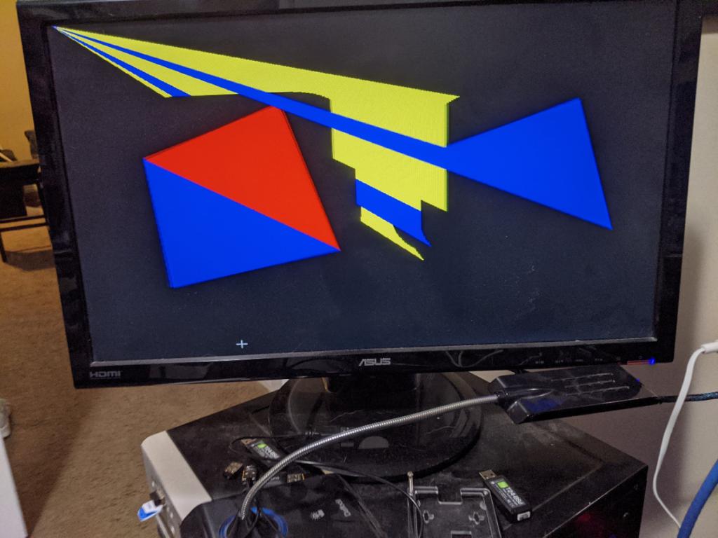

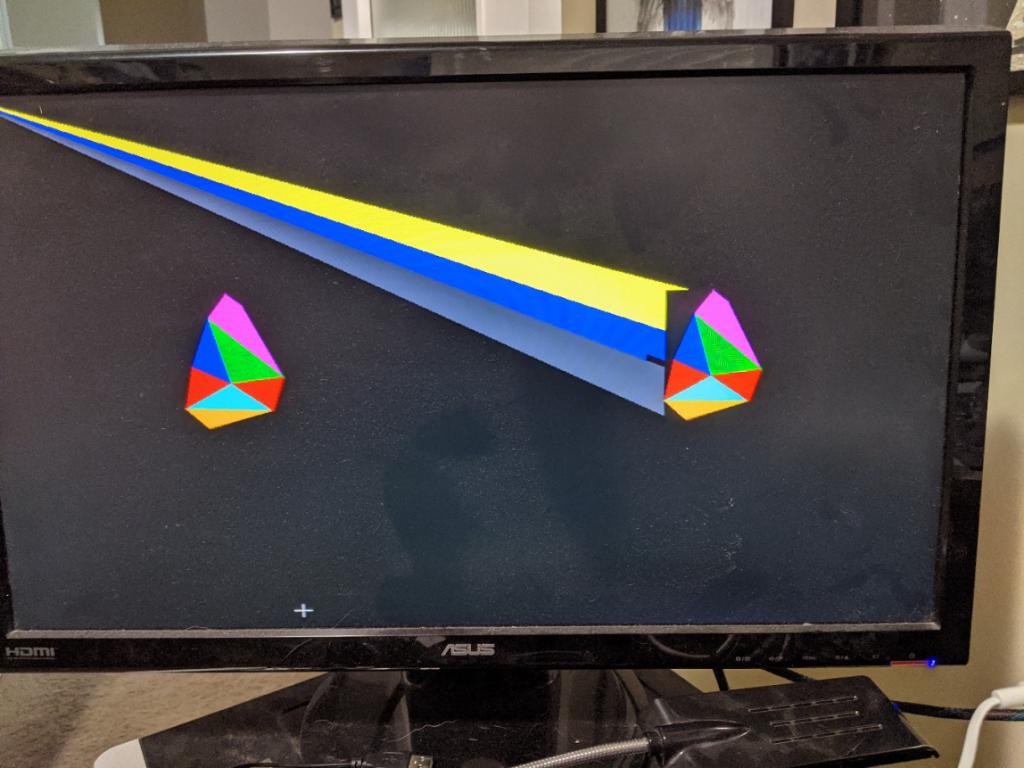

PeteCotton
Joined: 13/08/2020
Posts: 669
Posted: 10:24pm 27 Nov 2020
  matherp said  Guys
Can you confirm if the engine will handle planes with 4 vertices? I was playing with the Elite ship (of course   ), and when I create the model with some 4 vertice planes they get distorted (image on right below), but the same model using only 3 vertice planes (image on left) is fine (apart from the missing gaps of course).
Of course, it absolutely could be my code. But I thought I'd better check in case it hadn't been implemented yet.
As a side note: To save me having to recreate the same Elite ship every time, I started working on a rudimentary object file format (emulated by READ/DATA commands for the time being), that would allow me to load the object definitions in as needed.

  Quote  Can you confirm if the engine will handle planes with 4 vertices?
4, 5, 6, 7.... in theory but not tested. Any convex shape where the vertices are listed clockwise.
  Quote  This shows more faces are being drawn than is necessary,
Not sure what you mean. There seem to be planes that are pointing towards the camera so will not be hidden by the "normal" mechanism that still won't show because of Painters. This doesn't occur with the camera directly in front of the object but does when the camera is offset. If I run the code without Painters I get incorrect displays even when filtering for the dot-product

PeteCotton
Joined: 13/08/2020
Posts: 669
Posted: 11:32pm 27 Nov 2020
I just built a square out of 4 triangles (2 for each side of the object), and it works fine (left hand side of image below). And using the same data tried to do sides with 4 vertices and got the same issue (the 4th point appears to default to screen co-ords 0,0) (right hand side of image below).

  Quote  That means that any face towards the camera must be completely visible.
This is stretching my 3D visualisation. The problem I'm trying to solve at the moment is 3D objects that are off the camera viewing axis.
So the current code only supports the camera looking along the z-axis and tries to apply correct perspective for a 3D object that is not directly in front of the camera. I think that in this case the act of projection can effectively "hide" faces that are pointing towards the camera and therefore some sorting of drawing order is needed but it is very difficult to demonstrate and I could be completely wrong.
Once I have sorted this projection issue and the multi-sided issue then next step is to look at rotating the world around the camera to allow for the camera yaw, pitch and tilt to be specified as well as its location.
Of course my head might explode first

This is a harder challenge. Can anyone work out how to rotate this shape
dim integer nv=9, nf=9 ' cube with  one face concave 9 vertices and 9 faces
dim v(2,nv-1)=(-1,1,-1,  1,1,-1, 1,-1,-1, -1,-1,-1, -1,1,1, 1,1,1, 1,-1,1,  -1,-1,1, 0,0,0)
math scale v(),200,v()
dim integer fc(nf-1) =(4,4,4,4,4,3,3,3,3)
dim integer bcol(nf-1)=(rgb(red),rgb(blue),rgb(green),rgb(magenta),rgb(yellow),rgb(cyan),rgb(white),rgb(brown),rgb(gray))
dim integer fcol(nf-1)=(0,0,0,0,0,0,0,0,0)
dim integer fv(math(sum fc())-1)=(1,5,6,2, 1,0,4,5,  0,3,7,4,  5,4,7,6, 2,6,7,3, 0,1,8, 1,2,8, 2,3,8, 3,0,8)
Because the triangles on the front face are equilateral the surface normal always calculates as 0! In the picture I've overcome this by changing point 8 from 0,0,0 to 0,0,0.1
However even when I make make the centre z-point 0.1 then faces that are clearly forward facing end up with +ve dot products under certain orientations. In the example f I do one more step of rotation the brown triangle disappears.
If you attempt this please use the full normal calculation including the dot-product with the ray from the camera.
I've clearly got a bug but can't see it. Help appreciated.
Edited 2020-11-28 21:32 by matherp
