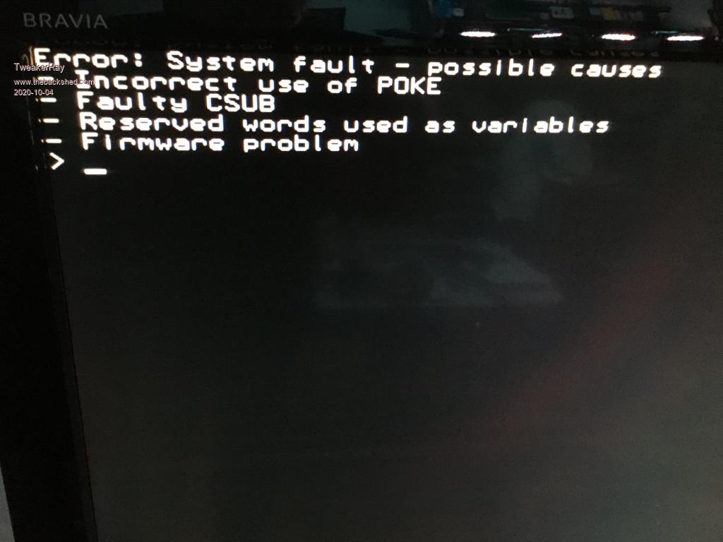

Hi ! I just updated to the latest firmware and was browsing in the filemenue when the thing crashed
I got this error:
When  was using page up and down a few times and It seemed that when I went down with pagedown the line was not marked anymore where I can select a programm...
when I used the up courser again i could see the line ... after a little up and down it crashed with that... O_o
Update:
I could replicate the error...
it seems I got 44 entrys on my sdcard(Programms and directorys)
However if I use pagedown when in the filebrowser
i am at entry 48 of 44 (which is not the last file on my sdcard)
so the courserline vansihes. if i now use the coursor up - it crashes...
I updated from CMM2_Beta CMM2V5-05-06b2 to
              CMM2_Beta CMM2V5.05.06b15

Posts: 12088

  Quote  I have made a video so you see the problem and maybe you can see what's happening
Thanks - nearly all the problems I've had with the editor and filemanager are when the screen isn't full or is exactly full and it looks like this is another one. Probably created when I changed page up/down to go the the beginning/end of the current page on the first pageup/down press. Serves me right for being helpful
Now I need to create a disk with less files to help debug
Posts: 12088
Posted: 06:17pm 03 Oct 2020
TweakerRay
Please download 5.05.06b16 again - should be fixed now
