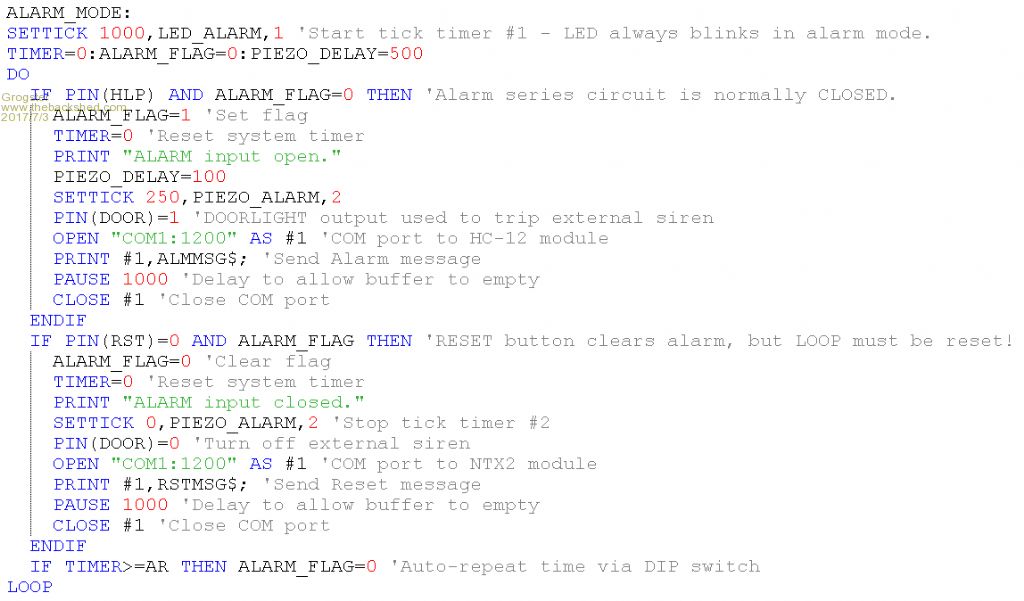

EDIT: Here is the test alarm code that is doing this very odd com-port behaviour.
It is indeed possible, that the HC-12 I am using is crook or something, so I will be checking what is indeed coming out of the MM COM port on the logic analyser tomorrow - perhaps the HC-12 is unstable and is generating the problem internally? Anyone seen that before?Edited by Grogster 2017-07-04

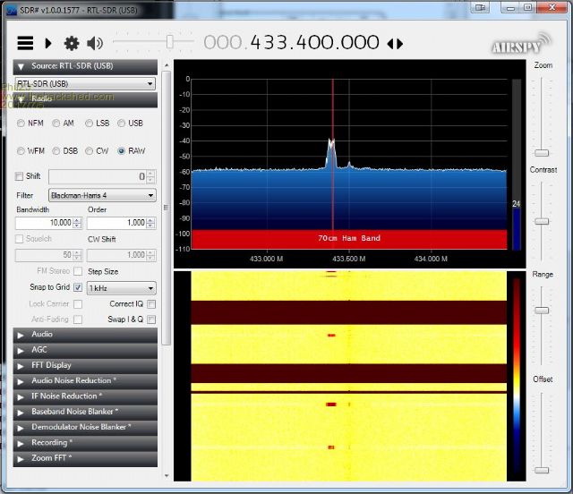

My hypothesis is that your HC-12 is picking up noise (or another close-by 433MHz transmitter) and keeps sending data to your MM.Edited by piclover 2017-07-04

I have seen HC12s pick up crap from nearby systems... can you try them on another channel?
I always have some "envelope" around my stuff so it is easy for both ends to discard garbage as i could never rely on a clean channel and every installation had to be customised. Now i don't bother and everything just uses channel 0.
Any noise is swamped by genuine HC12 chatter and I get zero corruption when the comms are used in anger. My range generally isn't extreme (nothing like the possible 1.2Km) but I have seen rubbish turning up. Here is the schema of my envelope, I can post some stripped-down code for you to test with if you are interested: (top tip, I broadcast the time regularly thus nodes do not require RTCs - I am so cheap!) I have networks using this and have T/RX hundreds of MB with no detected errors, even in known noisy areas (that actually drove the dev of this protocol). The actual working code employs a simple rolling encryption so the packets are not easily "sniffed"

Yes, I am reasonably confident that the cause was my closing the COM port, but as MikroBlocks says above - once you decide to use the COM port pins, you don't generally use them for anything else, so I guess I am safe enough leaving it open all the time.
My primary reason for closing it, was just to flush the buffer so that every time it went to send some data, you could be sure it was starting at the start, so to speak, and not adding the wanted data, on to the back of something else still in the buffer.
This does not seem to be happening, so I guess perhaps I was worried about nothing there. Time for sleep.

What I do find very useful though is a Software Defined Radio.

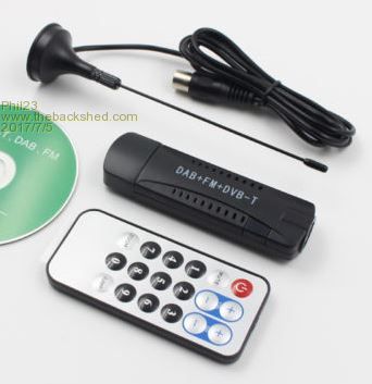

Cheap USB TV receiver dongle ;
Then this Software.
Gives me a cheap & dirty spectrum analyser.
A real one would be nicer, but a bit more than $15.00.
