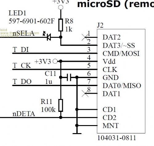

You can solve this in the hardware. Just add a LED which will be on when the /SEL line is low

Hm... that is interesting. Did you measure the voltage on the CS pin?
Have you tried to leave the resistor, but short the LED only and see what will happen? Then we can think a bit more... This is strange because I have used this method before and it worked just fine. But we must find the cause in your case.

Yes, with MM+... what is your LED?

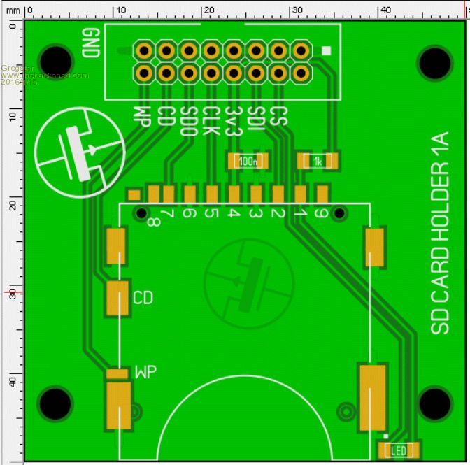

I'm using a 1206 SMD LED. I have removed the LED and the 1k pullup for now, but I will perform the following test:
1) Replace the LED and 1k with new ones
2) Reconnect to the MM+
3) Connect the CS line to a standard I/O pin
4) Set that pin low to hold the CS line low.
At this point, the LED should be lit, and I will measure the voltage on the CS pin on the SD-card socket with respect to ground.
EDIT: Here is a shot of my SD-card carrier. I note I have forgotten the 100k to deck you have on your design.... Would this be the cause?
Edited by Grogster 2016-01-16
kiiid
Joined: 11/05/2013
Posts: 671
Posted: 01:11am 15 Jan 2016
Leave the pullup in place, just shorten the LED. What is the result?
http://rittle.org
Posted: 01:14am 15 Jan 2016
Acknowledged - will do - stay tuned.
Also, I note your R11 is a pullup to CD2, not deck, so ignore what I said about that.

i'm pretty sure that pin 2 of J2 should be connected to the other side of the LED. that is, the -SEL output from the MX470 connects directly to pin 2 of J2, and an LED in series with a resistor (3k3 recommended) is connected between 3v3 and -SEL.
rob :-)
