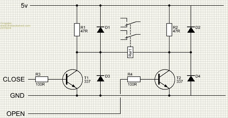

EDIT: How about this revision of the circuit?
All diodes are standard 1A type. I stole this concept from the internal schematic of just about all H-bridge motor driver IC's. Those diodes should clip anything one would think.
Thoughts?
Opinions?
Edited by Grogster 2015-02-05

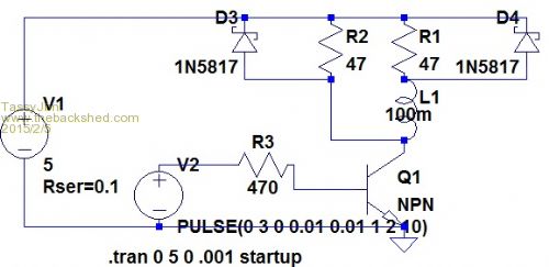

I did a spice simulation with 2 diodes. No idea what the inductance of the coil is so the actual spike size is irrelevant but two diodes (I used schottky diodes) did do the job.
Drawing the circuit this way makes it look like a conventional relay control.
For each direction, one diode is forward biased during the back emf period.
Both diodes are reverse biased during the time the transistor is 'on'
I would still like to do a real life test 'cos I don't trust my simulations that much.
Conclusion - the relays Grogster has should be OK to use.
