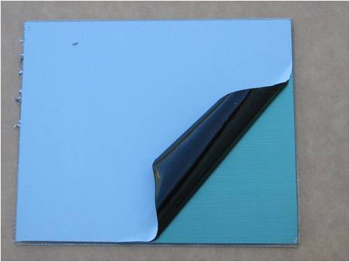

Positive resist pre-coated board is what’s used, and it gives good results for a not over expensive cost and is not difficult to work with.
One supplier is HERE I have never dealt with them, but the prices are about right and the product is a consistent quality. (Kinsten)
There is a lot of boards in a sheet 300x450mm and works out cheap per board.
I have only used this brand once or twice and it worked well. This sheet of double sided board is opened but not used. ( too hard ds.board)
The sheets of board in the background is what I use.

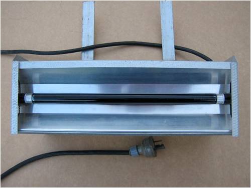

Sunlight exposure will also work and some fluros to at close proximity will work to some degree (if you can wait an half hour or more)
I used an old bug zapper uv fluro I had found in council road kill rubbish for a long time (15-20 min exposure)
Since trying UV leds have not used the zapper fluro again.

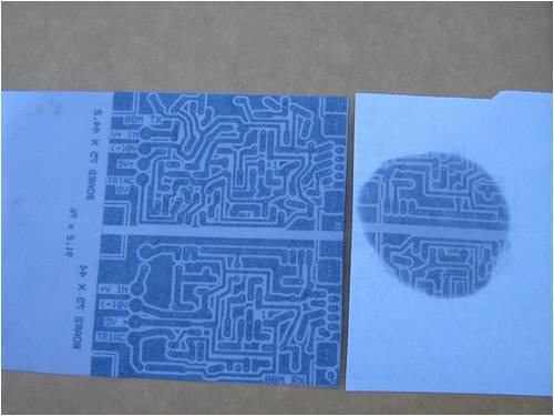

Prepare your circuit artwork on the computer and print it off onto plain white paper in a high quality setting for the printer. Print in black ink.
The image needs to be printed in a mirror image to what the copper view will end up to be. (back to front)
Most pcb design artwork packages will print the bottom side of a board (as used for single sided boards) in a mirror image as standard.
The reason for this is we need to place the ink side down onto the pcb for exposure.
With the black ink in contact with the uv sensitive film no light can reach that part of the uv coating and will not be exposed.
Cut the image from the paper sheet and sparingly apply a light coat of cooking oil (vegetable oil) over the Back side of the printed paper with a tissue. Rub it gently to get the oil to work into the paper. You will see the printed image appear quite clearly through the paper.

Remove the plastic film covering the board. This will expose the green uv sensitive film on the board.
Try to do this under low light levels and preferably with a incandescent light as this has no real UV light spectrum. (fluros do)

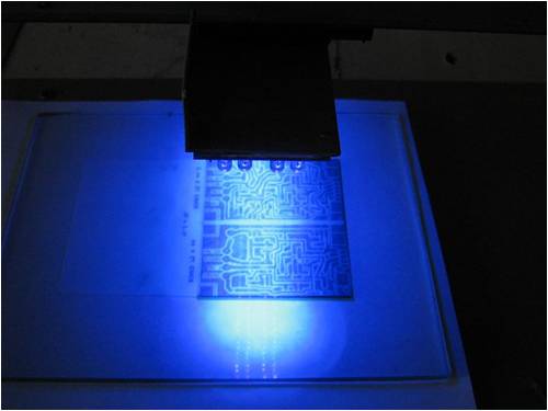

Start the uv light exposure.

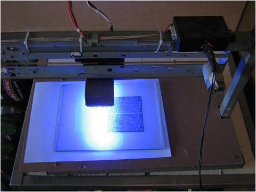

I find 10 passes (5 ups and backs) of the uv leds travelling at 300mm/min (slow) at a height of 100mm from the circuit board gives a good print.
If the leds are used stationary than exposure time is 10 times less, as the leds only cover a strip as they travel up and back along the board.
My uv light scanner was made from the carriage section gutted from an old inkjet printer and Uv led clusters. ( 2 rows of single leds work just as well)
It is important to have the leds start off the board and travel the length of the board and off the other end before they reverse and return, otherwise the ends where it stops and reverses will get double exposure and wont develop uniform.
Once the exposure is started, wait till its completed 10 passes and has switched itself off.

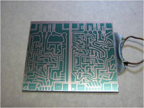

Remove the pcb and attach a piece of electrical tape to the backside of pcb with one end wrapped back around some plastic coated wire for a handle to hold/hang it from.
(Not such a good method for double sided boards. Works well on single sided.)
Place the pcb in the caustic solution and gently keep it moving in the solution.
The image will start to appear this may be quick or slow depending on the strength and the temperature of the caustic solution.
You will need to ensure all the green coating between the tracks has developed away as a light hard to see film remaining will make for a poor etch.
I find that a fine line along the edge on the artwork can give a good indication when over developing is happening, as this line will tend to be noticed to disappear first.
Rinse the board and inspect a few times during developing and you will soon see when it has developed fully.

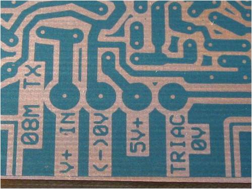

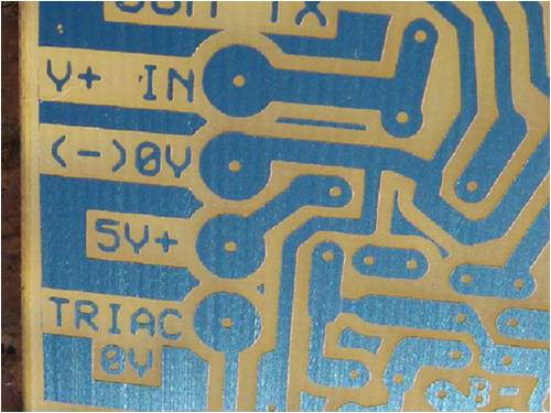

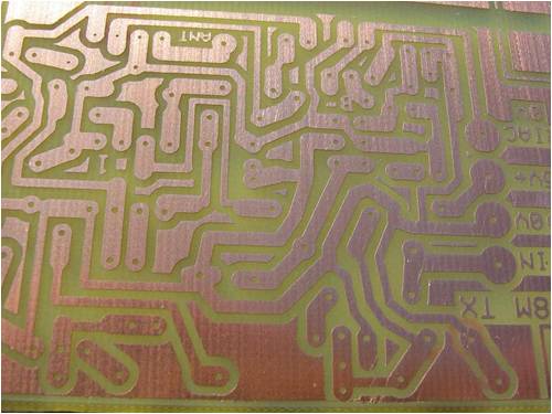

After developing the board should look something like this.
Check the board for any defects and correct them.
If you have a bridge between tracks then put a scratch in the green coating, as it will then etch there. If you need to repair a track, I find a CD marker pen works well.

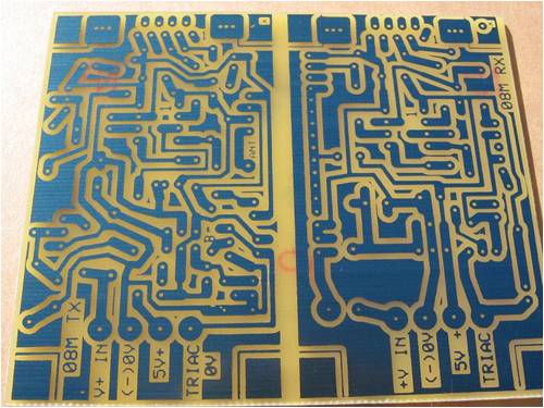

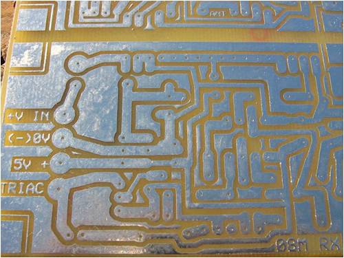

Next etch the board and afterwards it should look like this
It is easy to see the quality of detail that can be achieved
Once the board is etched the green protective film can be removed with methylated spirits on some paper towel.
The board cleaned off.

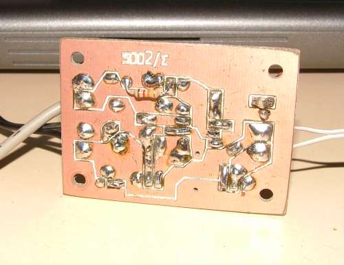

The board is tinned before drilling (or it plugs some of the holes up)
I tin my boards with a solder paste and use a electric heat gun.
After heating to melt the solder paste, the excess paste washes off in water leaving a thin solder layer behind over the copper areas.

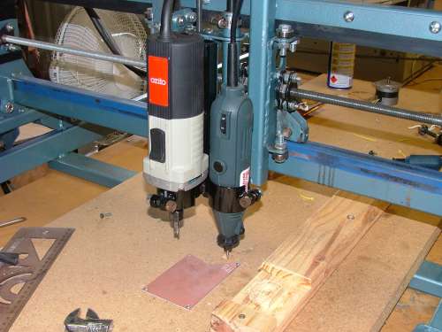

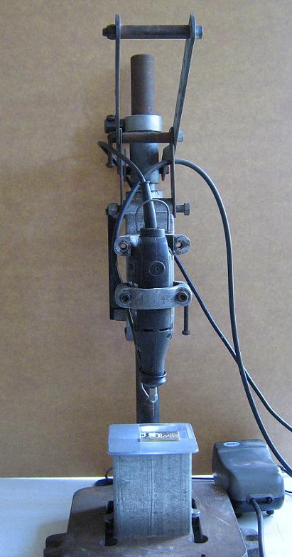

Old method used.

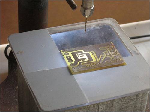

I had a dremel tool mounted in an old hand drill press I had found in council rubbish that served me well for many years.
A fish aquarium air pump was used to blow the dust away from each hole during drilling
The addition of a ultra bright white led in a under table position shining upwards makes it much easier to see the holes in the pads for drilling. One was mounted in a piece of steel tube with a acrylic clear top attached. Powered from a plug pac off a discarded nokia phone. (note the anti-glare tape. Bright little blighters)

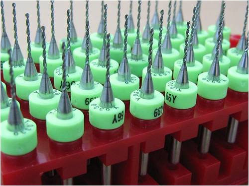

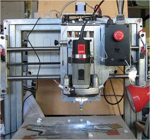

New method.
As I loathed the though of drilling another board and with eyesight deteriorating with age alone, and a desire not to have to drill little bloody holes, I built a small desk top cnc router out of junk to do the job for me. Best thing I ever did!!!!
Tungsten carbide 0.85mm drill bits.
Well worth the cost for how well they drill. They drill so clean and leave no burs around the holes.
Good life to if you don’t break them.
Drilling in process.

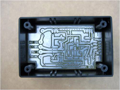

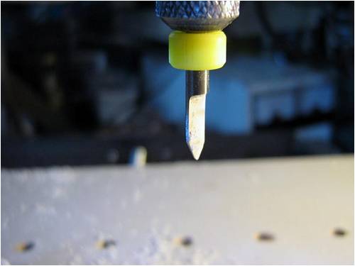

Once drilling is complete I route the board out to the shape required.
A rather well used, blunt looking pcb router bit
Check if all fits within the intended box. It did.

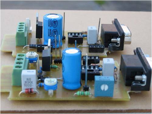

Board assembly

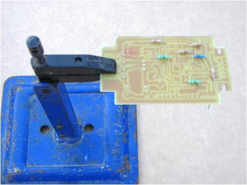

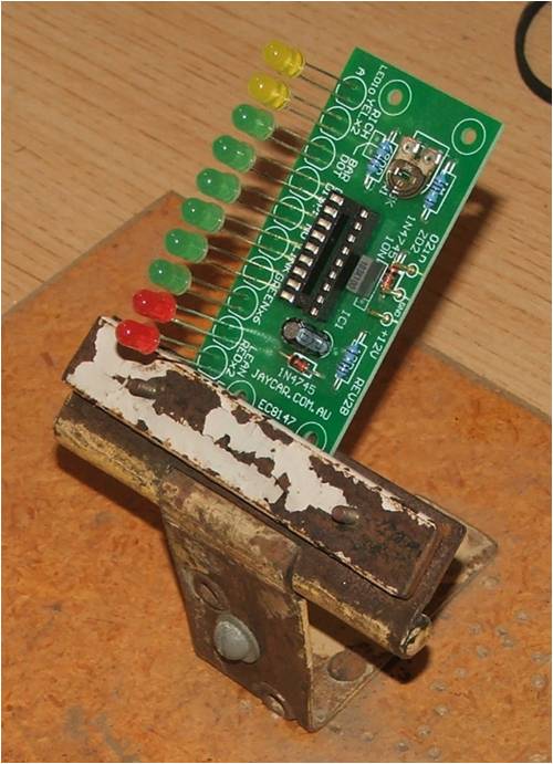

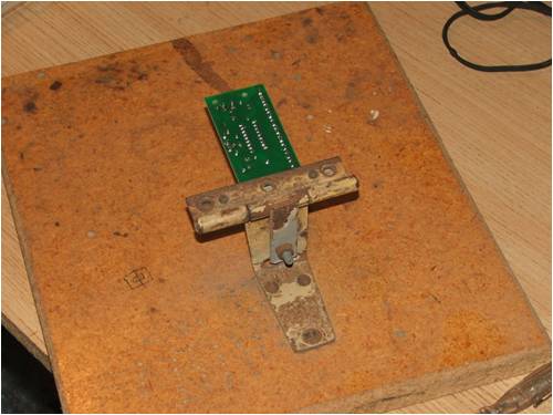

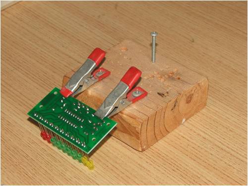

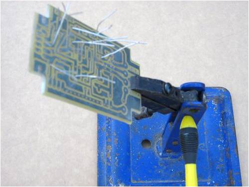

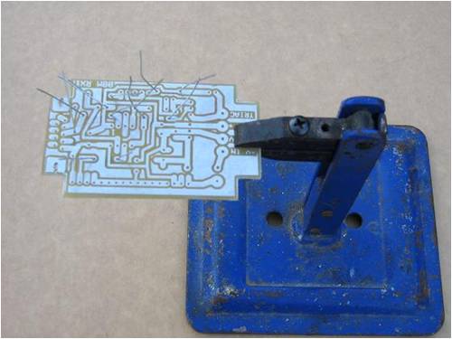

As you will all know, one of the awkward things about assembling a board is holding the little bugger while inserting components and soldering.
The little helping hands gator clips thingies are more than useless in my experience.
There had to be a better way!

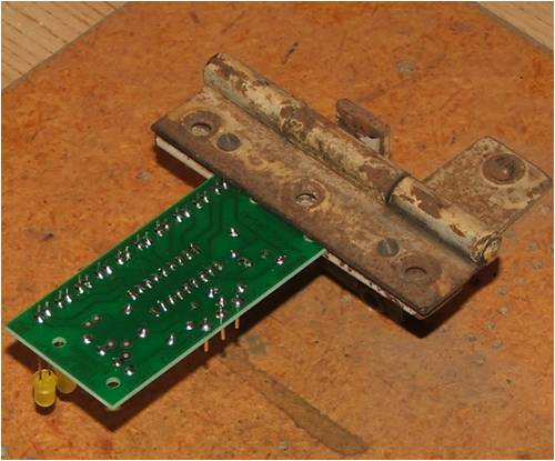

I fabricated a pivoting clamp that can flip over one way to insert the components and flip back the other way to solder thing in place.
It was another project that was well worth the effort and has given many years of service.
Have since made several for others and now include a edge around the base to form a tray, as when you unsolder a component for an alteration all those used little bits end up in the tray and ready to be reused again. (or at least found)

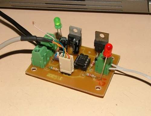

The finished boards
The whole process is a bit rough but it works for me and gives a workable board at the end for minimal effort and cost.
The process allows me to produce a reasonable board in less than an hour from printer to assembly and if doing several boards together than this time is reduced greatly per board.

Have you considered modifying an old flatbed scanner with an UV light source? Seems like an easy solution, with all the mechanical bits already present; just tap in to the board that drives the stepper motor and add your own pulses/signals to control the motor.

+1 on the carbide drills. Just don't use them when drilling by hand, they're guaranteed to break. Very hard and durable drills when drilling glass (FR4 board), but also very brittle.

Excellent article - well done! Your CNC drill looks great - I am sorely tempted to start building one but the F&P mill would never get finished!!
I was wondering if the carbide bits would work OK in a drill press or would they be to brittle - where do you buy them from?

I have thought about doing a How to make the uv scanner artical as well if there is any interest.
I did consider the flat bed option but would rather have the print on top as it is easier to align and to see it is all correct before exposure.

A tin paste is also available but when i bought the solder paste as a test i thought tin had a higher melting point, I was wrong it is a lower melting point.
The only drawback with tinning a board is you use a little more solder as it tends to wick out along the tracks a bit more, but solders much easier.

The drill bits i buy off eBay out of china for around $20.00 for 10.
If you search ebay for "Dremel bits" it should give a vast range of suppliers and lots of different sizes.
If i was only to buy one size than it would be 0.9mm as i find almost every thing will fit this size hole, including header pins and v-regs etc. snuggly.
If you have trouble finding them that ask again and i will track down the supplier i uses.
I have used them in the dremel press ok but you need high speed or they will screw into the board like a screw and snap off.
Did you notice in the photo the cuttings from the drill are like little squiggly worms and not so much the fine ground powder the normal bit produce.
I still use the normal bits to oversize a hole as they are more forgiving in a cordless drill and its normally only one or two holes a board anyway.

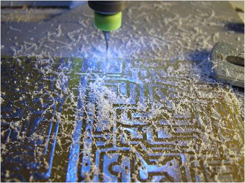

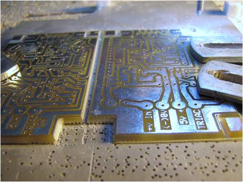

I've used my own CNC router to make a few small circuit boards, nothing fancy. Below is a test run.
And this is my PicAxe based pump controller. Its not pretty but it worked.

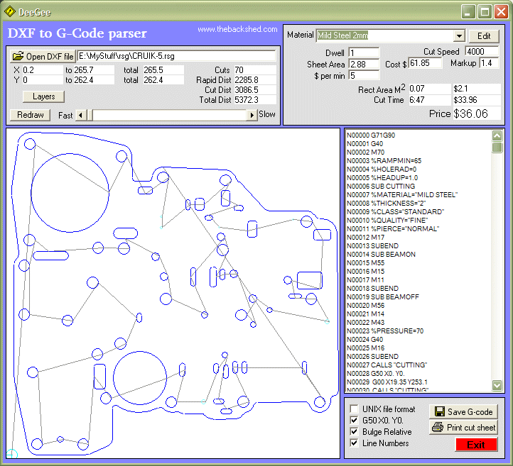

Gizmo if you would like a dos based program to decode the Expresspcb dxf file into a drill code (G-code) for use with a cnc machine to drill the pcb holes than let me know.
Pete.
Posts: 5200
Posted: 12:06pm 03 Nov 2009
  Quote  Gizmo if you would like a dos based program to decode the Expresspcb dxf file into a drill code (G-code) for use with a cnc machine to drill the pcb holes than let me know.
Actually, I have a windows based one I wrote a couple of years ago when I was working at a laser cutting business. It takes a DXF file and creates the G-code to suit. It has a library of materials, speed and costs, and gave a pretty close cost of the job, usefull for quoting. I also used it on my cnc router. I plan to put it on my cnc site when I get the time. Below is a screen shot. It would be good to get these utilities in one place.

Here are some pics of quick and easy board holders.
They are certainly not in the same class as Downwind's engineered masterpiece but still beat chasing a small board around the workbench.
The first is just a block of wood with one or more cheap mini spring clamps from the two dollar shop screwed to it -
This one was made from an old hinge about 30 years ago -
Thanks for the info too Pete - would like to see more details of your cnc machine.
Trev

As for mine being a masterpiece? not sure if i would put it that way. It works.
The cnc router is the second one i have built or i should say the first one mach2 as i had rebuilt the Y axis and Z axis on this one, hence the multi layer tubing frame.
I had the intension to rebuild the X axis (table) as well but not yet got to this, so Y & Z were adapted to the old frame on the X axis.
As the previous Y, Z was kicking about on the floor i built another X axis and reworked the bits off the previous Y,Z to make a complete cnc router for a good friend of mine, so he too can drill boards with ease.
There is a mass amount of work in making one and you wont get much change out of $500.00 by the time you buy the few bits and pieces you need.
I looked at buying a bought one and prices started at around $5000.00 and jumpped to $50,000.00 real quick.
I could not justafie the cost for my needs so thought i would have a go at making one.
It felt like a never ending project but i got there.
The first run around with a broken drill bit and a paper print out of a circuit, that i could press indents into the paper and not punch through it in all the pads gave me a smile bigger than the grand canyon.
I looked at building the motor driver board, but by the time i added up all the driver chips and other components it was about the same price as a complete 4 axis board out of China for $100.00 so i took that option.
I use Mach3 as the cnc software and only have the free demo version. This will only allow me to go to 500 lines of code which is very limiting to the work you can do, as a circle cut could be 2000 lines on its own.
There is always a way to cheat this but a pain in the butt just the same.
I will try to find some time on the weekend to take some photos and put a short discription together.
It is far from a work of art as i made use of what scrap (better said without the S )i could find to do the job.
I do intend to build another one with all the good bits in it, so i can machine down to 0.01mm as at present i can get around 0.1mm accuracy or better.

Do the toy pcb drill have a collet insert for the bit to fit into.
A friend had one and found the collet fitted nicely into the low priced Super cheap auto's rotary tool (dremel rip off) as these take a slightly bigger collet than the dremel brand.
Dremel is good and i have had 2 in 30 years but would buy the cheaper made ones now if the collet can be got to fit the drills.
The carbide drills are not a problem its the normal drills i mean.
$40.00 for the cheap'os and $140.00 for dremel
El-cheapos life might be shorter but not by 4 times less. and they come with a flex shaft.
Pete.

There are 5 different size collets in the toy drill Pete.
I did not consider the cheaper rotary tool at Mitre 10 because I assumed it would also have too much slop in the bearing and I would be no better off.
The Dremmel I looked at did not come with the flexible shaft and was $99 with a selection of accessories. Up till now I've always considered them a bit 'Mickey Mouse' and overpriced - after all, why would anyone muck around trying to remove metal with one of their dinky little grinders when you could lay into it with a decent angle grinder and get the job done quickly!!
I'm not sure if the flex would be of much use - what are your thoughts?

I only bought a flex shaft for my dremel a few months back as found one real cheap and never thought i had a use for one before. I do find it handy for the odd thing like cutting out the box to mount a plug through and things like that but optional.
The other cnc router i made runs a super cheap autos brand tool on it (was on special for $20.00 at the time) and has little run out when routing and i think it is better than my dremel in that area, but mine is many years old and done a mass amount of work.
I did replaced the bearings in mine resently even though you are not ment to be able to, and buy a new shaft instead, but tool is to old to get a new shaft.
I still had run out so shimmed the bearings in the plastic housing and it made a world of difference.
Mine has a 2 piece shaft and a bad design as it allows movement between the two. This has been changed in the later models to a 1 piece internal shaft.
I would take the collets from the toy drill with me and the tool they fit into is the one i would buy.
It is very difficult to get the collets with a small hole for the drill bits and you already have them.
I find the little chucks that come with the dremels useless as they dont centre worth crap on fine drills an wobble to much.
If you run one of these tools on a cnc router it gets a lot of sideways thrust applied to the bearings and they are not designed to take that sort of load being a hand tool, thats why i bought the el-cheapo ozito router rather than stuff up a $100.00 handy tool.
I cut down a flex shaft from a el-cheapo rotary tool to make the adaptor for in the ozito to take the 3mm shaft cutters and drills i use.
I think you will find a range in the dremels and the $99.00 ones is in the lower watts range and the lesser quality one as when i looked last i needed to spend $150.00 or more to get something a bit more robust in the range.
Dont get lead by all the free cutters and grinding stones some kits have, it might look like a good deal but really they are useless crap you will more than likely never use much if at all.
A few good cutters that cost a bit is worth having and you will do more with them than all that other junk put together.
So conclusion buy what your heart tells you more so than me. If it was me i would buy a tool the collets fitted and was cheap with minimal slop in the shaft and bearings, then spend those dollars saved on a few good cutters of different styles.
When the tool dies in time buy another cheap one and you may still have the good cutters from the beguining.
The only reason i have a dremel is it was about the only one on the market back then. Now the range is large and a fraction of the price i paid.
Hope this helps.
Pete.
Ps. they are a great tool for electronic tinkering and small hobby activities with a zillion uses but no i would not use it in the welding shop or carve a canoe with one.
