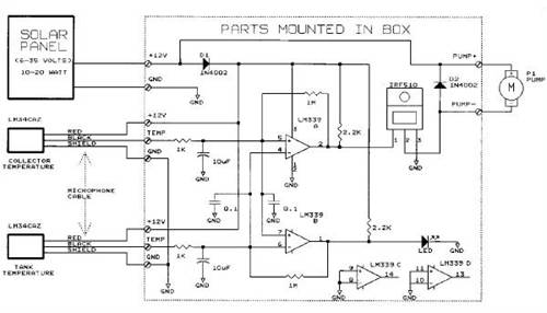

i,m way out of my debth here but would some type of feedback on the op amps help trigger the change over points ? i read somewhere that if the change in voltage is very slow in happening an op amp can get a little lazy ..
this is kind of similar (not to your specs though) off the web .. it trips in and out a pump for a solar panel (dodgy pic quality )
some de- coupling caps maybe might help the inputs Edited by niall1 2009-05-18
