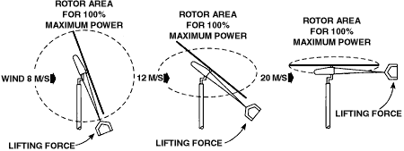

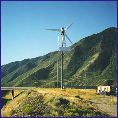

A company in Hong Kong made a range of wind turbines with furling over the top rather than to the side. The company seems to be gone now and all I have from them is a few pictures of how their wind turbines looked.
In one of these pictures you can see its size in comparison to a small building and vehicle.
I do have videos of these machines running on an old PC.
If you want a more detailed description of their turbine I can post that, it has been some years since I spoke with the manufacturer and I never forget tech info, faces maybe, but never tech food :)
I also have pictures of tail only furling where the tail is pivoted around the tail boom. It is a US design and rarely seen in the wild.

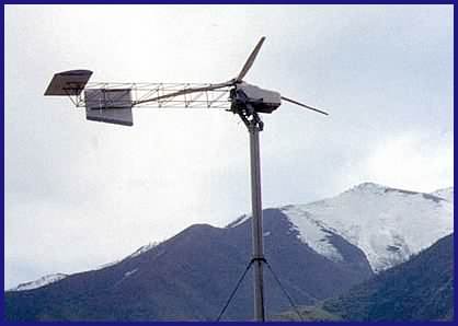

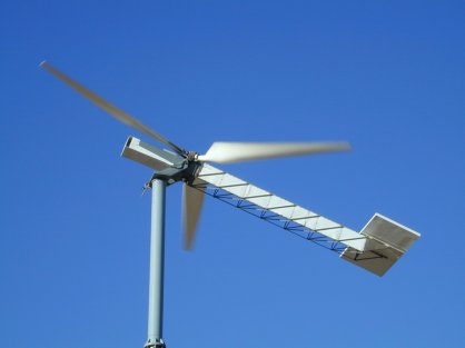

This lot use a similar system.
Soma

The machines pictured, tilt their blades up, forward and into the wind, not back. My own machines are down wind and work with the wind at all times and do not have the burden of high stress levels as with side and overhead furling.
If the machine furls to the side or overhead, both will do what you stated, there is no way to stop the gyroscopic effect once you have designed it in. Any change in wind direction with an upwind machine will have the gyroscopic forces transferred into the tower and it will impart a circular motion on the tower when viewed from top down.
A down wind machine where the blades never fight against the wind has major advantages and reducing swept area when it is needed most is worth it to me where our winter winds reach 80MPH each year and the odd few hours to 100MPH.
